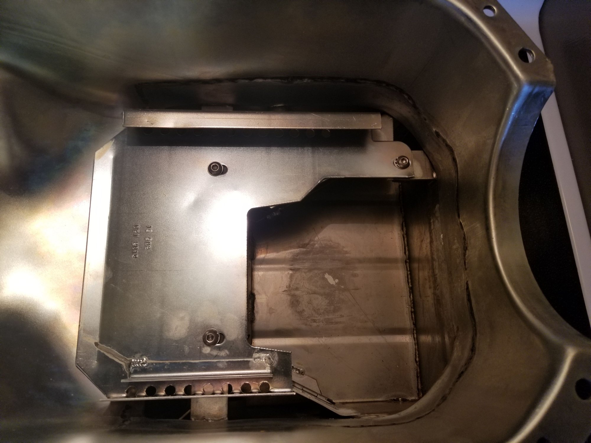

Ive used the anodized one before..it fit good , they are the big block style pan with the factory style baffle.
identical to the milodon/moroso street strip style basic big sump pan.
I have one here going on a customer’s engine..I can post pics of the inside sump if you want

This would be very nice. Thank you a lot

Pan and the matching pump pickup. Speedmaster

Thank you for the pictures.

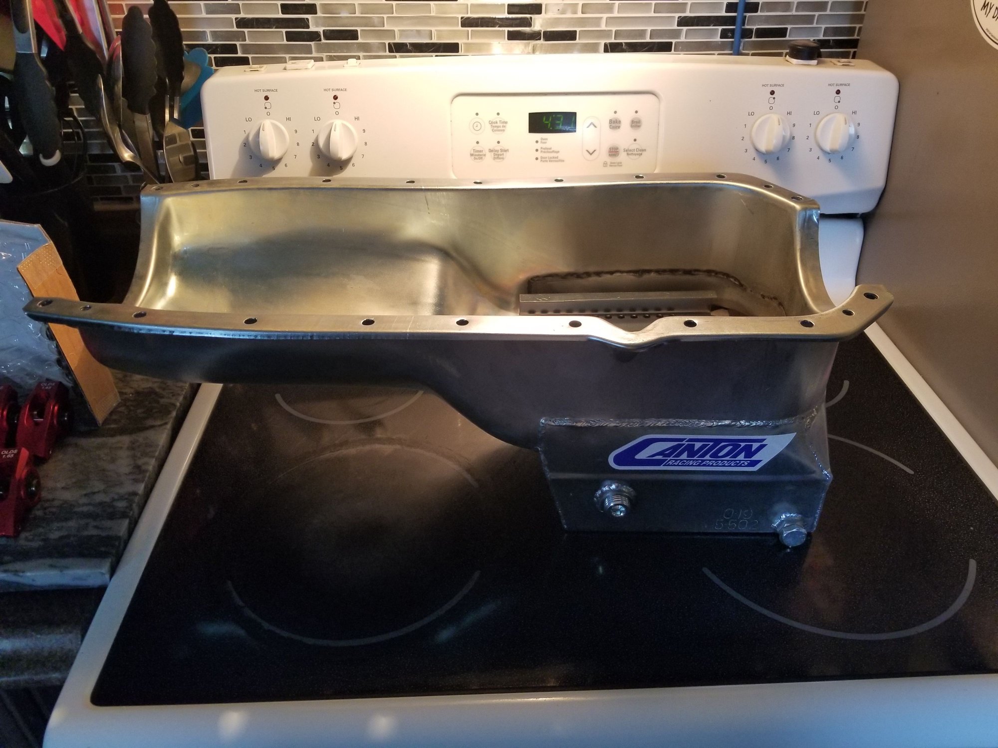

That pan looks pretty good for the price. There is also the Thornton pan. Mark got me a Canton pan and pick up not very long ago. There is a swinging side baffle as well. It is a 6 quart pan, really nice.

Be careful on the depth. The sump can hang below the crossmember.
The Milodon 7 quart pan sits level with the crossmember.

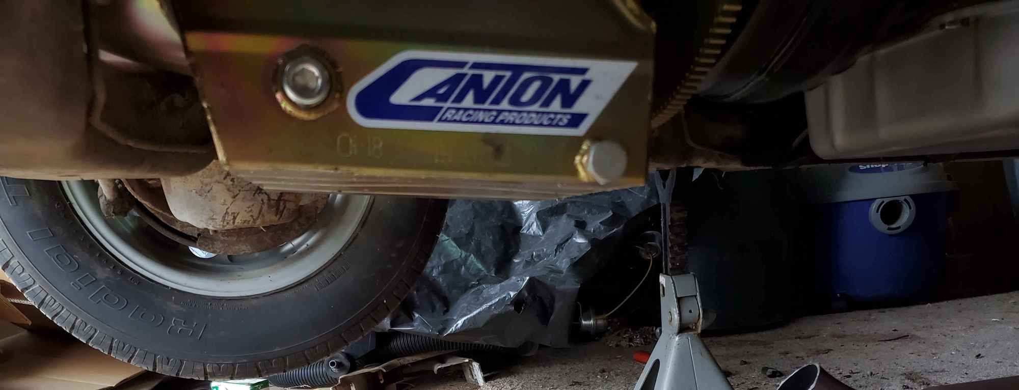

This is the Canton on a 350 block in a 67 Cutlass with new motor mounts. It is a bit lower than the front crossmember but I figure if I manage to drag it on something, I shouldn't have been there. I do my offroading in my 4X4. Those headers are for a BB Olds so that is why they hang down so far.

Good to see and what I figured. My aluminum trans with be the lowest point on my 70S.

Do you suggest not going with CFR performance then per the link above/picture below? I agree not to be cheap when it comes to oiling but wasn't sure if CFR is considered good or bad (but $102 + shipping is cheap compared to other pans). Thanks!
