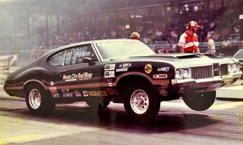

Cast pistons were used in NHRA stock for years with 455 Oldsmobiles and ran 11s with stock production heads, so it can be done. But, in the present we have much better, lighter pistons, stronger pistons. Spend your money on good pistons, I ran 11s in less than ideal conditions in the eighties with stock pistons, filled heat cross over, welded exhaust divider, .474 lift hyd Lunati cam, zero bearing problems. STD bore, STD crank, I did have Mondello restrictors in there, stock oil pump, Toro pan, C4B intake 850 Holley. 1970 Toro engine core, very cost effective! Example of an Olds NHRA stocker.
