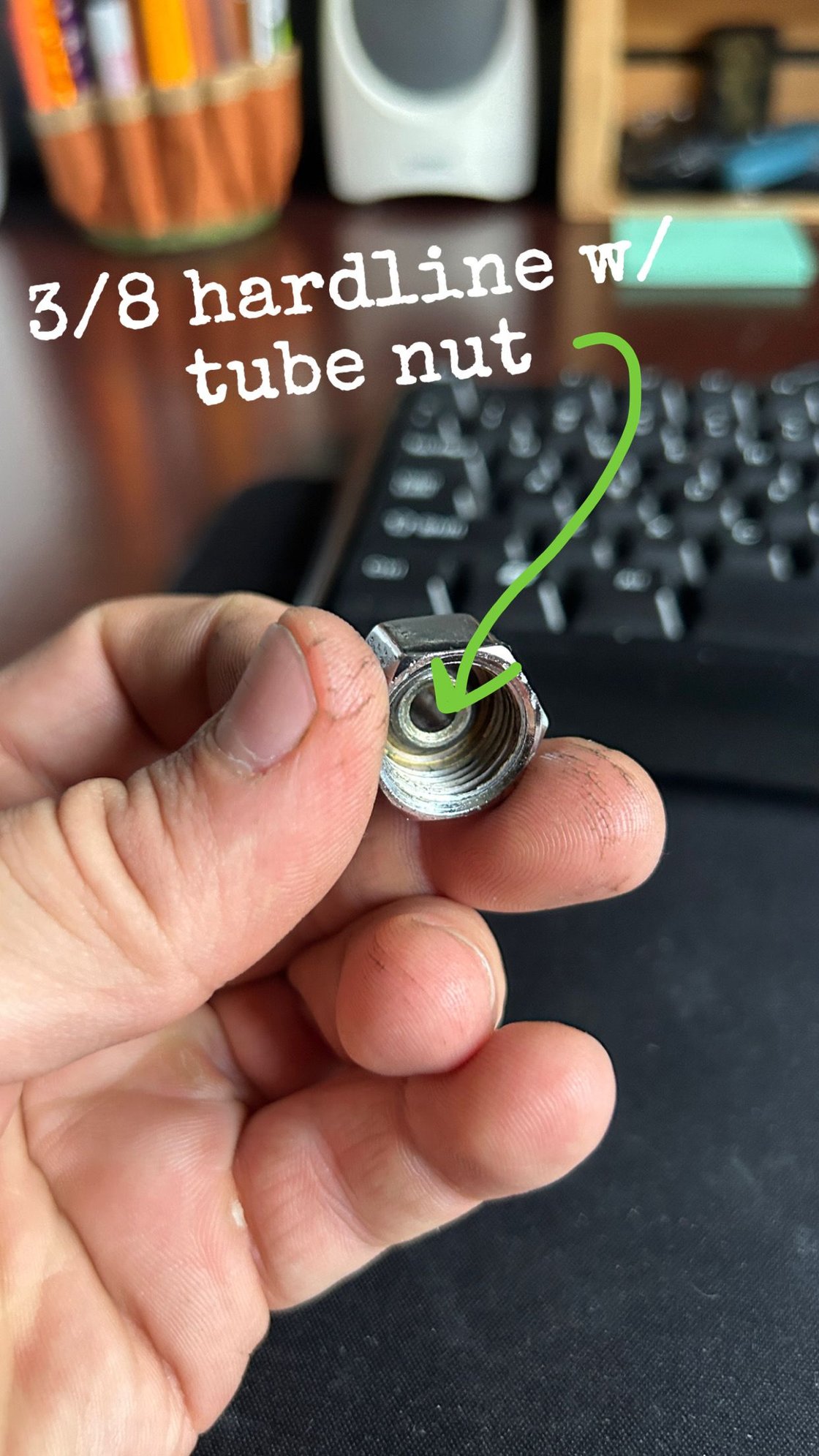

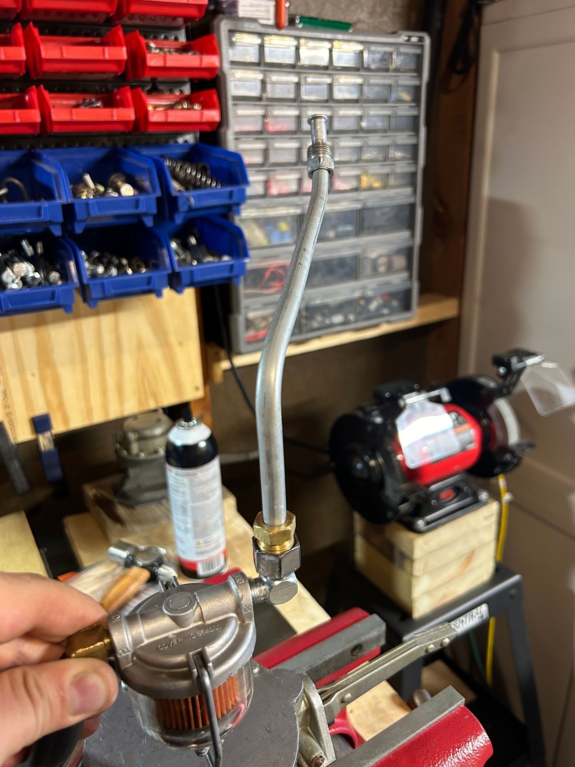

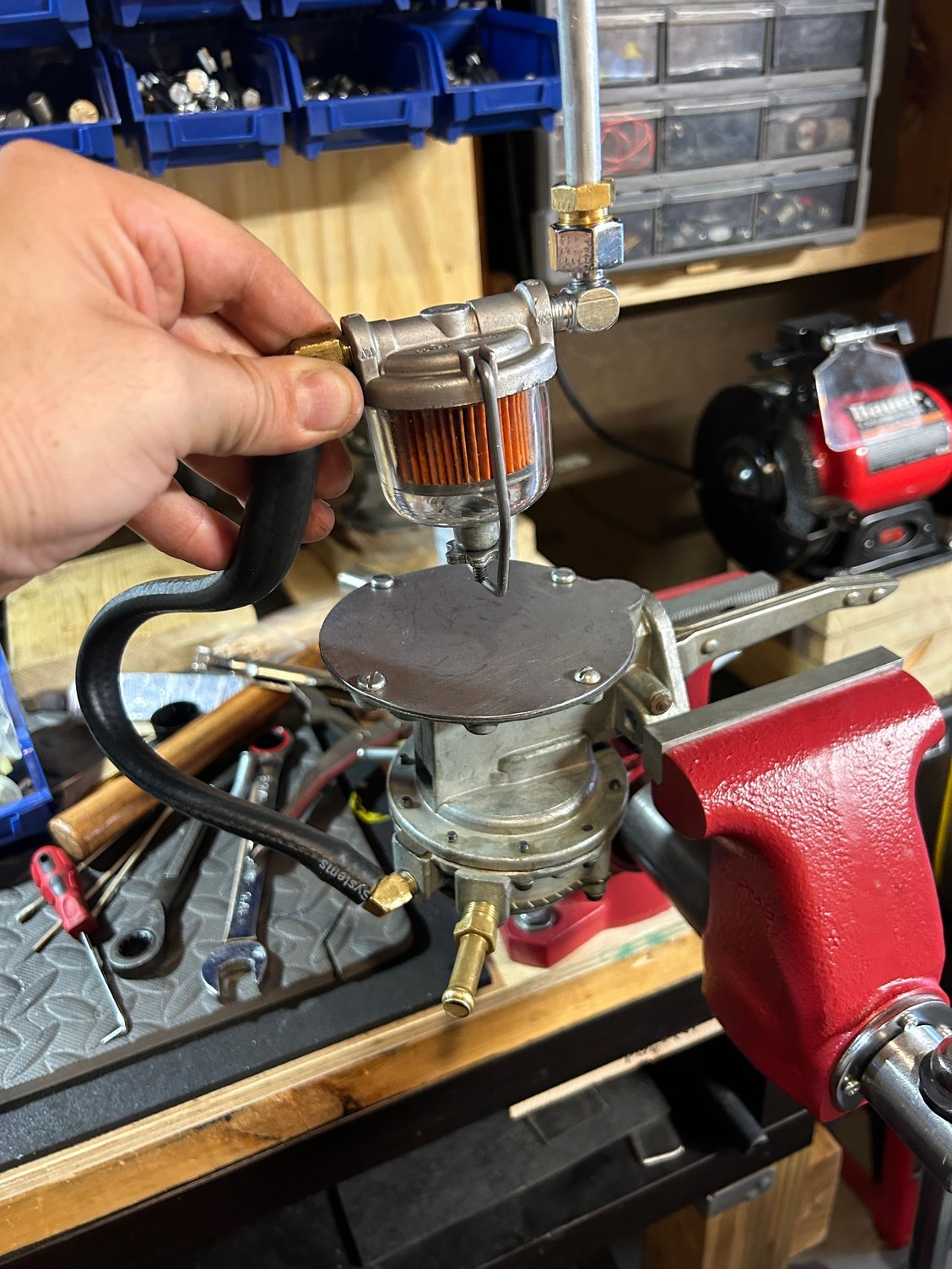

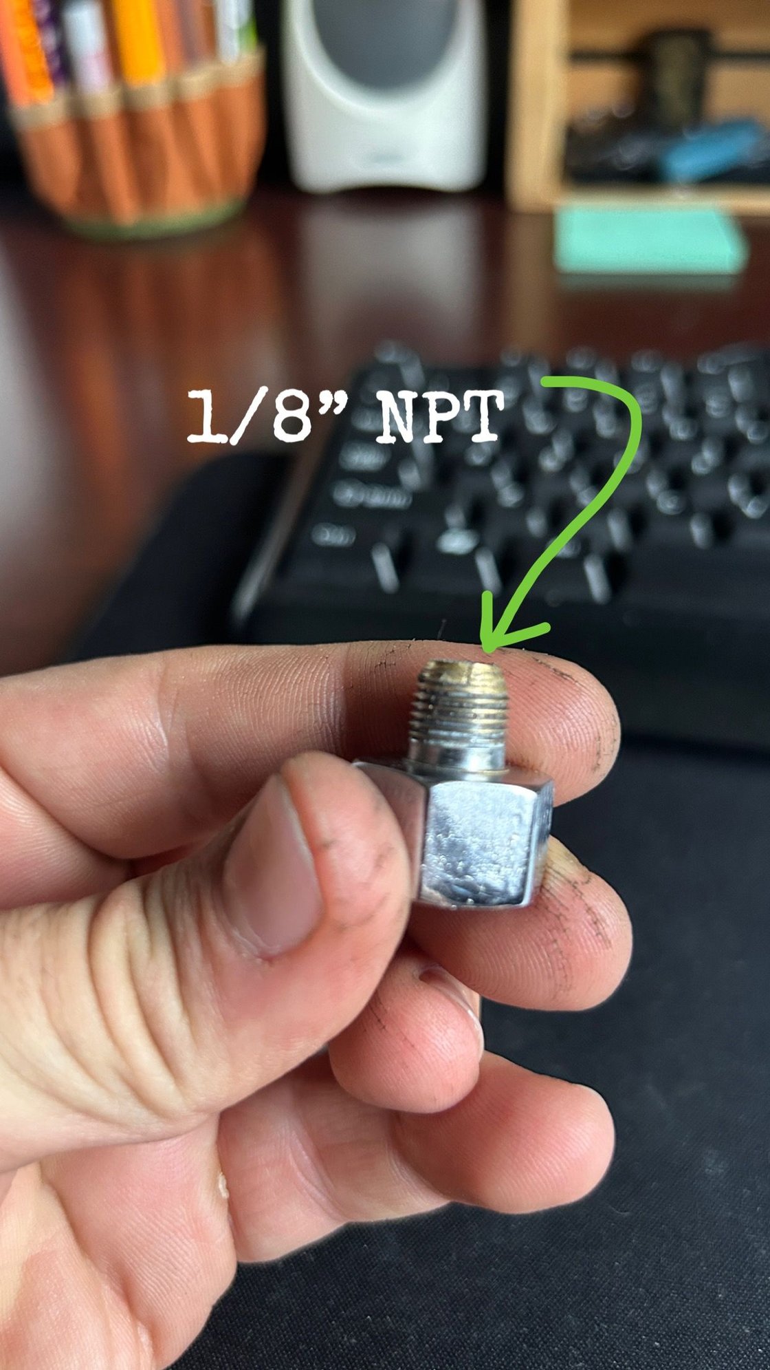

I tried the tightening method, with no success. I think I will need to start fresh, which is ok by me. But I do have a question and need input. Instead of chasing for the correct reducing fittings, could I use rubber hose from fuel pump to the fuel filter? And then of course use hard line from the 'out' of the filter to the carb. Here are some pics. The rubber hose would be much shorter, obviously. I would rig something up to secure the filter to the block, or nearby area. Thoughts? Stick with hard line throughout? (Finding the least amount of reducing fittings for 3/8 hard line to 1/8 MNPT is a bear. Carb inlet is 1/8" and both inlet and outlet of fuel filter is 1/8")
Old Jul 20, 2024 | 05:25 PM
Sugar Bear's Avatar
Posts: 4,098
Some will agree, some will not. I prefer all hard-line on the pressure side of the pump, no rubber hose.

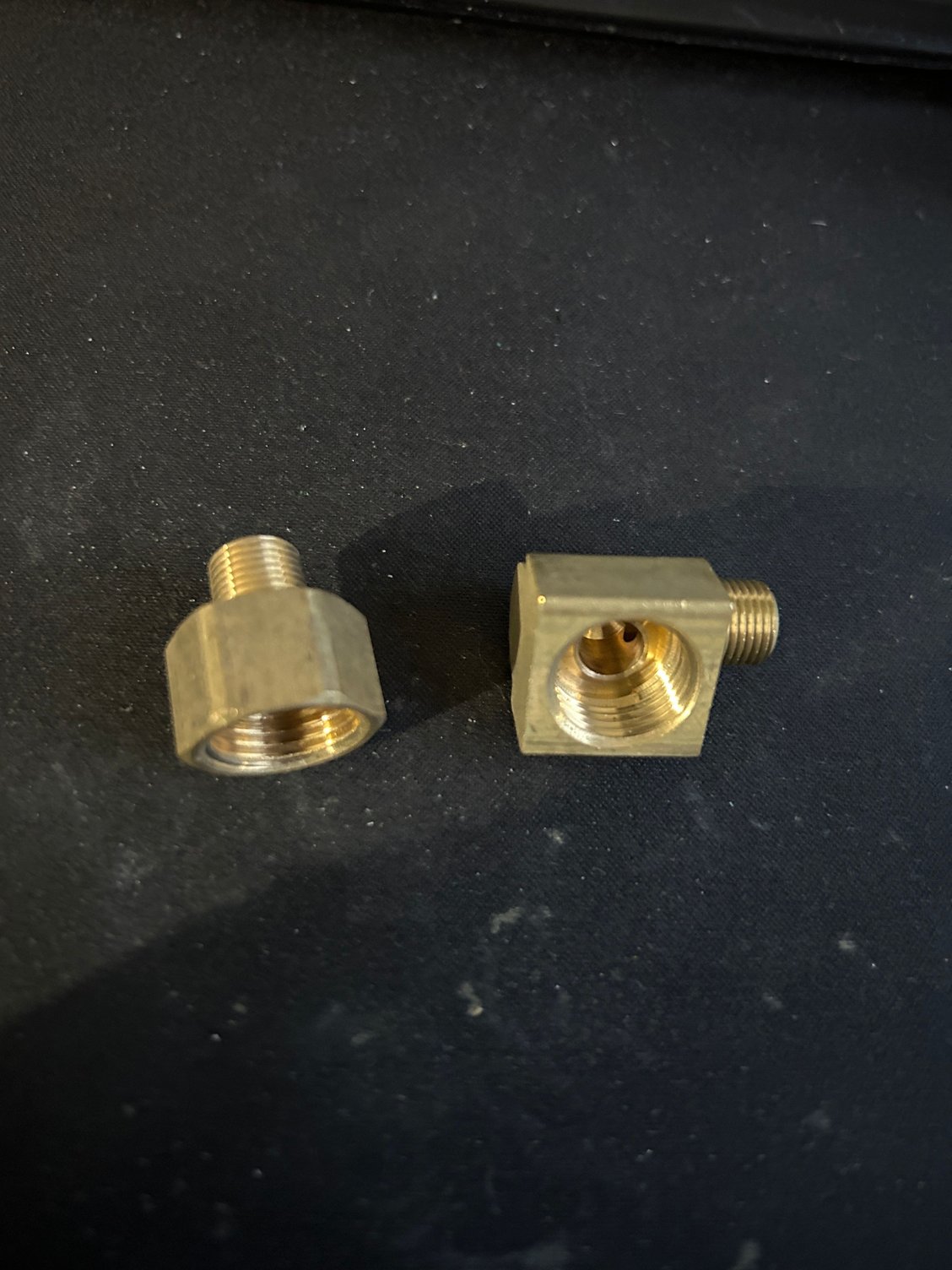

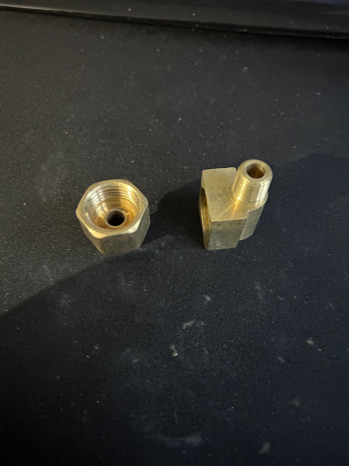

Bending that hard line sure is a son-of-a, but I have done it before. The trick is finding the proper reducing fittings for my application here. Summit doesn't have them, but I found Advance Auto may have what I'm looking for. Here are 2 pics.
The steel line would be double flared.
This end would thread into the carb inlet fitting.

Here's an update: I actually found the fittings I needed at a local parts store. They were discontinued according to their system. I have been looking for these for a while, so I grabbed several. This will allow for minimal fittings and will allow me to go back to hardline all the way.
EXACTLY what I needed. Unreal. Hard to find these adapters apparently.
