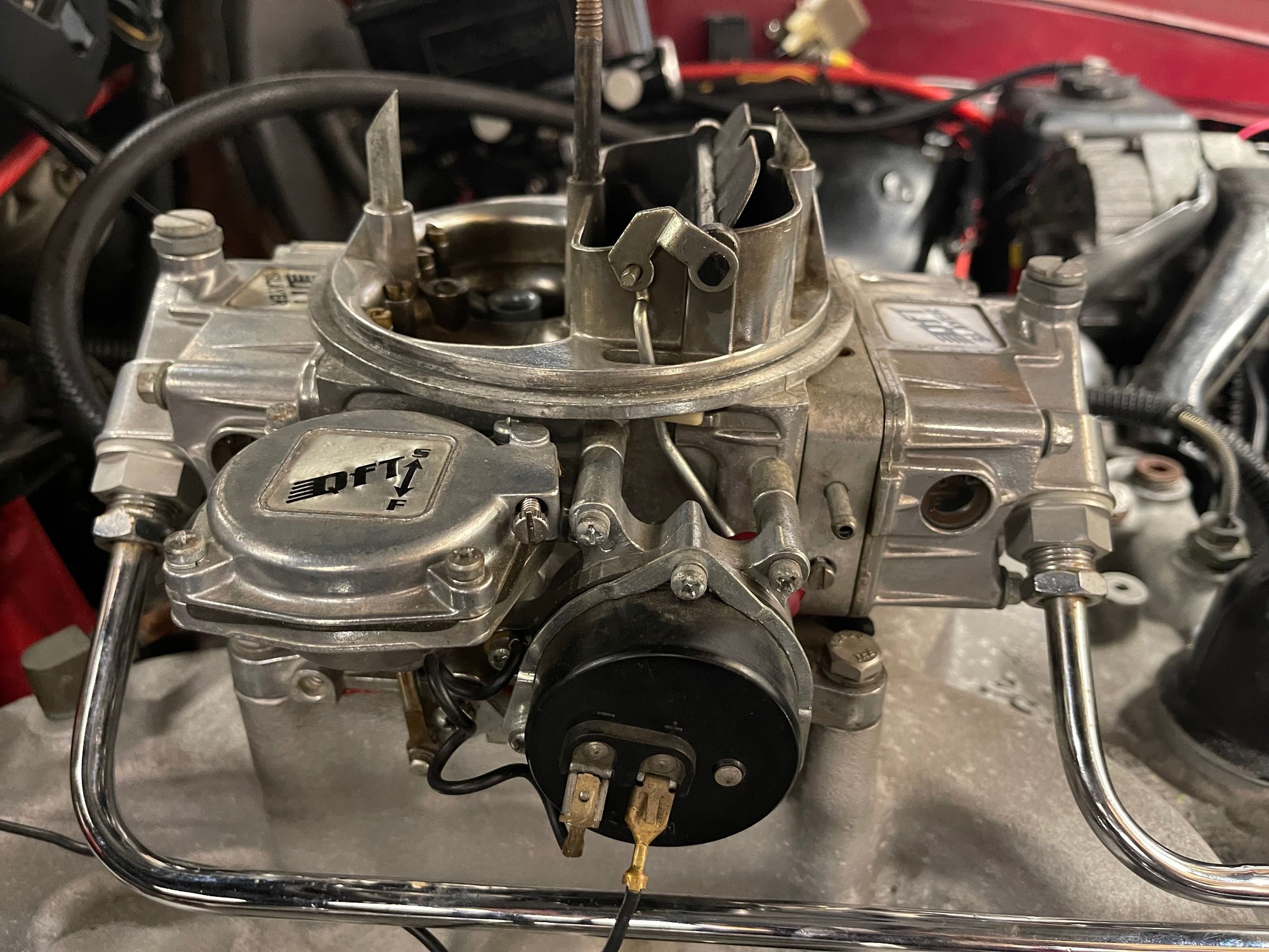

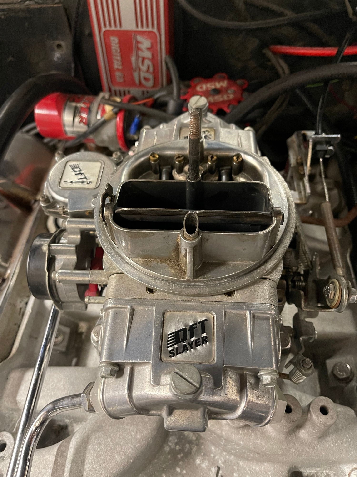

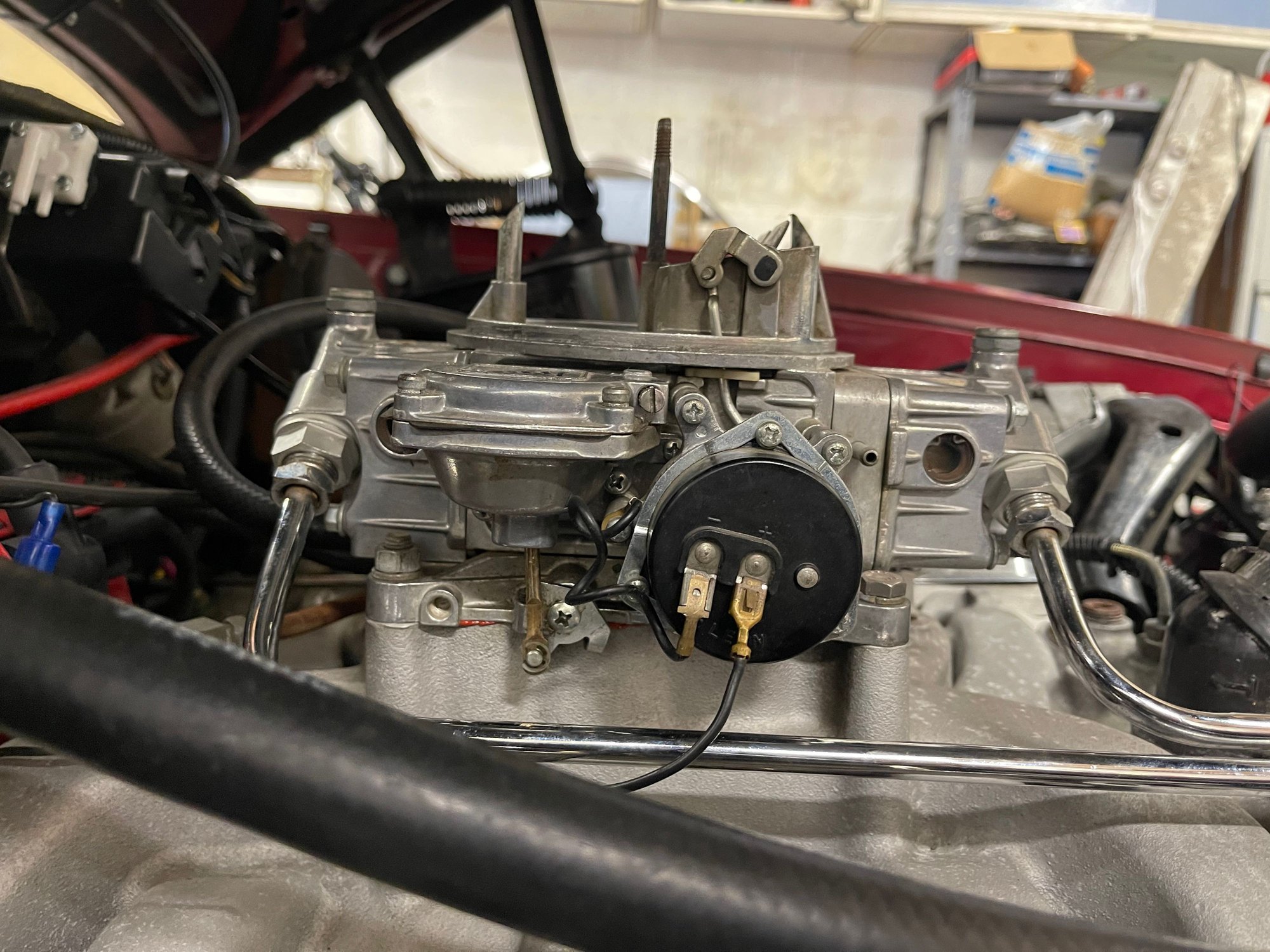

Hi all
I'm running a 60's 400 with Edlebrock performer heads and inlet manifold, I have been told it has had a cam change but could not confirm this as I havent done any of engine work, the existing QFT Slayer carb is leaking lots, she wont idle at all and there are no numbers on it whatsoever to try and I.D it for a rebuild kit. So it looks like I'm in the market for a new carb, any advice on what to go for would be greatly appreciated?

Why not just contact Holley and ask them ?????? The Slayer just looks like your typical Holley with center hung floats so like Mark said any kit for that type carb "should" work. Is yours vacuum secondary ?

Post a picture of your carb. That will determine for sure which kit you need. Just noticed you location so its probably kind of hard to call Holley

3-200qft

Here's a link to the kit Cutlassefi mentioned.
https://www.summitracing.com/parts/qft-3-200qft
