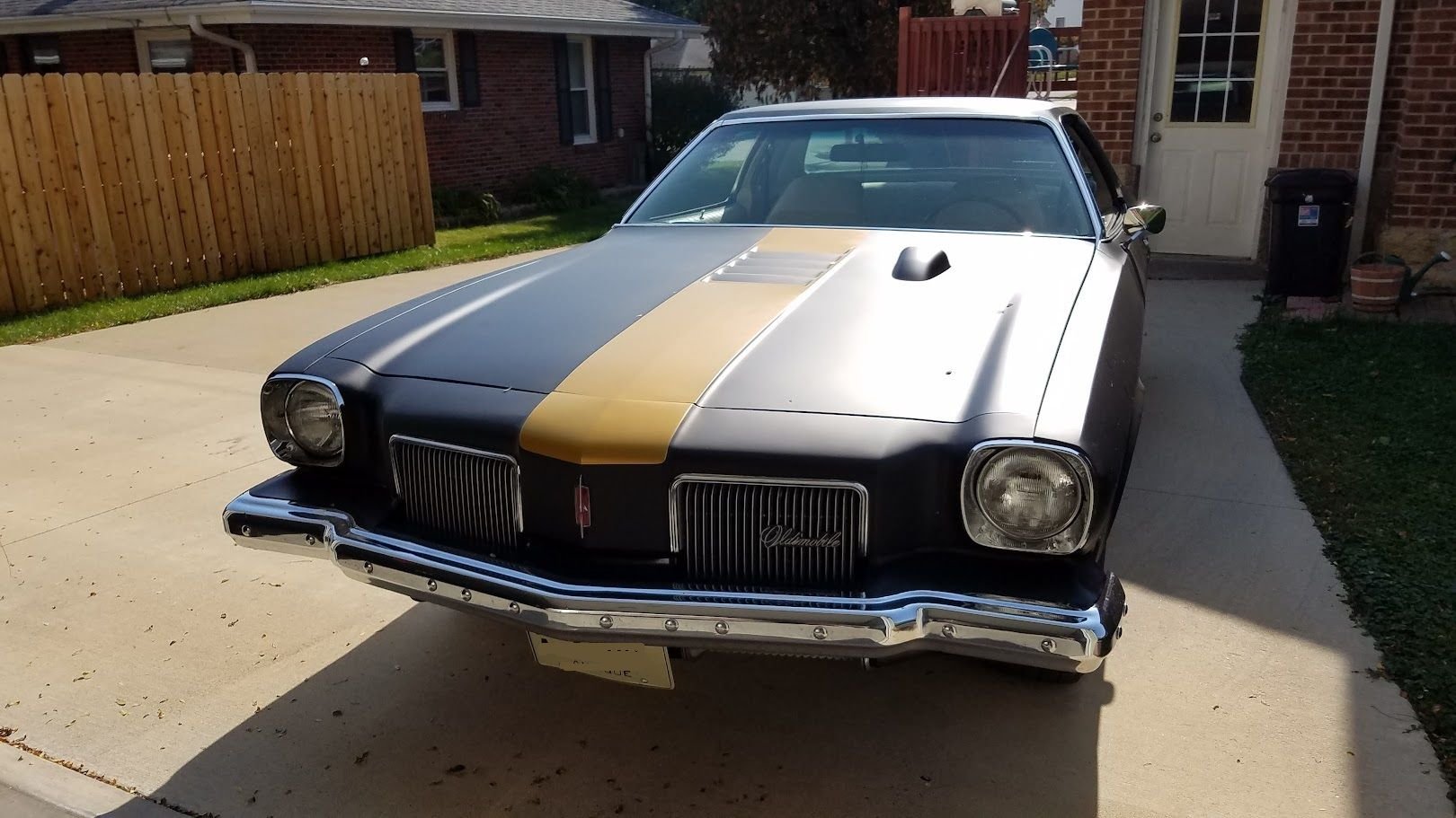

Camshaft for 425 in 73 Cutlass Supreme
I've got a 73 Cutlass Supreme with a 3.42:1 posi rear end.
The engine is a rebuilt 1967 425 from a Delta 88, it has 10.25:1 compression, an Edelbrock Torker intake, an Edelbrock Performer carb, Edelbrock aluminum heads, headers, and a Mondello JM 22-25-10 camshaft.
The engine setup works, but I think I went too aggressive on the cam and intake for casual street use and cruising.
I'm thinking of changing to a Performer intake and a milder cam and would welcome any recommendations.
