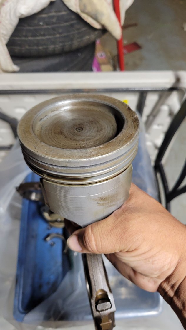

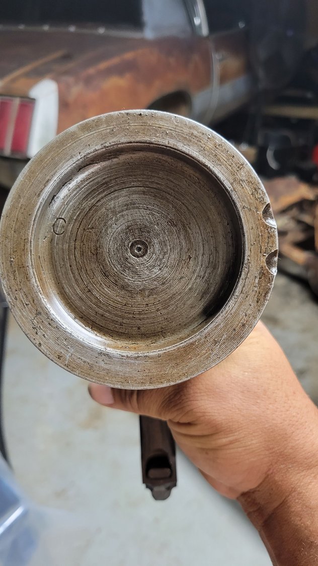

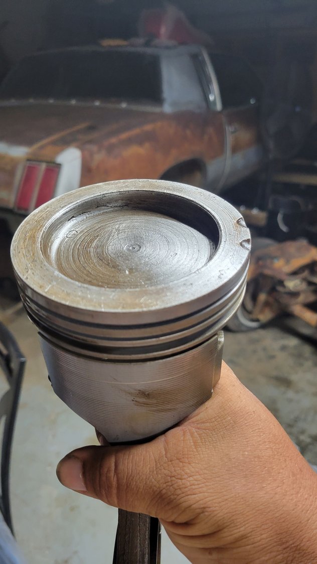

You should first make sure what pistons the engine has before assuming it’s a 73. E heads came on 1970 engines so if the heads were original to the engine, it’s a much higher compression than a 73
post a pic of the piston tops…we’ll tell you what you have
then you can decide on a cam.

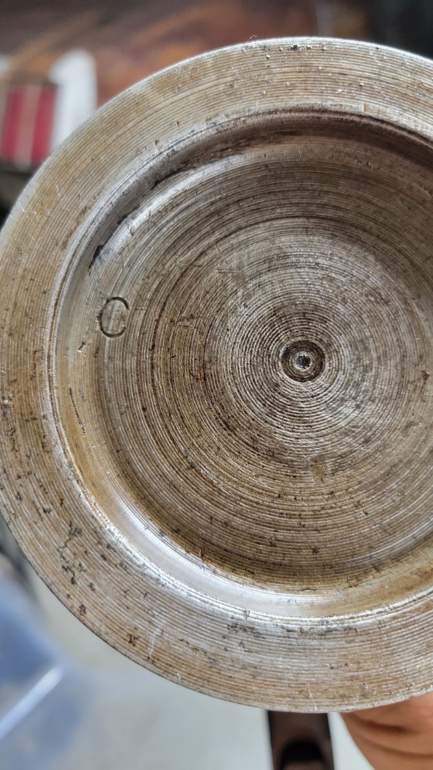

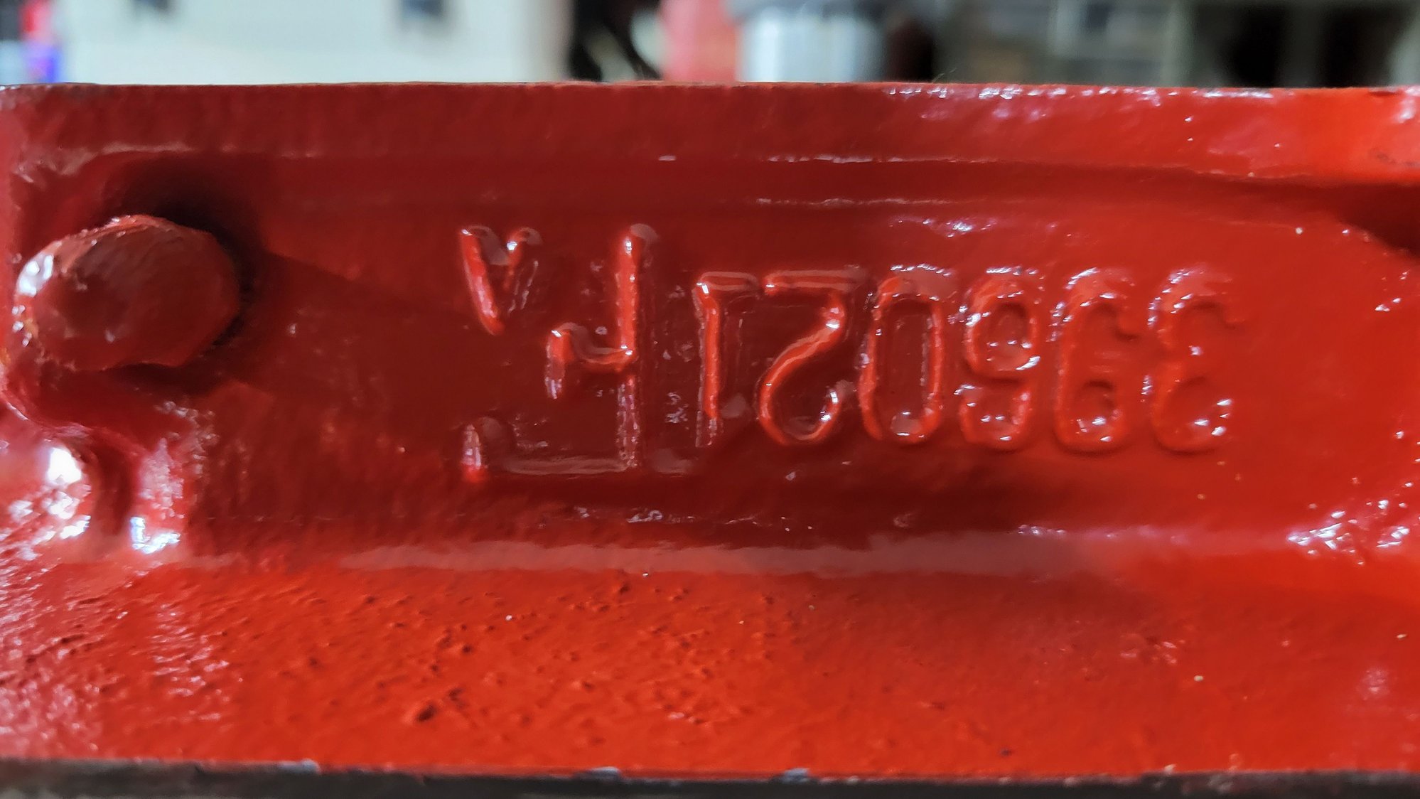

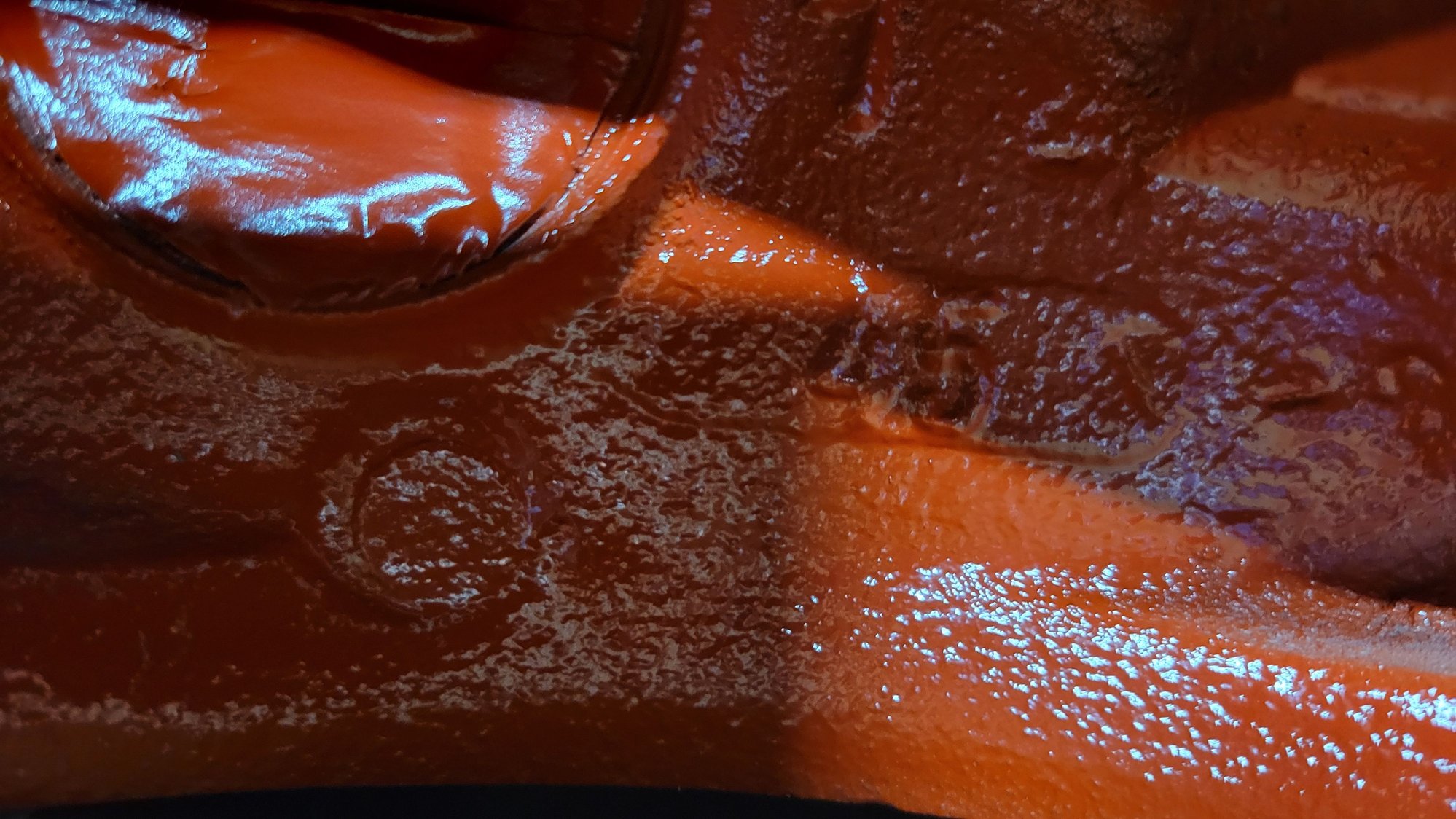

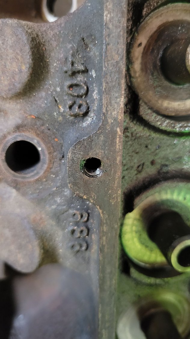

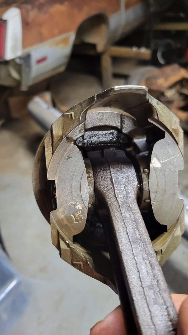

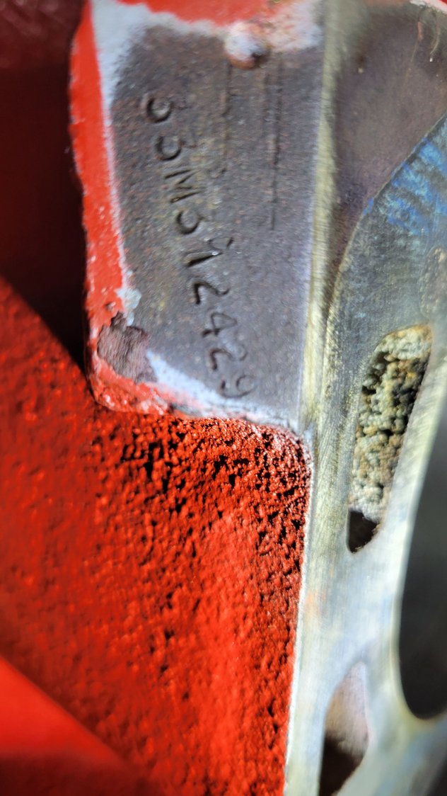

Canadianolds my friend how are your today thanks for your interest in helping I greatly appreciate it . Here are some block piks of block ID tab on driver side under head location, on top of block behind timing cover and back of block beside distributor. The head ID numbers. And some piks of the piston it has a C on top and an F on the bottom not sure if them letters mean anything. O and one more thing that has me thinking I f**cked up , I've ordered two sets of piston rings, reason being is the first set the top ring took a .26 filler gauge and second ring took like .28 filler gauge when I checked them in the bores . ( three randomly chosen) so I thought I had the wrong rings second set same thing . What's going on ?

Definitely a low compression factory piston.
What rear gears and transmission/ TQ converter does the G body have that its going in?
