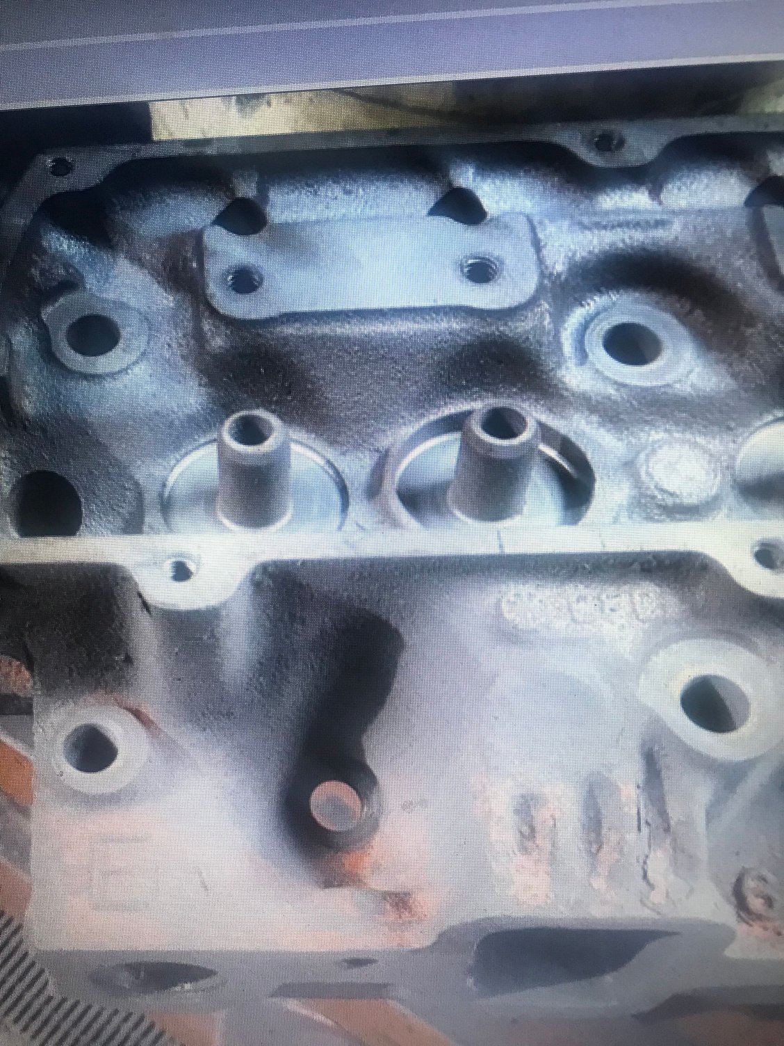

E heads came both ways, with or without rotators. Post a pic of the valve spring pocket

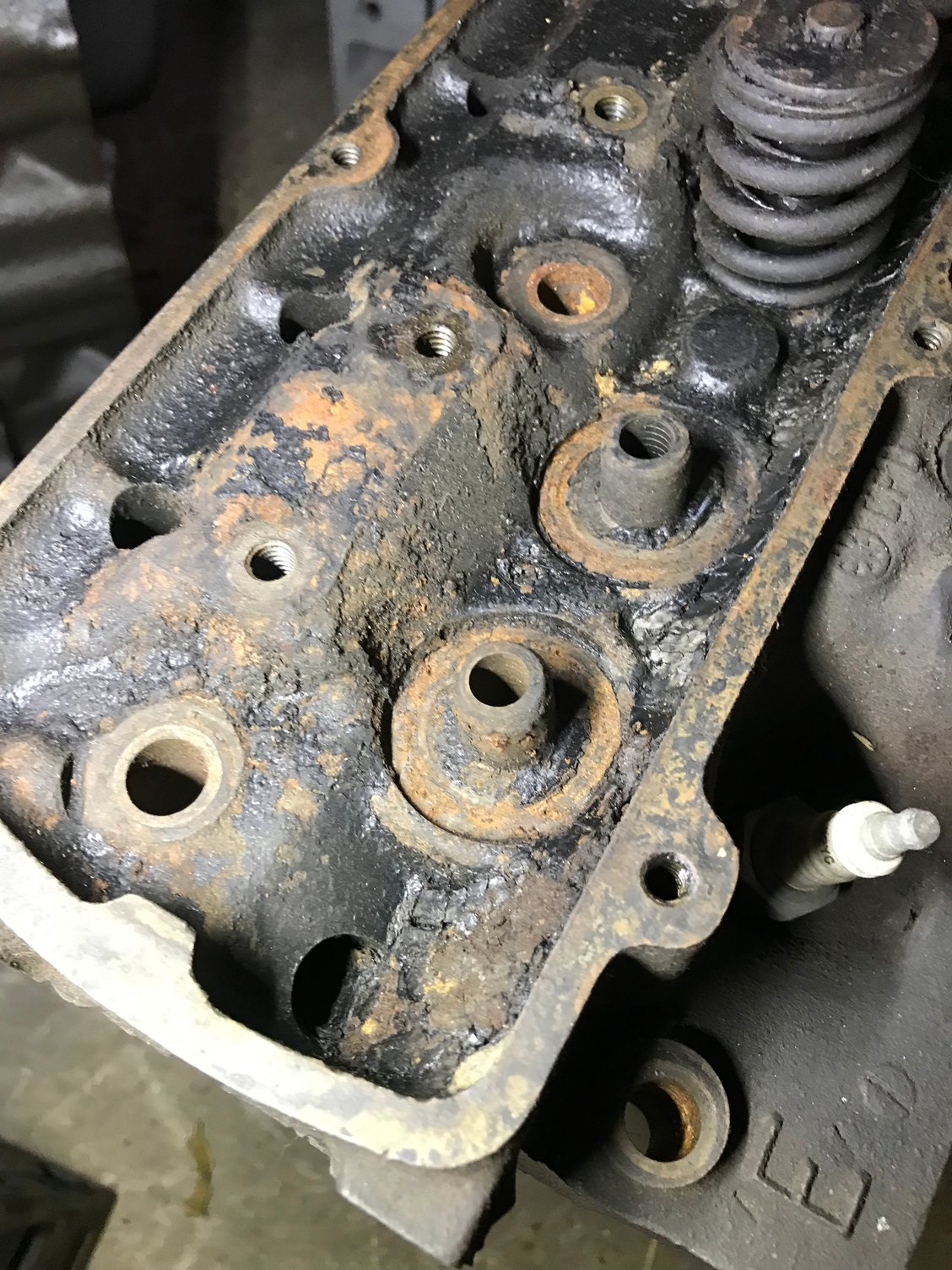

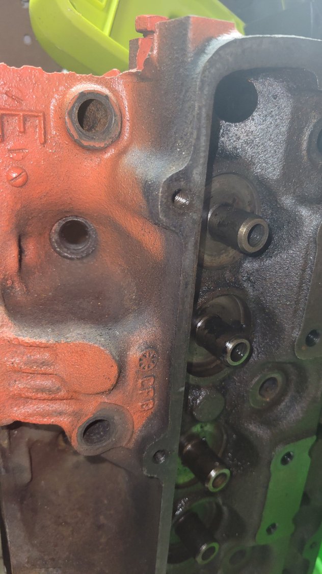

Here’s two E heads, both big valves..one shallow, non rotator, and the other deep springs seats for rotators.

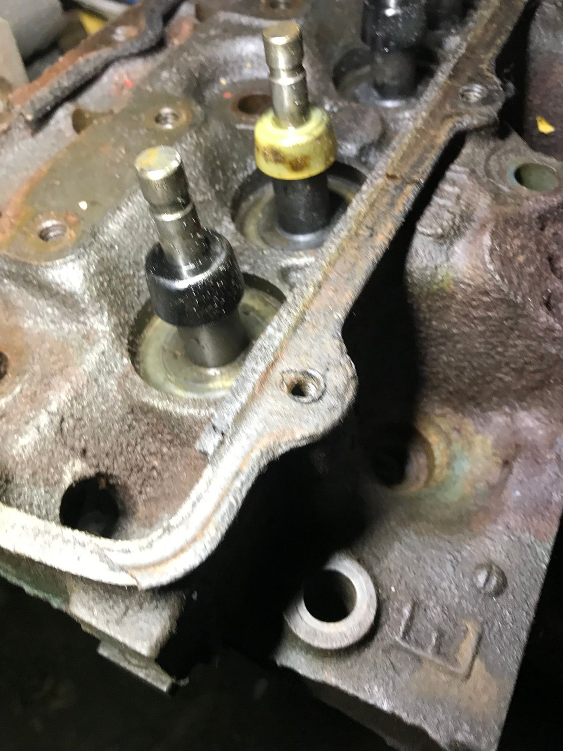

I forgot the E heads also came with half deep and half shallow, rotators just on exhaust
here’s a pic of the third style.. or actually the second style. First would be non rotator, second half and half, third rotators on all

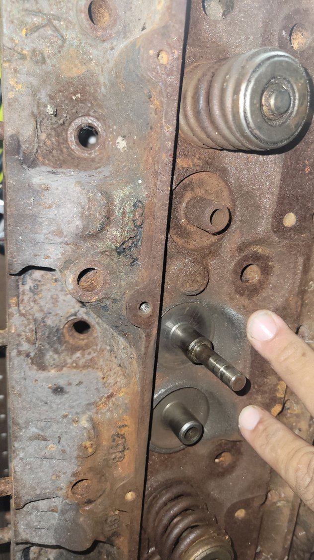

How's it going fellows as stated I'm new and using this forum on my phone . But I'm getting the hang of it if I was told I posted in the wrong section so if you respond please do on my thread in the "Big Block " section. But just read yalls responses . So ok Cutlassefi said that my cam was to big for what I'm doing ( just a home stock rebuild for low end torque and nice choppy sound .) So I'm looking for any suggestions on a cam thats under .500 lift that sounds good and adds some torque . On my E heads the rotators are the half and half . When I bought this engine the guy gave me another set of heads that I didn't pay attention to . They are Ka heads with 2.07 intake valves and also half and half rotators. Bigger than my E heads so added question should I use the Ka heads over my E heads ? So in short which heads should I use and what cam recommendations?
This is the half and half rotators correct?
Ka heads with the same .
