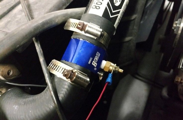

Joe P turned me on to the idea of adding a sensor to the upper rad hose. There's a fitting that mounts to the upper rad hose attachment that you can buy that allows you to run a second sensor here......it's not perfectly accurate, apparantly, but a great backup option. You can keep the original idiot light, or gauge and run this one as a secondary.

If you're using an electric sensor with one of these adapters, note the provision for a ground wire. The hoses obviously don't provide the ground path for the sensor that the intake will.

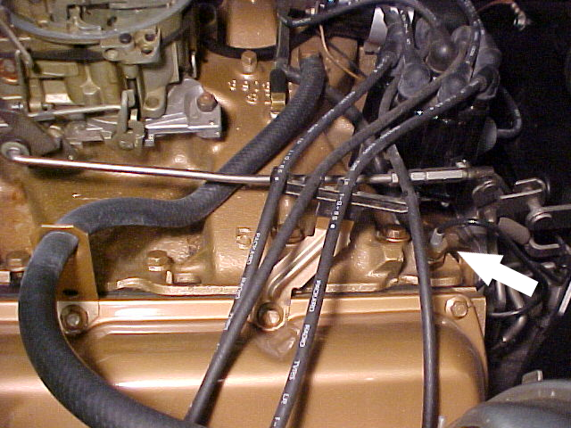

On the old V8 cars this is true as there is only one provision for any sender access. However, there is a boss at the back of the intake manifold in the symmetrically opposite location of the heater hose provision that can be drilled and tapped for a sender. If you do that, you can keep the warning light and have a gauge too.

The boss on the back of the intake is also a dead end, no different than using a tee fitting. Flow will stagnate. You'll read something, but accuracy is questionable. Of course, that point is also before the coolant runs through the heads, which are the hottest part of the engine. There's a reason why the OEM port is in the coolant crossover at the front of the intake.
I had one of these installed in my '78 Toronado. It worked as advertised, but keep in mind that it is located AFTER the thermostat and thus only works if the thermostat opens. If the thermostat should fail closed, you'll only know because the temperature gauge reading is not rising instead of rising beyond the normal range as it would if the sensor were actually in the intake manifold. So your engine could be overheating, and you wouldn't know it as quickly as you normally would. You might not know it until damage has been done.
I eventually took it out and put the sensor in the intake manifold where it would normally go. There was a place for it because, unique to the '78 Toronado, the normal temp sensor was part of the ignition system, and the sensor was actually mounted on the rear of the manifold close to the distributor. The location at the front of the engine where it would normally go is still there, but it just had a plug screwed into it. I removed that plug and inserted the sensor.

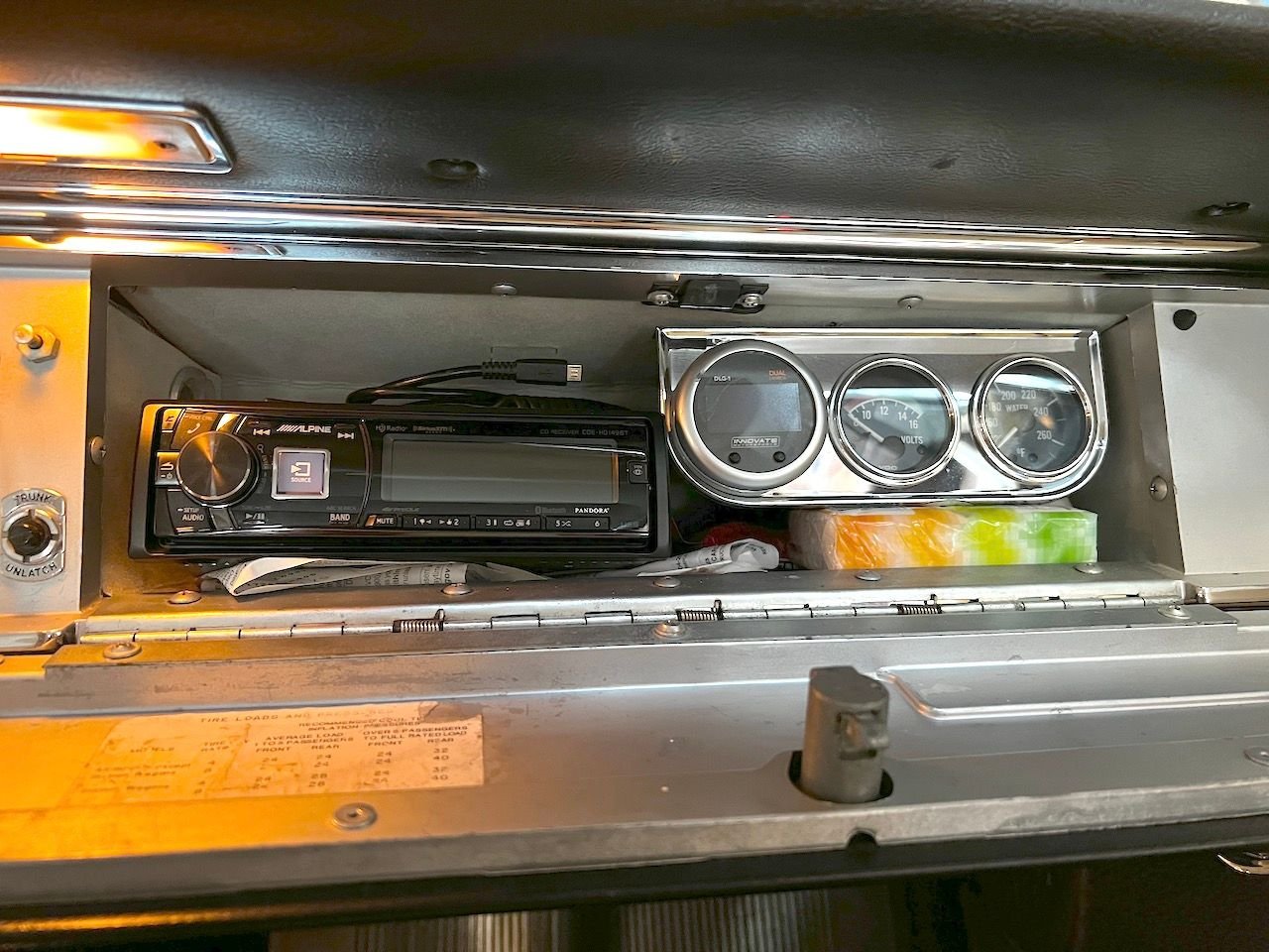

I've had a set of gauges & modern radio hidden in my '66 big cars forever. Close the glovebox & it's 1966 again. Open it & you can see what's going on.
Also since the radio is hidden, there's less for a potential thief to see.
At the moment I've got an 02 sensor, voltage meter and temperature gauge in there. Hope you enjoy this picture. Happens to be my Starfire, but my 98 is the same.
'66 Big Car glovebox with radio & gauges
A couple of tips
1) You'll probably want to disable the glove box light since you'll have the glove box open a lot more than before
2) If you decide on a 3 gauge cluster mount it into the roof of the glove box cardboard with wing nuts - it's hard to get a wrench up in there.
3) Give some thought to getting a reproduction glove box from Fusick just to start with strong, new cardboard
4) As you go to mount a mechanical sensor, make sure the length of cable they give you (fixed at 6') will reach your glovebox from your intended intake sensor location
5) Be ready to provide the gauge cluster with a connection to your interior lights (the gray wires) so they light up at night with the rest of your dash

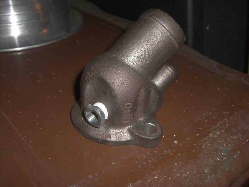

Should it be possible to mount a sensor who feels
the temp of the metal of the intake behind stat housing ? No drilling only contact with the metal , maybe not so correct readings , hmm.

Did you just drill and tap the thermostat housing yourself? Like drilling and tapping an intake manifold you could even have a shop weld/braze the bung to the thermostat housing/intake.
FWIW, I installed an AutoMeter pyrometer in the exhaust manifold of my 86 Ford F250. Cast iron is quite soft making it easy to drill and tap.
Yes drill and tap for threaded adapter, easy to do. I am not sure if the stock aluminum housings could be tapped. This one is cast and aftermarket but works well for a sender.

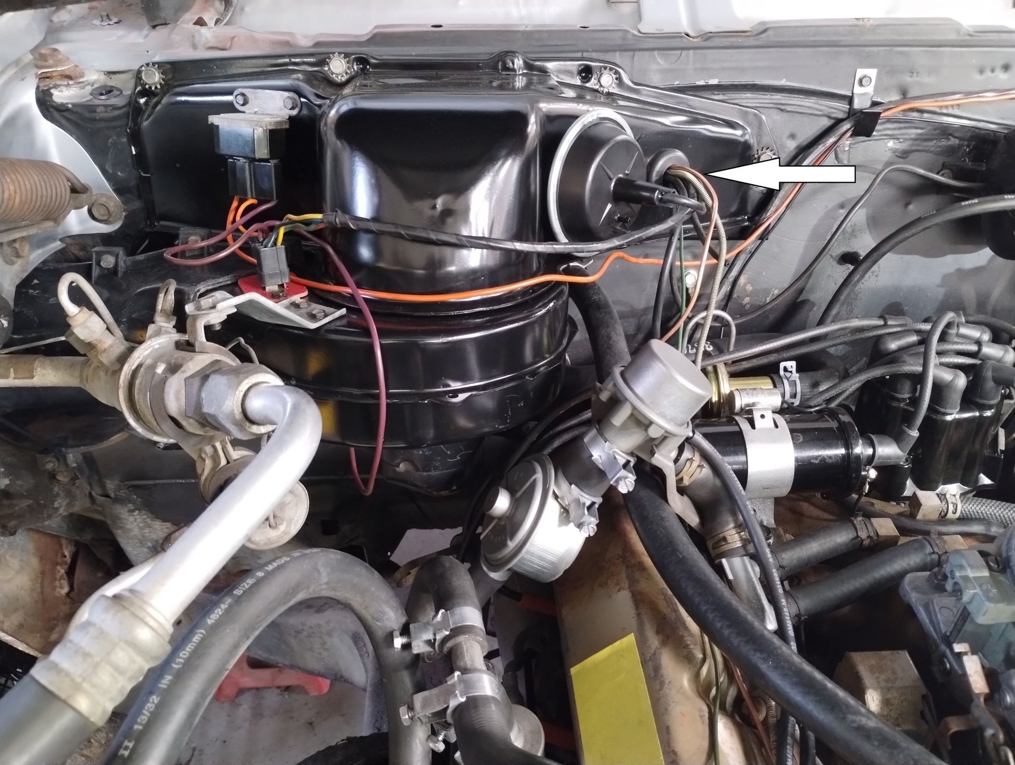

Did you all have to cut a big hole in your firewall for the sending unit? I'd really rather not have to do that if at all possible but it looks like I'm going to. Is there a factory passthrough big enough to work?

Look for a pass-through above the accelerator and brake pedal. If there's no pass-through, that's generally a good place to drill an access hole.
Make sure you protect wires with wire loom when they pass through the firewall.

You need a fairly large hole for a mechanical gauge but there is nothing wrong with modern electrical gauges and all they need is a hole large enough for a wire to go through.

Does your car have A/C? I don't know about the "98" but the Cutlass with A/C has a grommeted hole in the air plenum big enough for the wiring, a copper oil line and the temperature capillary line.

Thank you for the idea! I went outside to check mine out and unfortunately I don't have a hole like that. I do have a hole on the left side of the firewall that all of the A/C stuff goes through but its covered up in the factory seam sealer stuff. I may have to look on the inside to get an idea of the hole size.
