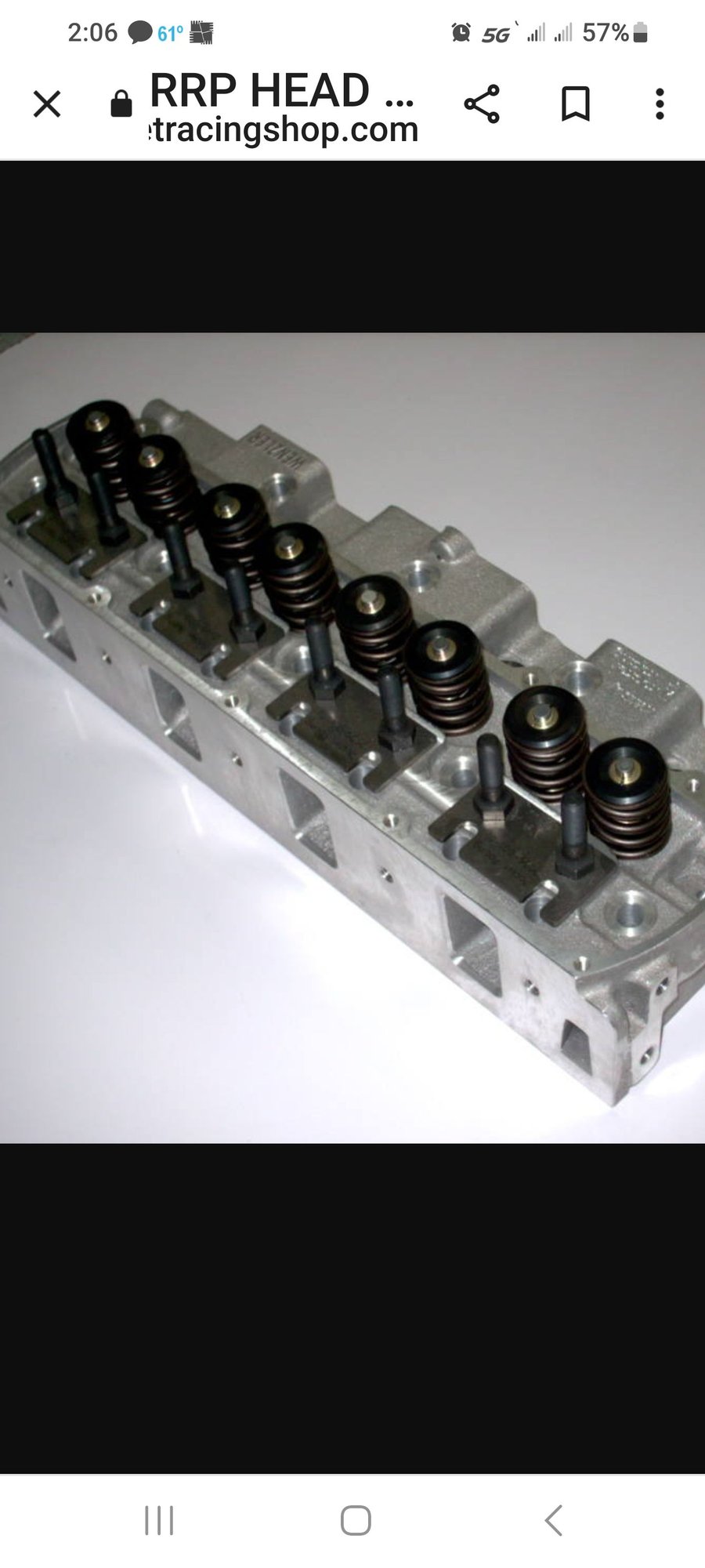

When running idlers on the v belt, I just don’t see it working unless you have one next to every pulley on the whip side, and even then, I don’t know if you can get enough tension on that long of a v-belt.
By the way, did you scrap the idea of running the Rocket Racing heads since the dyers intake is for stock Olds-intake pattern heads?

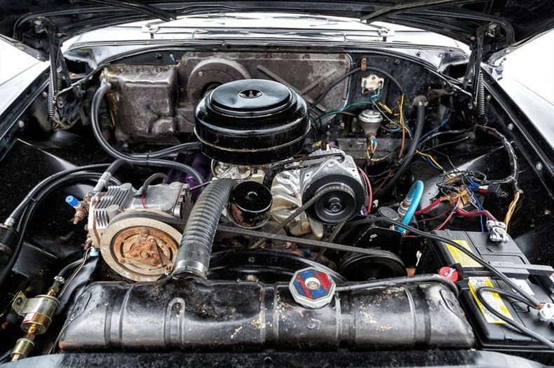

The problem you have, is that your belt is running both accessories. The section of the belt that is running under the crank pulley only touches the pulley for about 90 degrees of the circle. Which may not generate enough friction to run both the power steering (potentially high load) and the alternator.
If you notice in the Mopar setup power steering alone touches the crank pulley for about 180 degrees. The water pump about 145 degrees. The alternator and AC unit touch for about 120 degrees times two belts. So total about 240 degrees. So perhaps if you can you can run two belts in a matched set and perhaps that will generate enough friction.

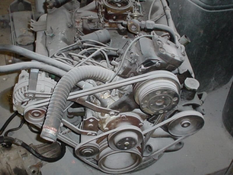

So after some researching the belt I have is the "Ac belt" from a 1955 DeSoto with a "firedome" engine. Not a lot of good pictures on the internet but seems to be a similar arrangement as what I am trying to do.
Belt is an AC Delco part: ADO-15715

Quick update. They Dyer snout hits the tri plate cover on my 671. As a result I had to give it a little trim with a bench grinder. In addition the oil fill hits the bottom of the blower as well. I gave my stock one a little love with a welder to make it fit. If you happen to have the curved tornanado oil fill tube that would likely work.
This will be my last update for a bit until I do the final order for the remaining engine parts.
