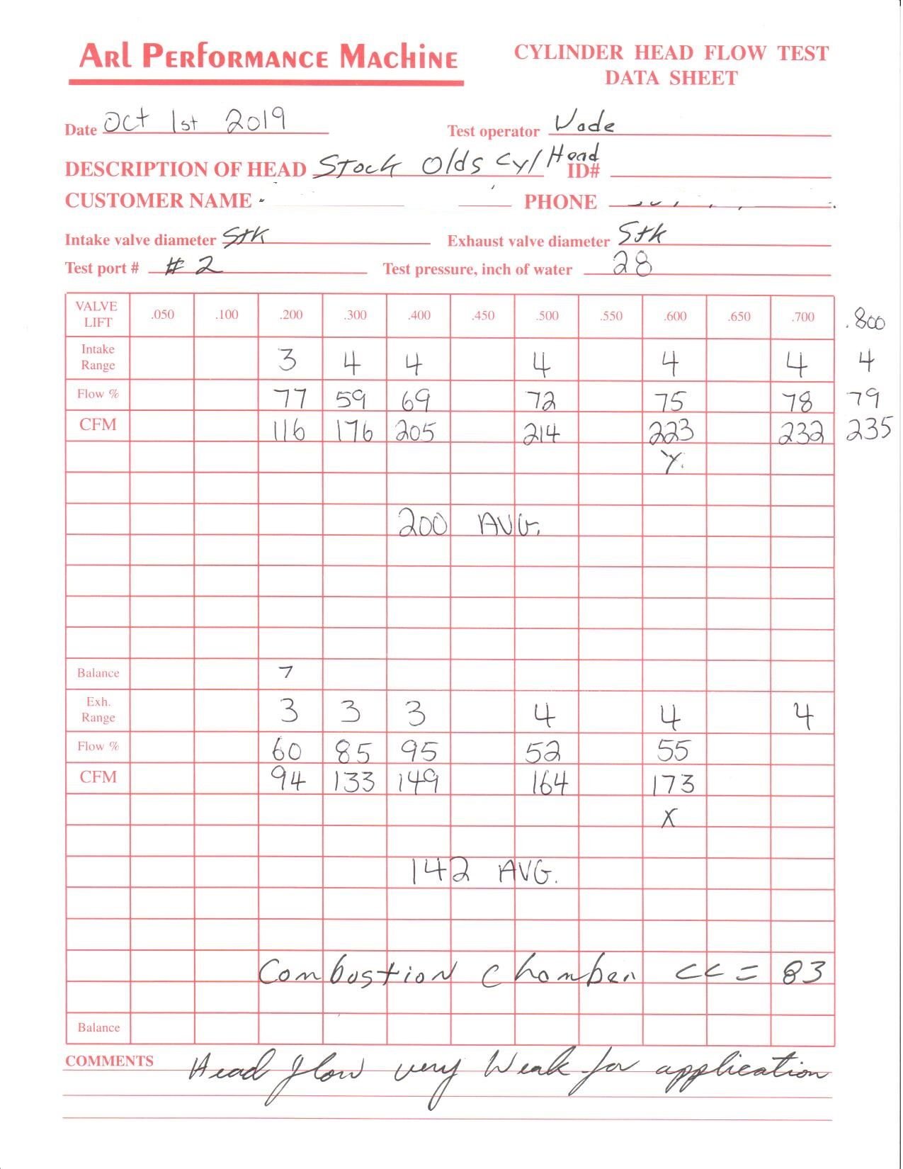

Hi guys i got my current 20 year old possibly ported heads back from being flow tested. Results are below. See about right for basically stock. So whatever port or polish work
was done previously was probably less than good.
Intake:
Lift / CFM
.200 - 116
.300 - 176
.400 - 205
.500- 214
.600 - 223
.700 - 232
.800 - 235
AVG 200CFM
Exhaust
Lift / CFM
.200 - 94
.300 - 133
.400 - 149
.500 - 164
.600 - 173
Combustion Chamber Volumn CC=83

Those numbers are conducive to no more than a cartridge roll cleanup. Somebody lied to you.
Somebody lined to the previous owner or the previous owner lied to me. Ether way I now know what I have.

Somebody lied to the previous owner or the previous owner lied to me. Ether way I now know what I have.
Yep, but it’ll still limit your power level to some degree.

As other have said it is a fine line between spending too much money on these heads when the plan is for a future upgrade to proper aluminum heads.

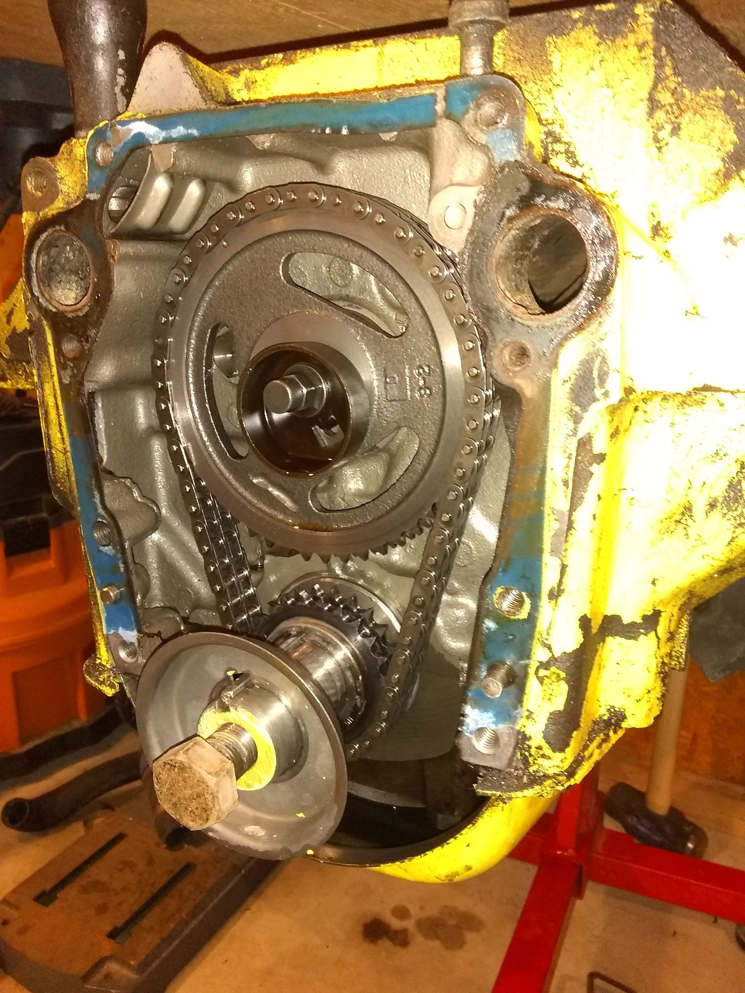

So quick update. ATI Aluminum shell balancer, Canton Oil Pan, Milling HV oil pump and pickup arrived. I do have to say the Canton pan with all it's baffles looks to be a real nice piece.
I also dug into the engine a little more and it looks like I have an aftermarket timing chain. Not that I know what I am looking at, but it's condition seems fine.

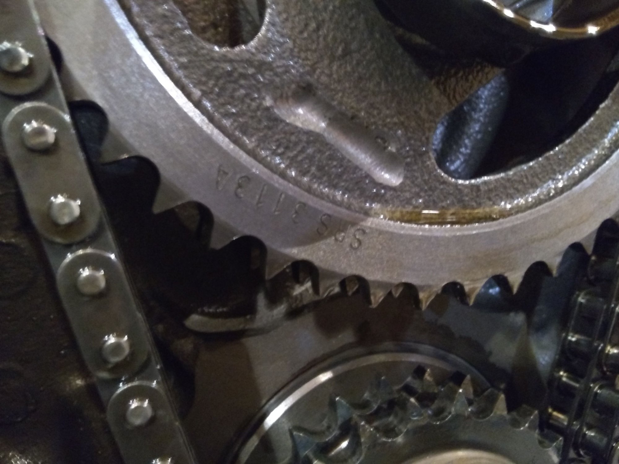

My one question is what timing chain do I have? The only part number on it is SRS 3113A on the top gear and SRS 3113B on the bottom ? Is it Comp Cams maybe? Google doesn't seem to bring anything up with this number​​​​​​​.

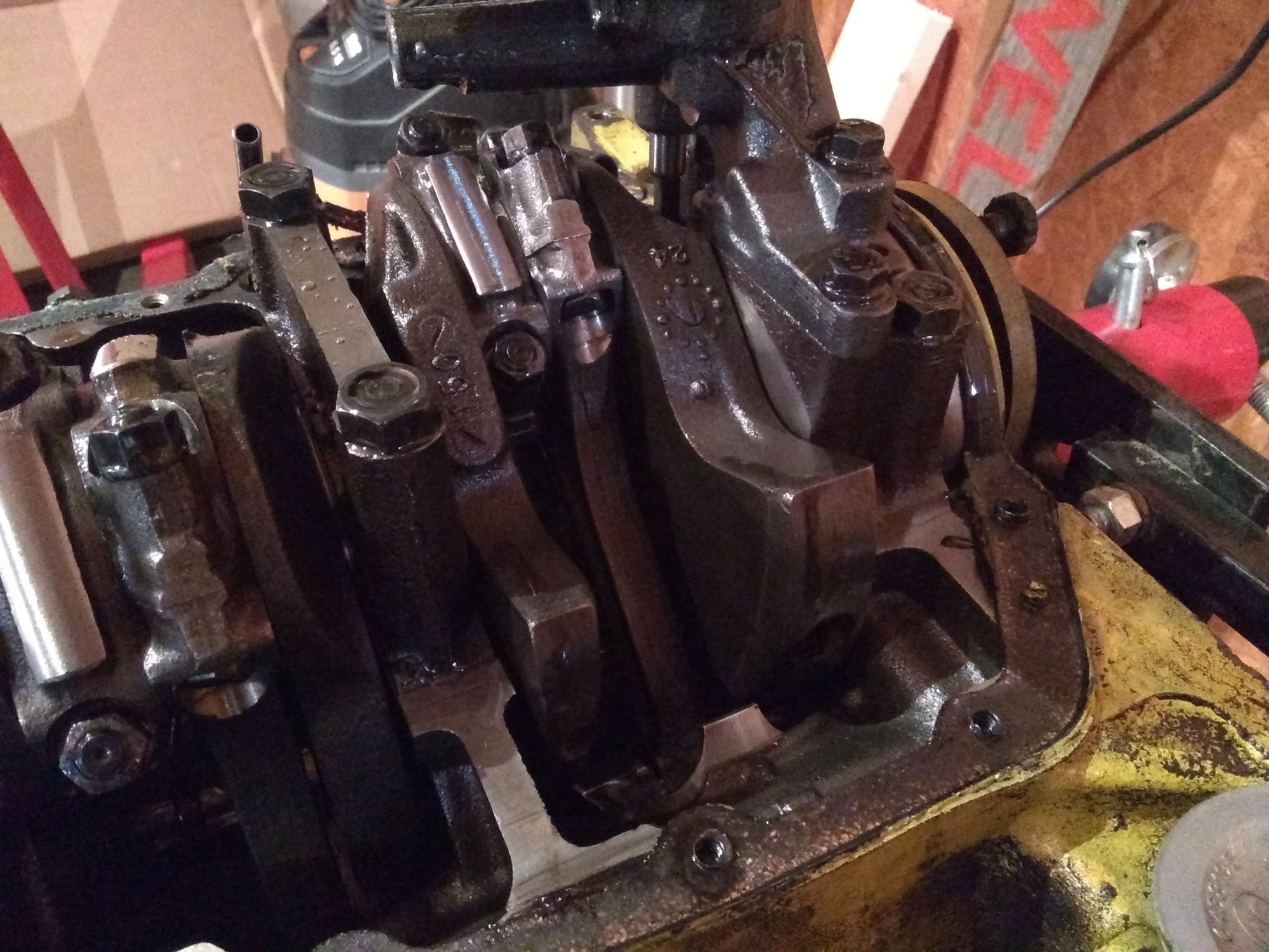

Slowing making some more progress on the engine. Got the pan off. Looks like my crank might not even be an N crank. No big N cast anywhere. Just one really small N (see pictures)
On the plus side it looks like the last owner used a milling HV oil pump so that was a good choice on their part.

Look at your timing chain... there is an piece missing on one of the pins near the water pump hole in the above picture on post #69.

Re-looking at the picture I think this is what you are talking about? If so I will have to look closer at that tonight.

Why use a used timing gears and chain. Step up buy new. Engines with power find weak links .Jmo I keep hearing shipping cost story though out this thread. Would it be cheaper to go get it? As in block choice and crank in the States. Just seems like why use a block that is weak compared to a diesel or the rocket racing block. Now you have heads that are not as good as there were thought to be. It all adds up to why. Build it right once then sell what you do not need to help recoup some of the cost. Good thread with lots to think about.

Yes, Earl, I think you've got it in post #72. It looks like the pin is working its way out through the back. I'm of the same mind as the others - go ahead and get a new timing set. I bought and installed a Cloyes double-roller set up that is adjustable for advancing or retarding spark. Less than a C-note, including shipping. and I won't have to worry about it, well, forever

I bought and installed a Cloyes double-roller set up that is adjustable for advancing or retarding spark)
Thats not why it's adjustable. It’s to correctly degree the cam, which I’m guessing you probably didn’t do?

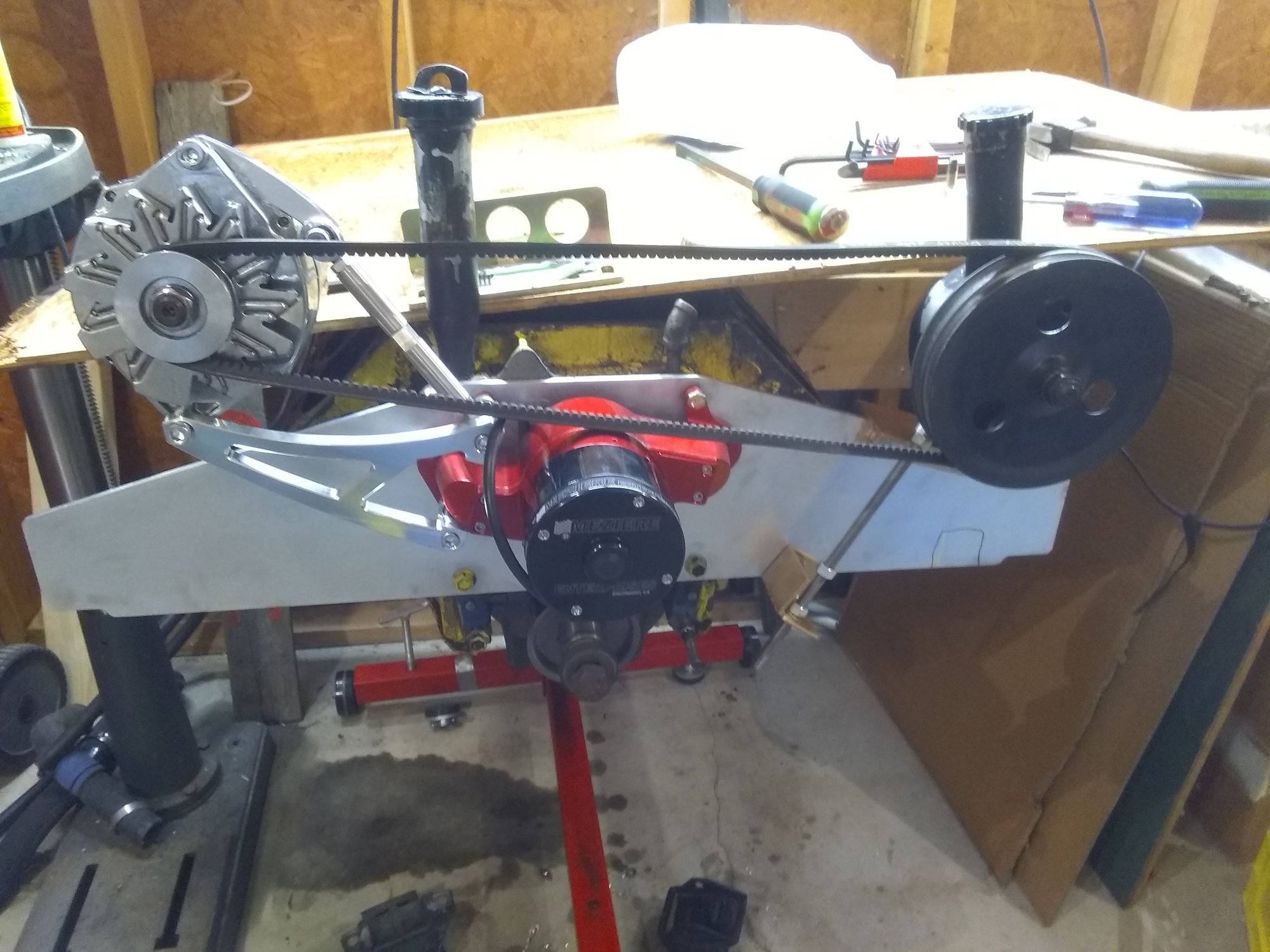

So tonight I got my accessories mocked up with the motor-plate and learned some things
1) An electric water pump and high mounted accessories will have belt interference unless the belt is in a "triangle" (routed crank-.powerSteering->Alt->Crank)
-if the alt & power steering pump each have their own belt then they will hit the electric water pump motor.
2) Motor plates really mess with accessory placement. They are definitely designed for a drag car applications.

P.S. I have had my stock untouched "G" heads flowed, stock 2"x1.62" valves and they flowed similar to yours but at a lower lift. I also made 340 RW/Hp on the dyno.
