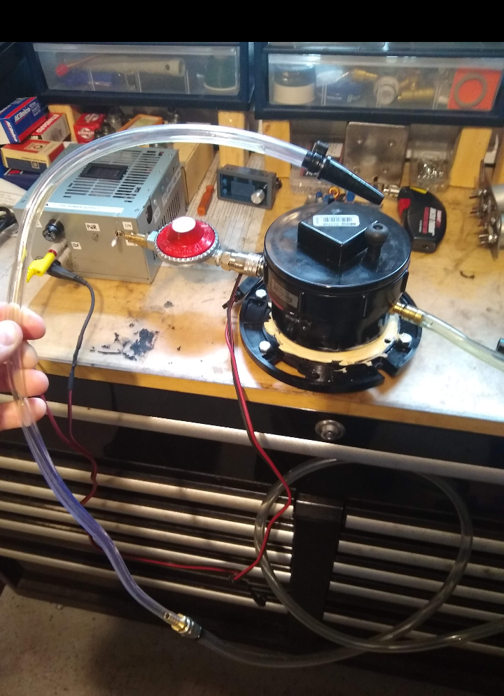

Do you know anybody at a good modern repair shop ? If so they will almost certainly have a "smoke" machine for checking emission systems. Have them smoke the exhaust. It will find even the smallest exhaust leak.
Do you know any other car guys local that can listen to it for you and get a second opinion ?
With regards to heading in the wrong direction, I agree. I wish there was a sharp ear around here that could help me out.....I've yet to find one though.
Funny you mention the smoke machine.....I built one myself. I also built a handy little power supply out of an old computer to power it. See pictures. I'll try it next and see if I can find something.
