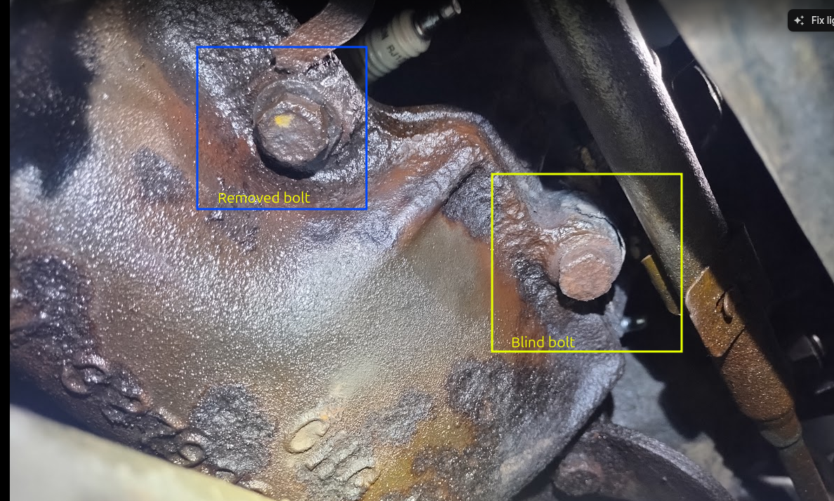

Ok so a little success. I removed that easy to get to bolt. Just used heat, Kroil, and patience. I put the bolt back in and snugged it so that the rest of the manifold doesn't start to twist as other bolts are removed.

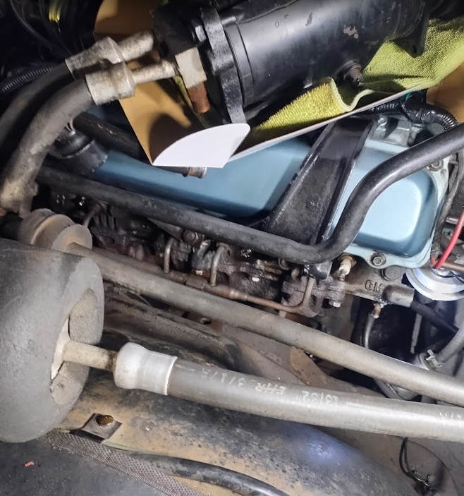

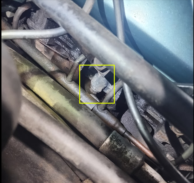

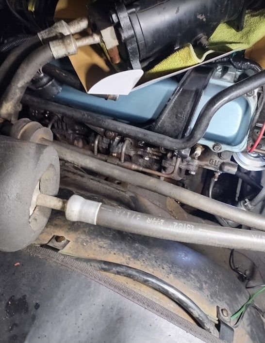

The next bolt, however, yikes! I decided to move on to the center, blind bolt. I don't know what's going on with this bolt head but 14mm is just way too big. 13mm and 1/2" are both too small. There's way too much play on that 14mm socket when I lay it on the bolt head and move it side to side. Using that 14mm on there will be disastrous.

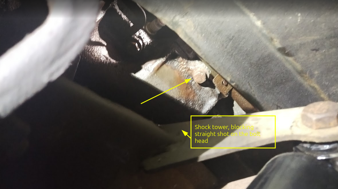

I can't get a straight shot on it either, from down below in the wheel well, because of the shock upper mount. I actually have no idea what I'm going to do next. I guess a Turbo socket could work but that's probably gonna be a one shot deal. I'm walking away from this one for a bit to regroup.
View of manifold center, blind, bolt from underhood.

View of shock mount, blocking straight on access to bolt head. I can get at it with a universal.

The bolt heads are rusted, which is why sockets don't fit correctly. If 1/2" is too big, get a 12mm six point and hammer it onto the bolt head.
Just to be clear, these are 3/8"-16 bolts that are supposed to have a 9/16" hex on them. They're rusted down so that 14mm fits better, except for this one bolt.
13mm and 1/2" are both too small for this particular bolt. I'll try hammering on the 13mm to see if I can get it to fit.

The bolts in the blind holes are definitely difficult. Vise Grips may be the answer. If you use them clamp them on as tightly as possible or tighter it is important that they don't slip and destroy the hex. I'd try hammering a socket on first even if the head of the bolt has to be filed slightly.
That's actually a really good idea. Make it just a bit smaller so the 13mm fits. Great suggestion! My Turbo socket seems to fit it pretty well too.

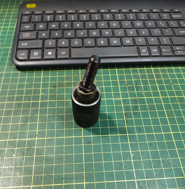

Got the center blind bolt out. It required stepping down to a 13mm extractor socket. Crazy, that bolt has degraded from 9/16" all the way down to 13mm. My method was to heat the cylinder head with a torch, smack the bolt head with a drift, cool the bolt head with upside down computer duster freeze spray, smack the bolt head with the drift again. Repeated about a half dozen times. Then I pounded on the 13mm extractor socket using a 1/2" drive extension and universal 3/4" socket. I had to use the universal socket because the shock mount is in the way preventing a straight shot, Once it broke free it didn't fight me at all on the way out. I'm just going to continue this method on all the bolts (hopefully will not have to resort to the extractor socket like on this bolt).
I did not use any impact wrenches here, only a big *** 1/2" drive ratchet. I'm at two bolts now after a week so at this rate, I should be finished up in a couple years.
13mm extractor socket sitting in 3/4
13mm extractor socket sitting in 3/4" socket.
These extractor sockets are excellent
Bite marks on the bolt head.

There they are.....all 10 of 'em. Only took me better part of two weeks to get them out, haha. There was some praying involved. Lots of various penetrating oils (Kroil, Deep Creep, Mouse Milk, Liquid Wrench) and my torch. Some of them came out easy but others were setting off my "danger" alarm so I really took my time with them. Heating, spraying, smacking them with a drift.
Anyway, on to giving the manifolds a spiffing up with some sandblasting and POR-15 manifold paint. Then the Remflex gaskets and re-install. High temp anti seize as well.
What does everyone like to use for replacement manifold bolts anyway (I don't require stock looking bolts)? I've got some new grade 5 bolts but should I use grade 8 instead maybe?
