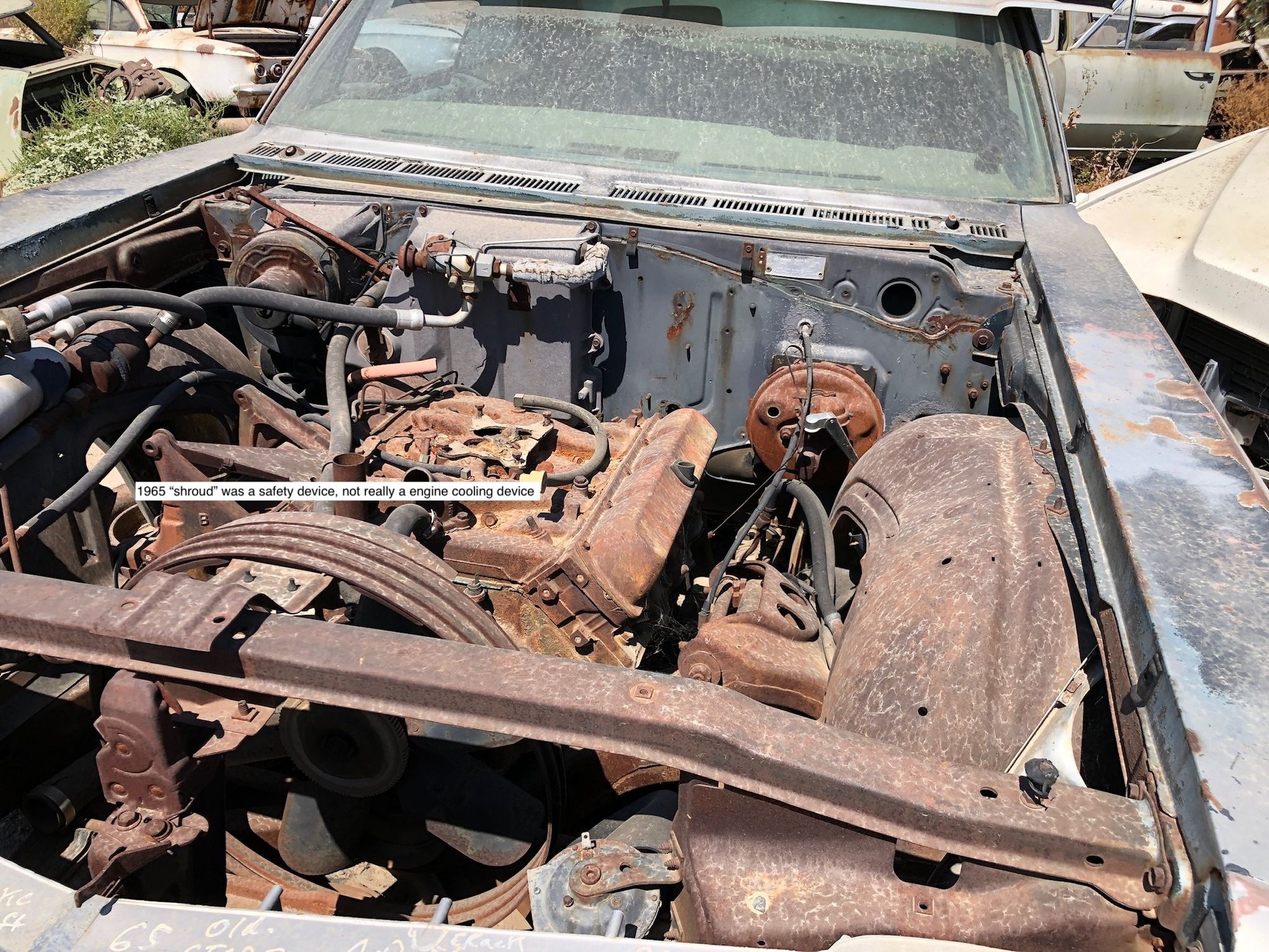

First up, the 1965 "fan shroud" wasn't really ducting any air at all, it was more of a hand protector so no one got their hand in the fan. Here's a shot from a junkyard car:
1965 Olds 88/98 with radiator missing so "shroud" is clearly visible:
Hopefully this saved some hand injuries, it could not have helped cooling very much.

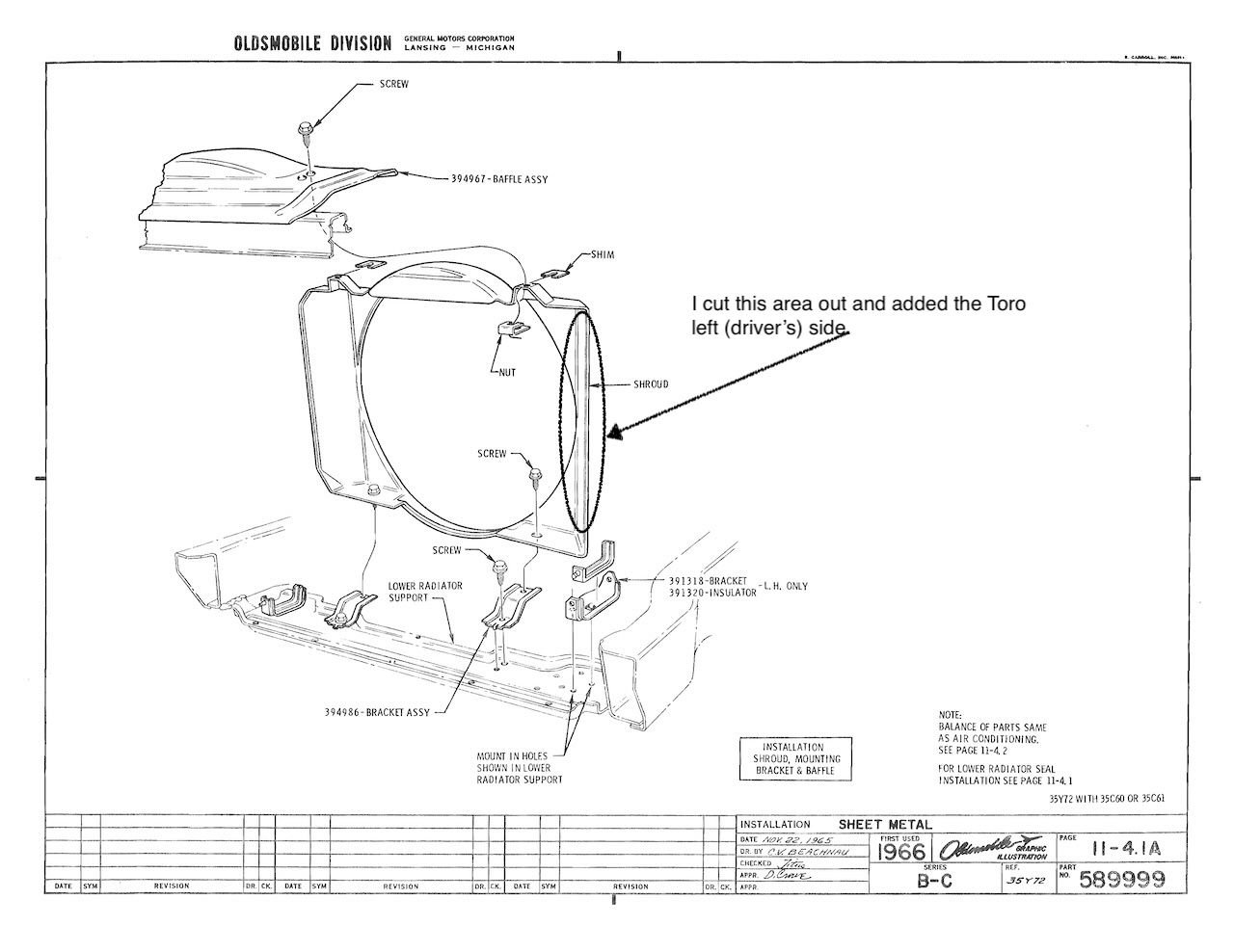

Here is a factory diagram of the 1966 Olds shroud with a note on the modification I made to mine by adding the left half or so of a later (1968 or 1969) Toronado should on the left.

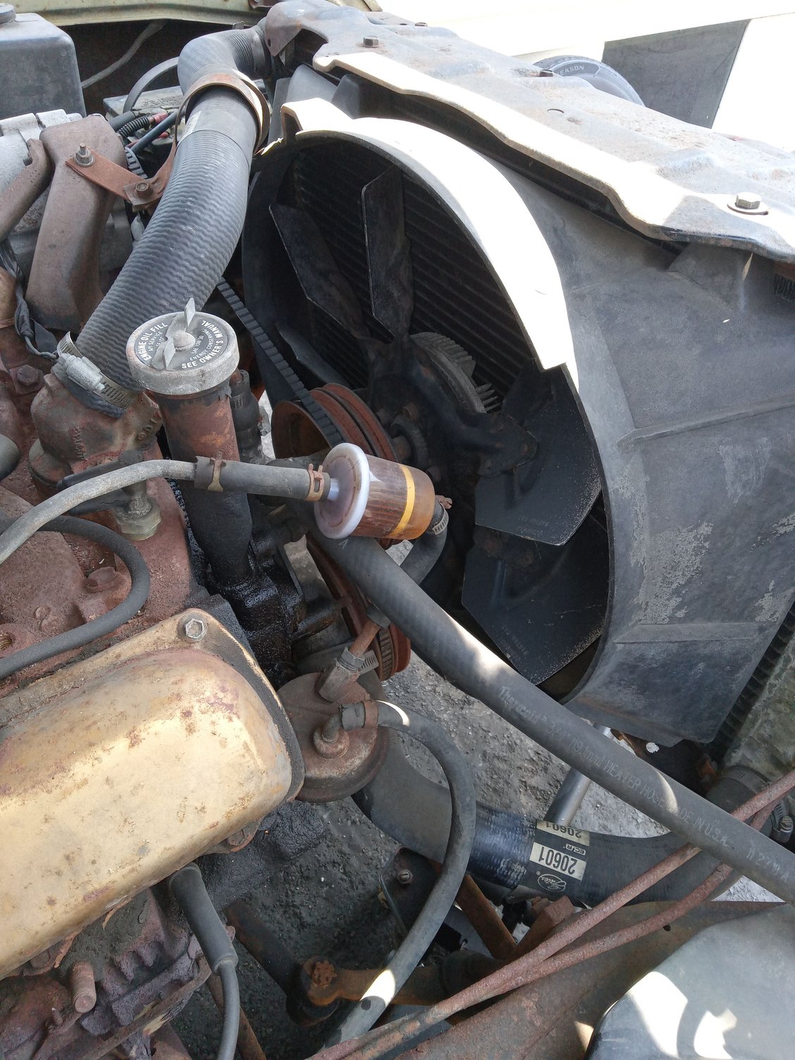

In my 66 98 (No air conditioning), here is how it looks from the driver's side:
Modified 1966 shroud in 1966 Non-A/C 98 convertible.

Make up for 1966 Olds cheapness by adding half a Toro shroud to your 1966 factory fan shroud for complete radiator coverage.
