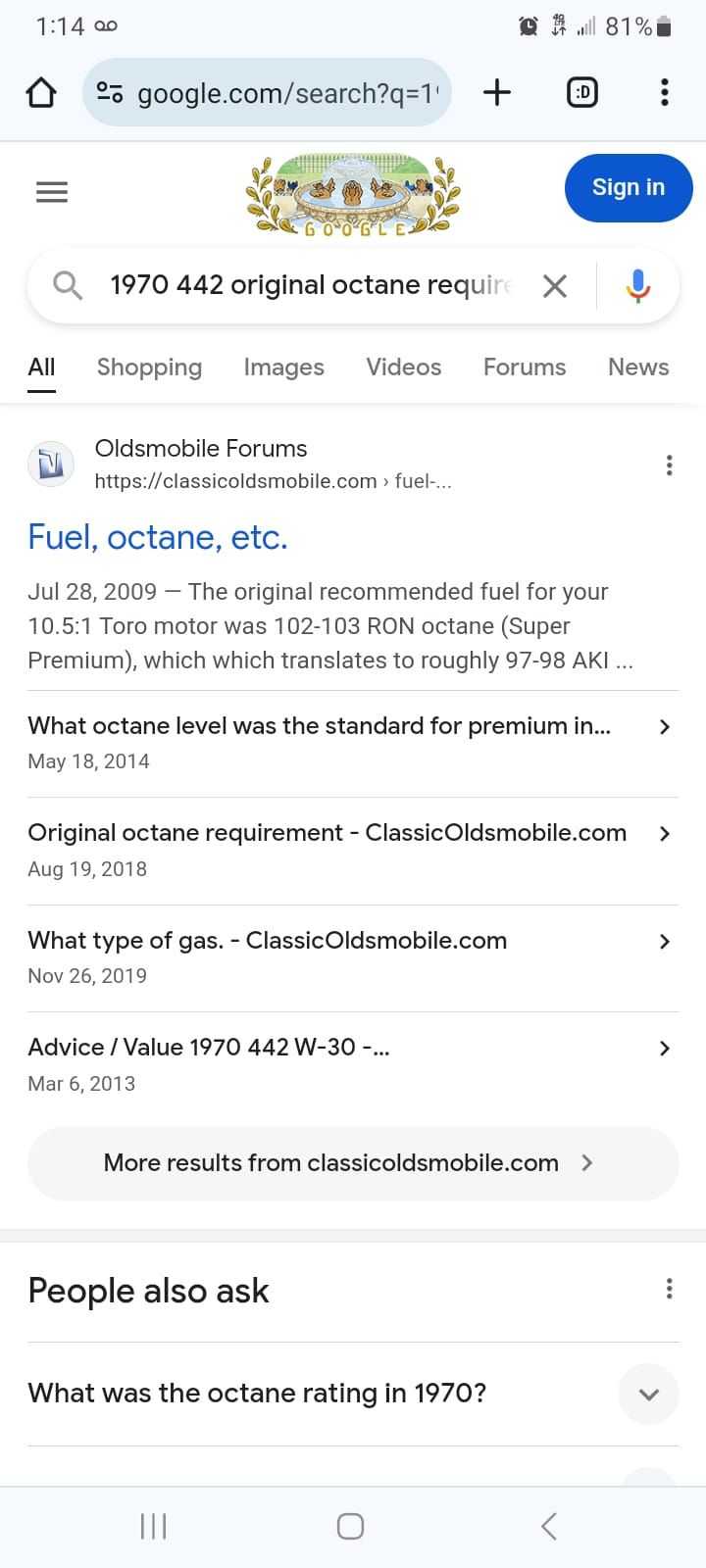

Old school octane rating system was different. 93 today is 98 in muscle era. And a 1970 442 required 100 octane minimum.
Here below is the reality for a Toro and your 442 as well.
Only 2 ways to really resolve this issue, detune the engine as Sugar Bear mentions, or buy race fuel which is what old school gas is considered today. And of course it's ridiculously expensive.
