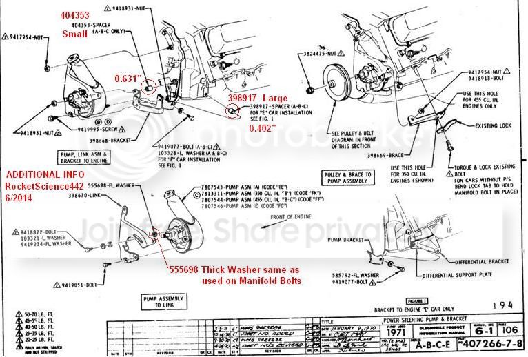

Look carefully at these diagrams, which include the spacer dimensions, thanks to Chris:
The thread about the spacers is here.
- Eric
