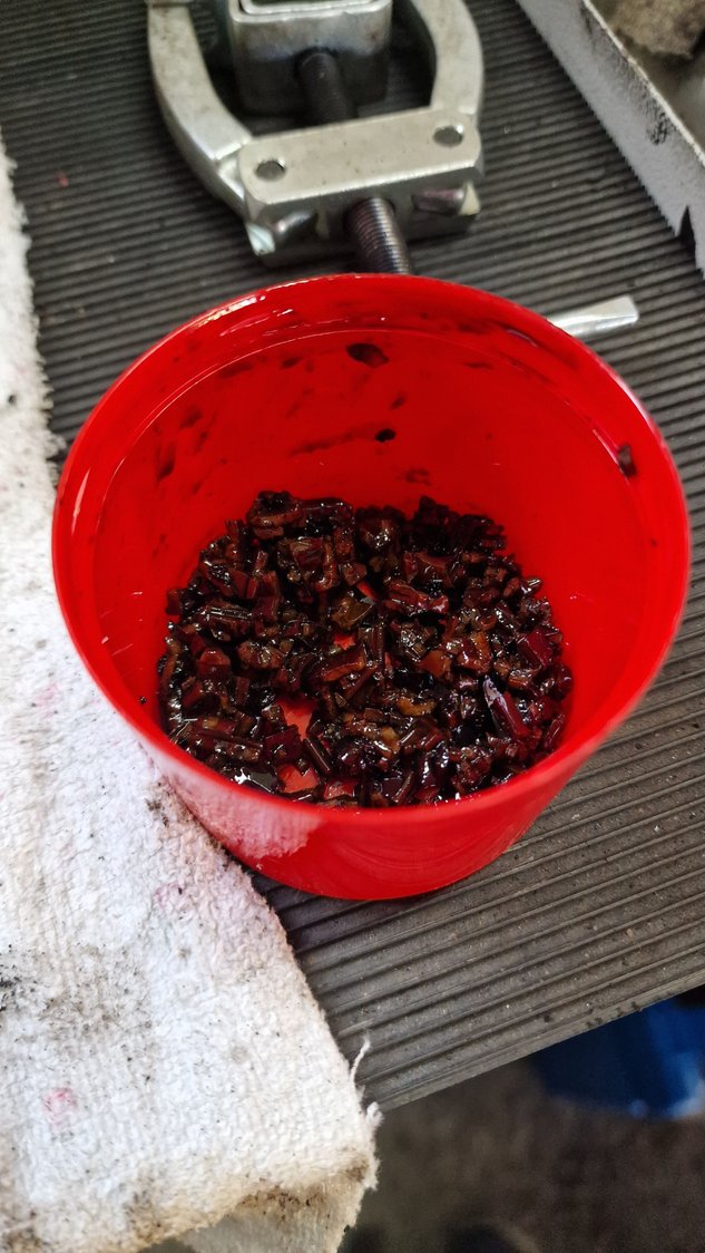

Hi all,

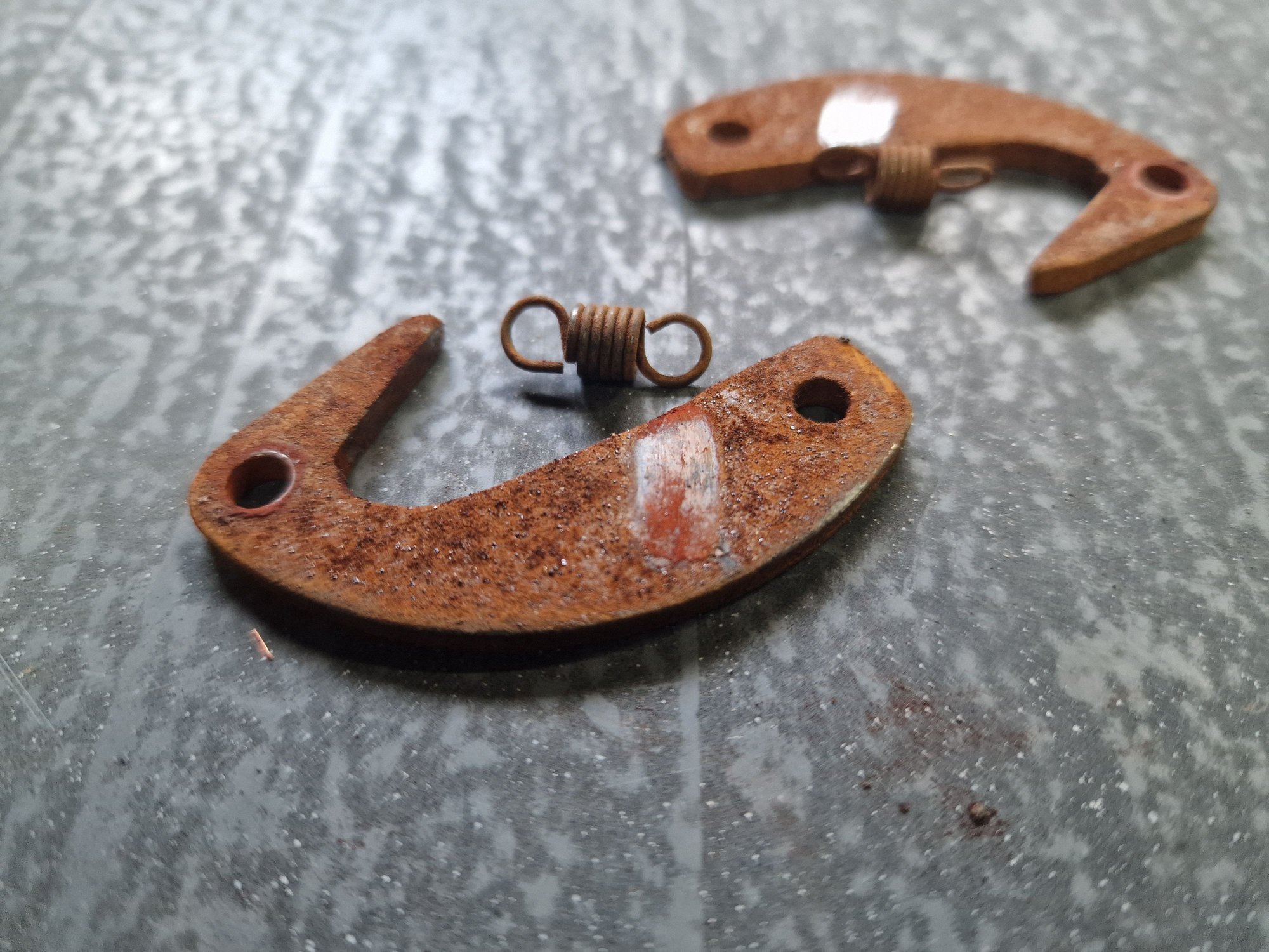

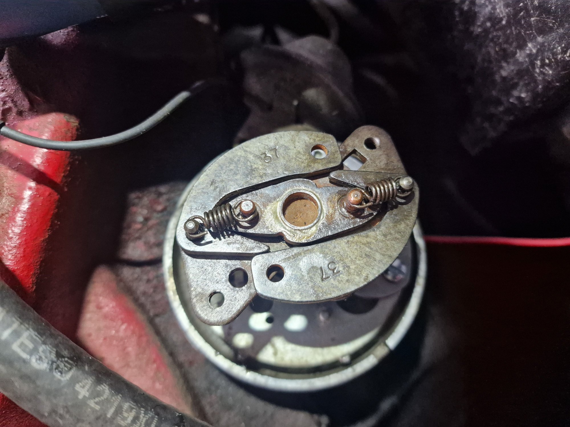

before having rebuilt my 425 in my 1966 Starfire, I also experienced sometimes dieseling when shutting off. I checked the idle timing and it was fine. Then I checked the distributor advance weights and found out the advance mechanism was stuck (vacuum advance was okay though).
I pulled the distributor and made everything move nicely again, and for some months I had no dieseling any more. So you could check the rpm advance weights if they work and allow timing to be advancing at higher rpm. Because if not, timing seems good at idle but is too late at higher rpm (means, typical driving condition), and then heat up spark plug tips and other parts too much so that they might cause the dieseling effect.
In my case, unfortunately the problem came back after some months and I had to repeat the procedure. When I overhauled my engine last winter, I finally found the root cause (probably not very common, but still I want to share here):
My engine was not well maintained by the previous owners, had lots of oil sludge and completely broken valve stem umbrella seal fragments sitting everywhere. When I teared down the engine and checked all oil gallery's and plugs, I found that a small fragment of a valve stem seal made it even past oil plump and oil filter into the oil plug which should drain oil onto the camshaft/distributor gear in the back of the engine block. So the distributor including its advance mechanism did not get oiled properly and got stuck over time.
Ah, another possibility which also happened to me was that the harmonic balancers outer ring slipped due to a defective rubber layer (see the two pics at the end of my post). So the timing seemed right but actually was not! I first tried to add a mark to the right place on the outer ring but it kept moving. I finally fixed the issue buying a new balancer from damperdudes.com, can recommend them really. Fast service and excellent quality.
Just my 5 cents, maybe could also be explanations for your case.
CU, Steffen
Here I add some pics for illustration:
Advance weights before restoration, no wonder theat the mechanism did not work smoothly
Advance weights before restoration, no surprise that the mechanism did not work smoothly
After cleanup
After cleanup

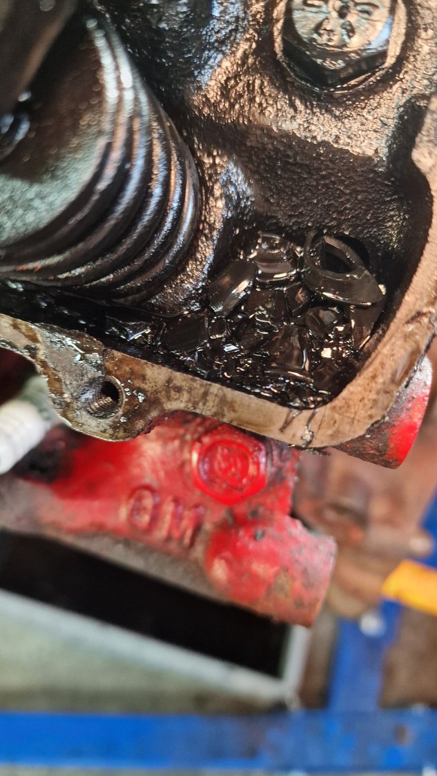

Valve stem seal fragments in my engine like crazy
They even clogged the oil holes down from the heads
Crazy amount pulled out from the engine
Crazy amount of valve stem seal fragments pulled out from the engine

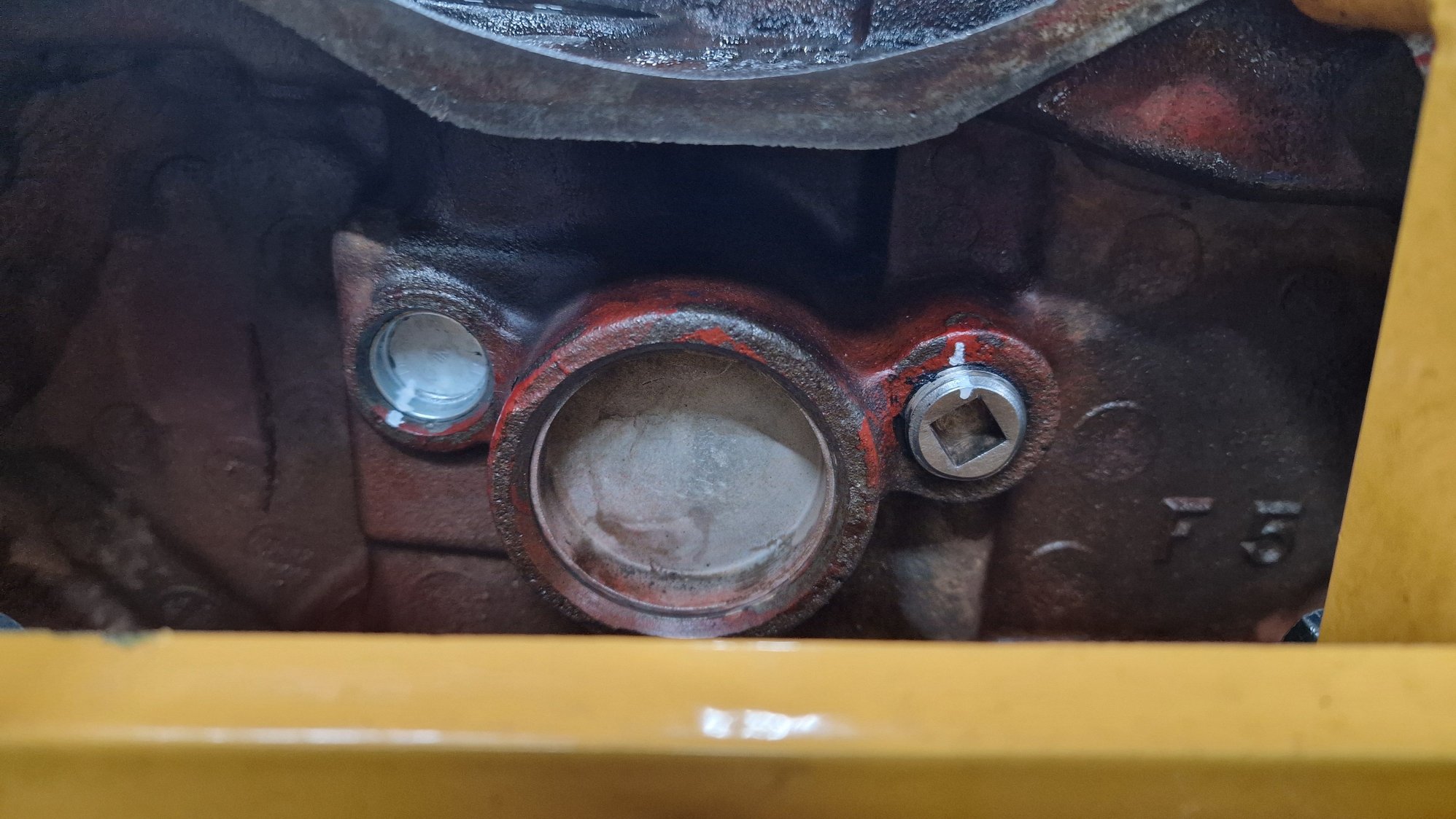

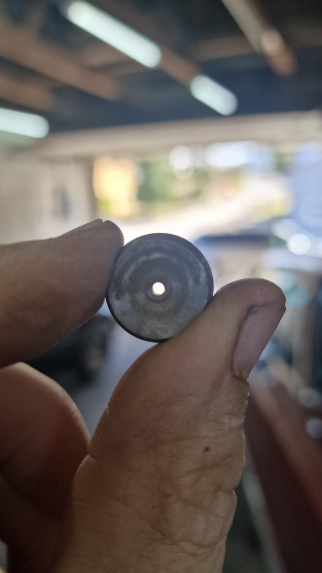

Clogged oil hole for distributor gear
Minor oil flow was still possible, but in no way as intended
Removed the fragment
Location of the plug, looking down into the block at the distributor flange
The plug is behind the sheet metal plug on the left

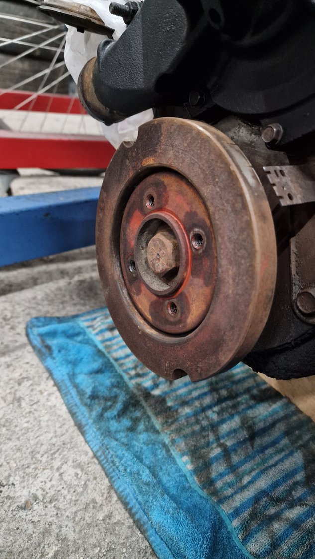

Second possibility: timing wrong even though Mark seems right
Second possibility: timing wrong even though mark seems right
My balancer rubber was defect and the outer ring slipped
