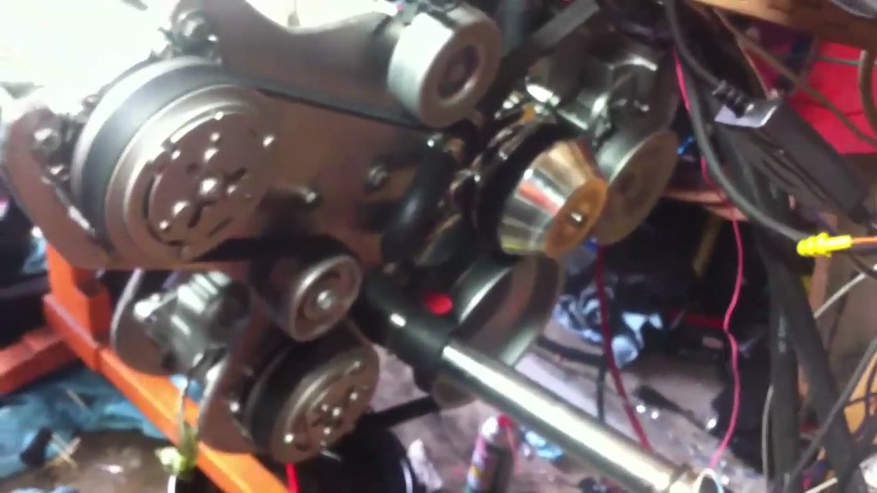

Here is the video after I got it started on 1357 and then connected 2468
http://www.youtube.com/watch?v=2md_E..._order&list=UL
Here's what happens when all 8 coils are pluged in
http://www.youtube.com/watch?v=be5yaZErdPA

Got her running good
http://i201.photobucket.com/albums/a...8/f663bff2.mp4
