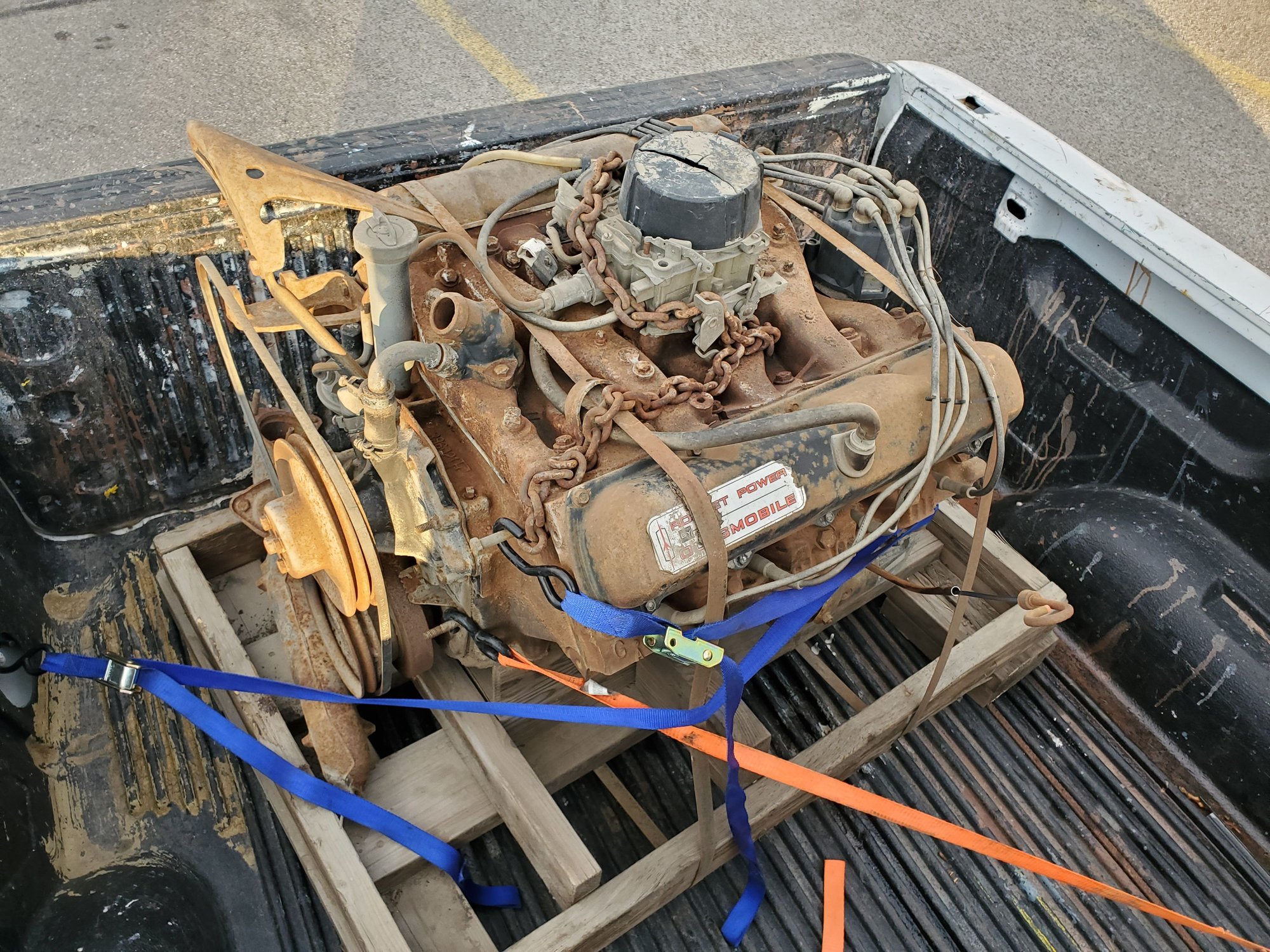

Hello all, I'm in the process of reassembling a 1972 455 that I picked up a few years ago and I would like some info from the Olds experts on cam selection. This is my first Oldsmobile so go easy one me The back story on this engine is that it was purchased new back in the 70's for someone's boat and they never ended up installing it so It sat in a semi covered yard site for nearly 50 years until someone decided to do a cleanup and I bought this rusty lump for scrap price. When i opened it up it turned out to be a brand new never fired crate motor straight from 1972. Apart from having to sleeve one cylinder due to deep pitting the rest of the engine is pristine internally and after cleaning everything up (inside and out) I am now at the point of reassembling it. I've determined that it has a 409691 cam and after measuring The compression should be right at 10.5:1 so my question is, how is this thing gonna run with that cam and compression on modern pump gas? It's going into a 1969 cutlass convertible. Would this be a decent street cam to use or would I be much further ahead choosing a more modern grind?
Old Mar 1, 2024 | 06:30 AM
Posts: 50,768
No 1972 Olds motor would have come from the factory with 10.5:1 CR. It WAS possible in 1972 to purchase an earlier model engine assembly with higher compression. How do you know this is a 1972 motor?

A few things point me to the conclusion it's a 1972, One being it has "Ga" heads on it. I'll add a few pictures from when i first tore it down for context here. The L2E on the vin pad and isn't the "278" on the bottom of the head a date code?

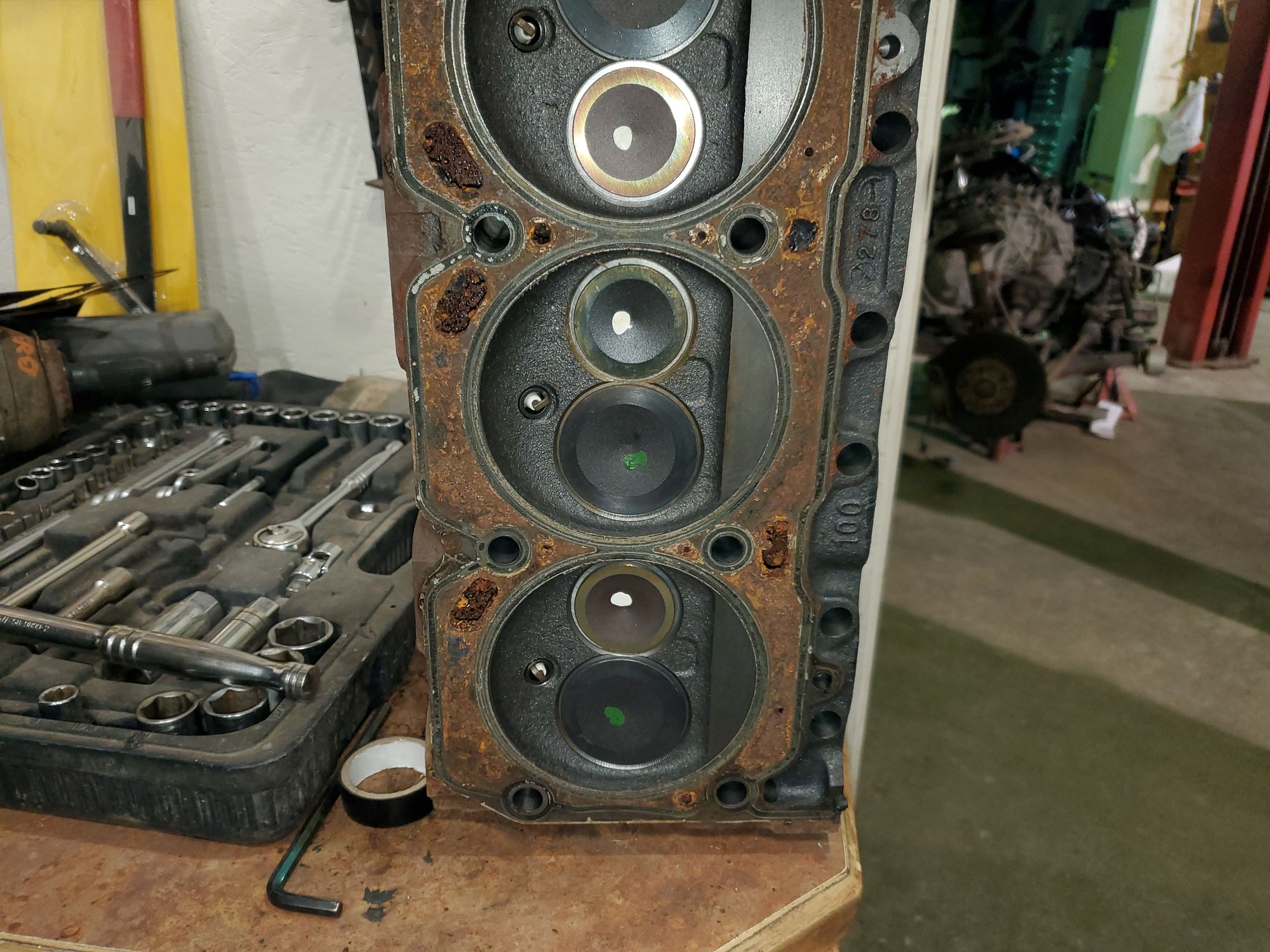

Post a pic of the tops of the original pistons…and the part number on the distributor
just because someone bought it to put in a boat..doesn’t mean it ever was a marine engine. By the looks of the brackets and water pump..it was from a car originally….or going into a car

Pistons are I believe the smaller dish high compression pistons, I measured them at I think about 14cc.

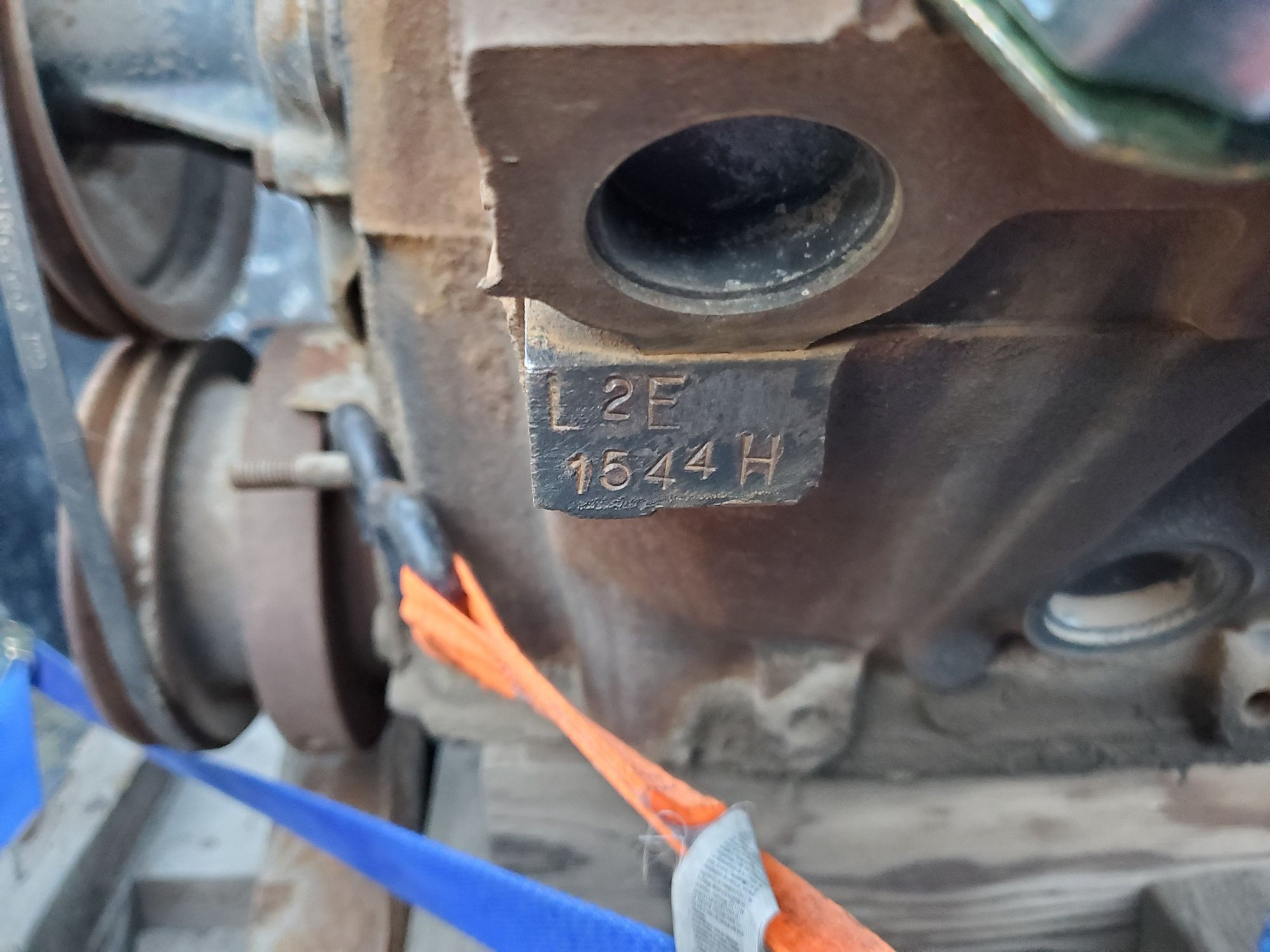

"just because someone bought it to put in a boat..doesn’t mean it ever was a marine engine. By the looks of the brackets and water pump..it was from a car originally….or going into a car"
It was absolutely a marine engine, i have no doubt of that much from the research I've done. The L2E and the lack of a vin on that side pad indicates marine engine. Ive been cross checking part #'s and paint marks with info I found in the engine assembly manual and everything points to it being a `marine spec motor, The bigger intake valves, high comp pistons, the 409691 cam and the fact it came with a flywheel pretty much clinch it. And if that's not enough evidence I found a number stamped on the starter pad that corresponds to a Engine Assembly part number that proves it.
Theyre advertised at about 13cc or so. HOWEVER they’re .030 shorter than most others so that’ll lower compression. Gotta figure that in too.
looks like a factory piston

L on the pad only means it was a service replacement block from GM. The heads were probably put on by whoever bought it. All service blocks I’ve had here are stamped starting with an L
I have one here right now.
It has a pretty big space between the valves for being a big valve head. It’s looks like a 2” intake ?

how big is that gap between the valves?
I hope you’re not gonna run away because you don’t like the answers you’re getting here.
the lack of a vin as you say, does not automatically indicate a marine engine. What yours has is a number stamped as a service replacement engine, which has no significance unless you have some kind of paper work to go with it. there is no rhyme or reason to those numbers that anyone can prove. It’s like a work order number , that’s all.
I’ve come across a few service blocks and still have some. The numbers are hand stamped by a person as they get built..they start with an L , some have the numbers upside down, some are 3 numbers, 4 numbers or 5 numbers long.with a letter or without.
original marine engines supplied by GM do have serial numbers, just like a car. that’s how GM kept records of where engines went, the date and engine specs. Those went to Berkeley, Hardin or one of the other marine builders where they added the marine stuff like , water pump or block off , marine fuel pump and marine carb, alternator etc
I know that because I bought a jet boat in the 90’s off the original owner that still had the original engine. I still have the boat and the marine survey/appraisal from back then which lists all the serial numbers, including the one on the engine. . It was the 330 HP H.C. engine. It’s a 1974 SeaRay SRV 190 that had K heads.
it’s and old wives tale that marine engines had that L stamp on the pad

The 'L2E' is the designation for a Service Replacement Engine Block.
