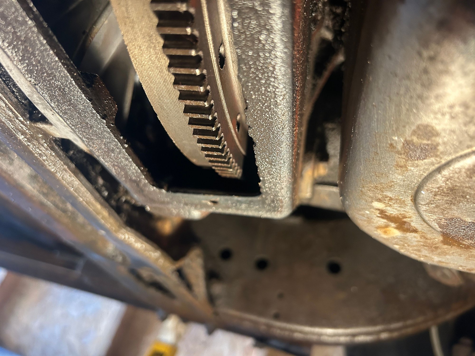

Can anyone tell me where you think this oil drip is coming from? The leak of oil seems to be coming from the plate pictured. Any info on what the area is, how to fix the leak, etc. would be greatly appreciated. Thanks all.
Old May 16, 2025 | 06:57 AM
Oldsfan's Avatar
Joined: Jul 2006
Posts: 331
That's either blowing back from somewhere else and collecting there, or you've got a transmission leak. I'd pull that cover and see what the front cover of the trans looks like. There's an input shaft seal and a couple of valve seals in that cover that might be leaking.

It's too clean and slightly red to be engine oil.
I would say it's probably a front trans seal.
It's an easy job to replace, after you have the transmission out.
While you have the trans out, check the damper.
If the springs are loose, replace it.

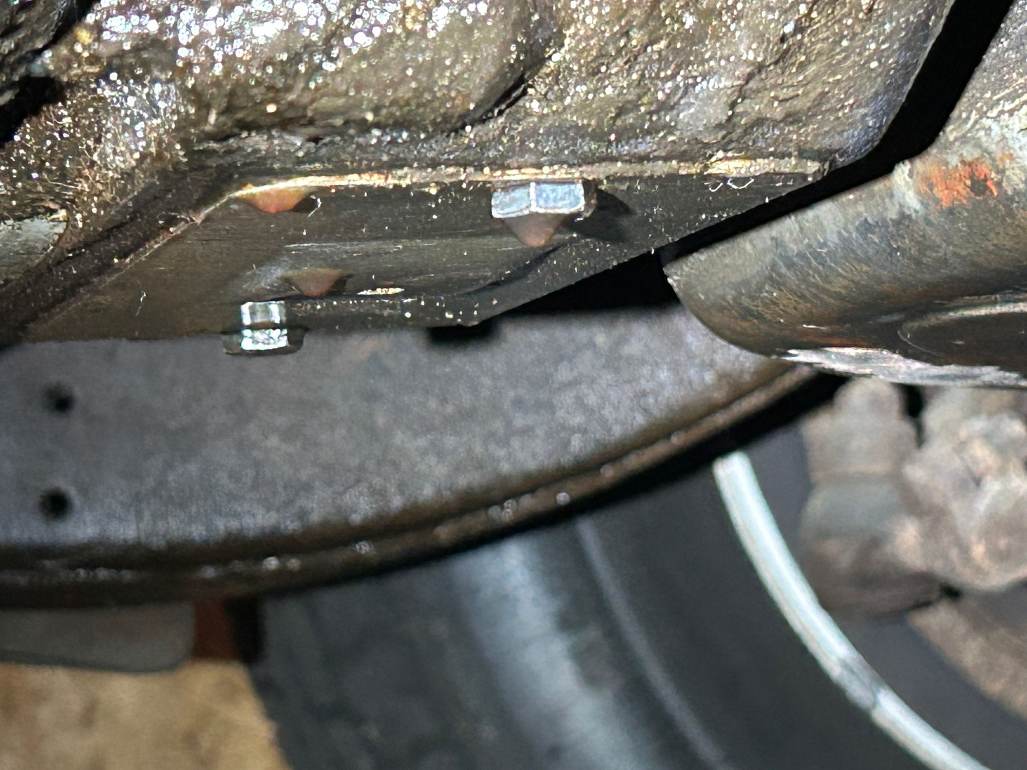

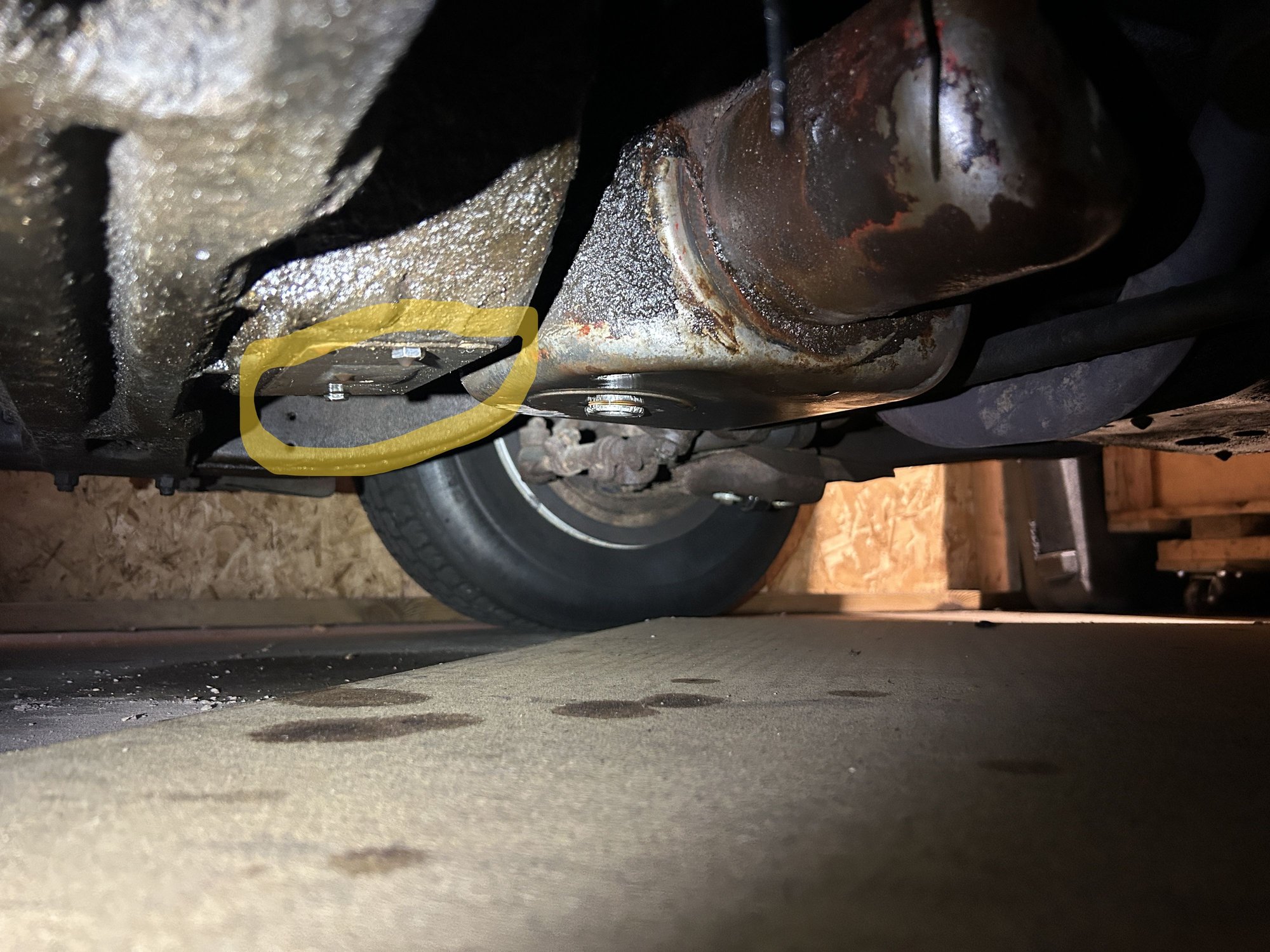

I attached a picture of what appears to be the source of the leak, but I’m not sure. I took that little inspection cover off and it seems to be an inspection cover for the flex plate. Let me know your thoughts.
Leaking maybe from that bolt?

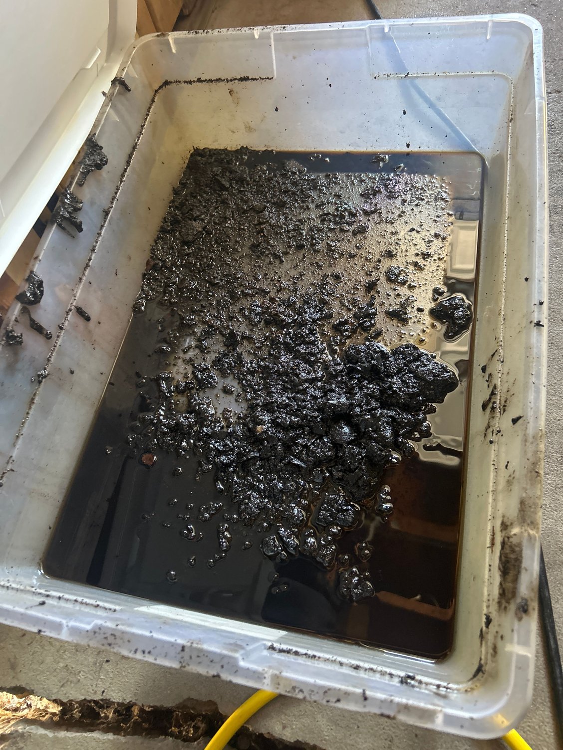

I agree with you Norm. I’m going to pick a bottle of this up and start there. I’ve actually started the cleaning up process, as the under carriage had LOTS of hardened gunk / oil caked all over. It’s probably been there since the late 80’s.
This is just some of the funk I chiseled and scraped off from under the car around the block, oil pan, filter, and maybe the engine cradle.

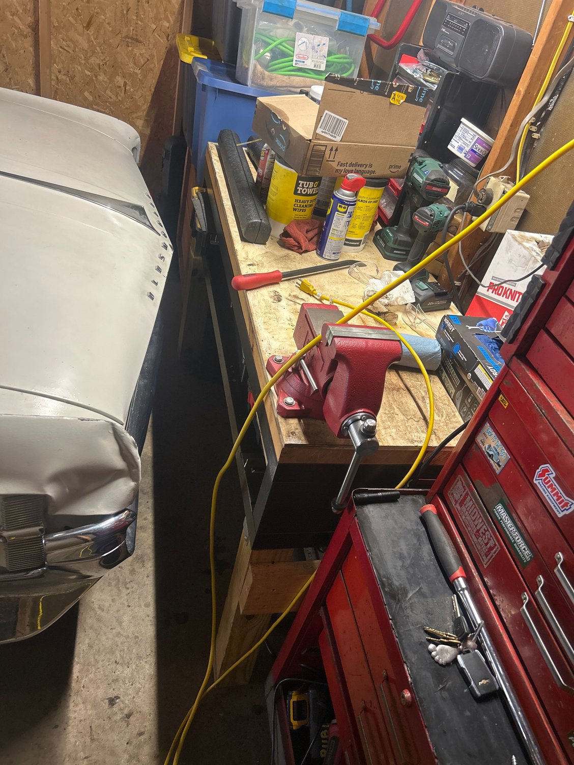

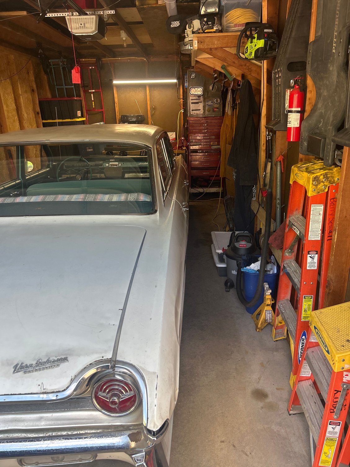

Thanks for the info. Gonna head to Walmart soon I think. I’ll grab a long sleeve shirt or two as well.
Not a lot is space for the Olds, but I make it work here in the garage.

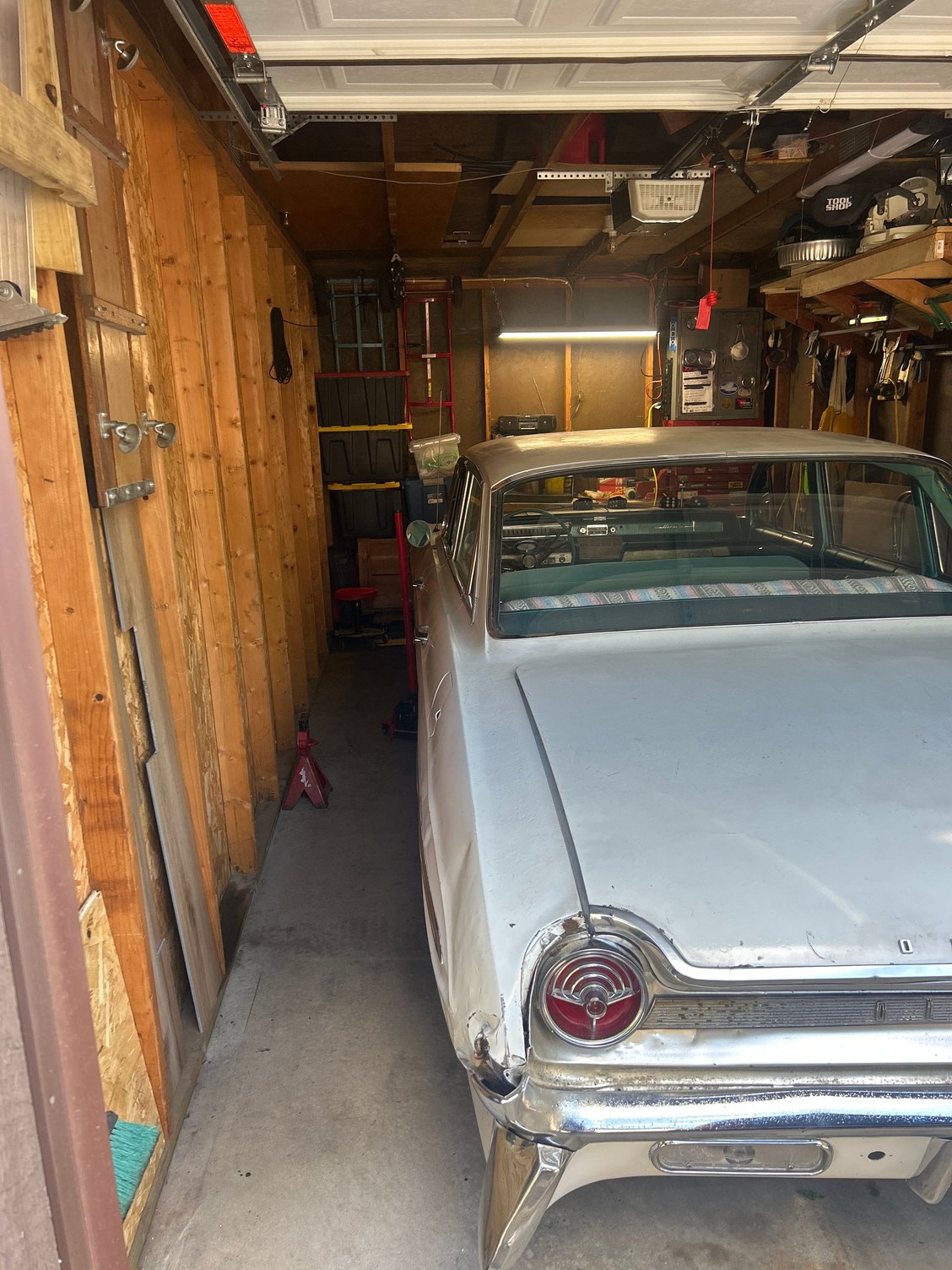

Mike - All types of room in there.

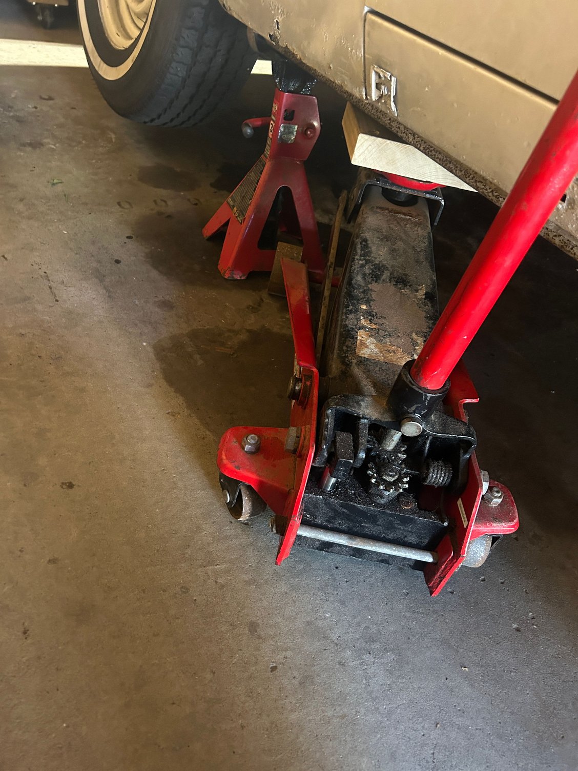

Can you get the beast up on jack stands? I see a roller dolly hanging on the wall. You have a floor jack? (Shopping list)
NOTE: Four jack stands would be far better if you can swing four. Make working on these things as comfortable and safe as possible.
You bet I do. And this red jack stand, plus two others.
Old May 23, 2025 | 02:32 PM
Posts: 26,014
Sweet - good deal-e-o!

I just noted you stated you have a floor jack, a red jack stand plus two others. Viewing your image, please don't use a floor jack as or in place of a jack stand - very unsafe. You pop a hydraulic valve, clamp breaks, etc. that's a serious event. Get another jack stand.
Old May 23, 2025 | 03:32 PM
eggydrummer's Avatar
Joined: Jun 2022
Posts: 378
From: Eden Prairie, MN
Thanks for that Norm. Picking another one up before I get under the vehicle, there will be 4 stands total, plus the jack itself.
The greater possibility is that the oil is accumulating on the bolt because of a leak above it.
It's the lowest point.
Most likely the transmission input shaft seal is the culprit.
It certainly won't hurt to try some of the dye recommended, however it must be viewed with a "black light". (ultraviolet)
After cleaning it of course.
Have you driven it regularly enough to notice a loss of trans fluid?

That is the plug for one of the valves in the pump. There are two of them. They both have an o-ring. That one looks like the pressure regulator. Mine leaked there. It was very tight, but I was able to replace mine through the inspection hole. I used and had ratchet and it took forever to remove and install because the opening doesn't allow much movement. A power tool would probably make it a breeze.

So, I think I located the leak using the UV dye, and it seems to originate from that inspection cover, where those plugs are. There is also a small oil leak coming from the oil pan drain plug. I changed the oil about 2 weeks ago and used a brand-new copper crush washer. I didn't want to overtighten it, so I torqued it a hair more to see if that would stop the small leak. It did not. What is recommended for that leak coming from the drain plug for the oil?
Also, at this point, I probably won't be removing the transmission to inspect that other leak, not quite sure what to do from here.

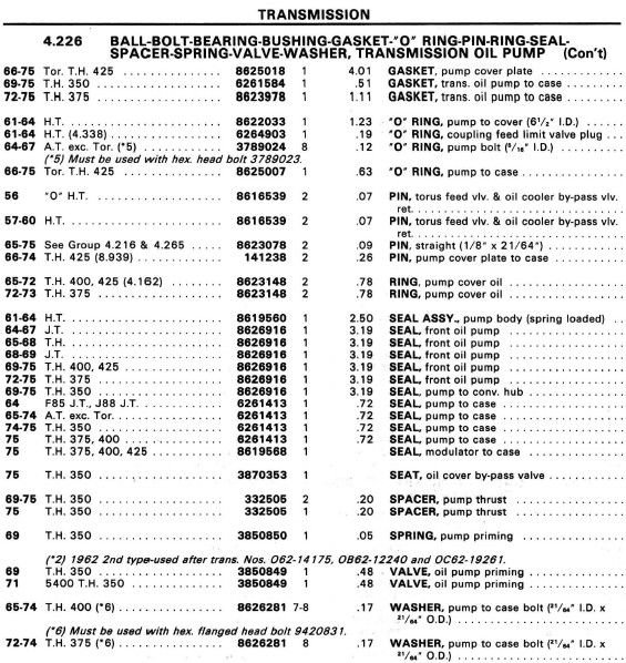

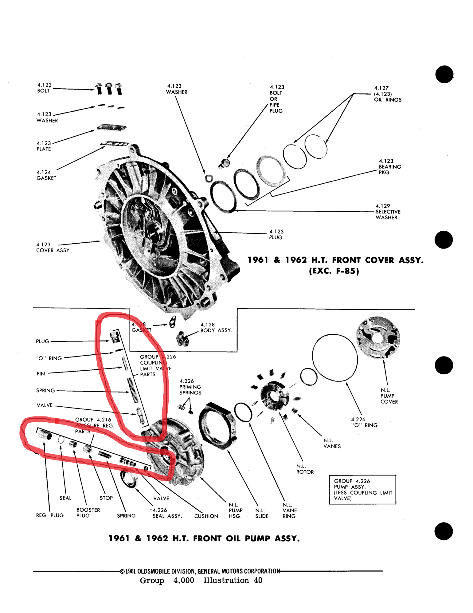

Any idea where I could come up with that plug? I was thinking, is it possible that the leak is the coupling limit valve? The head on that part looks more like the one in the picture I posted of the leak.
Old Jun 6, 2025 | 06:32 AM
  #32
Oldsfan's Avatar
Joined: Jul 2006
Posts: 331

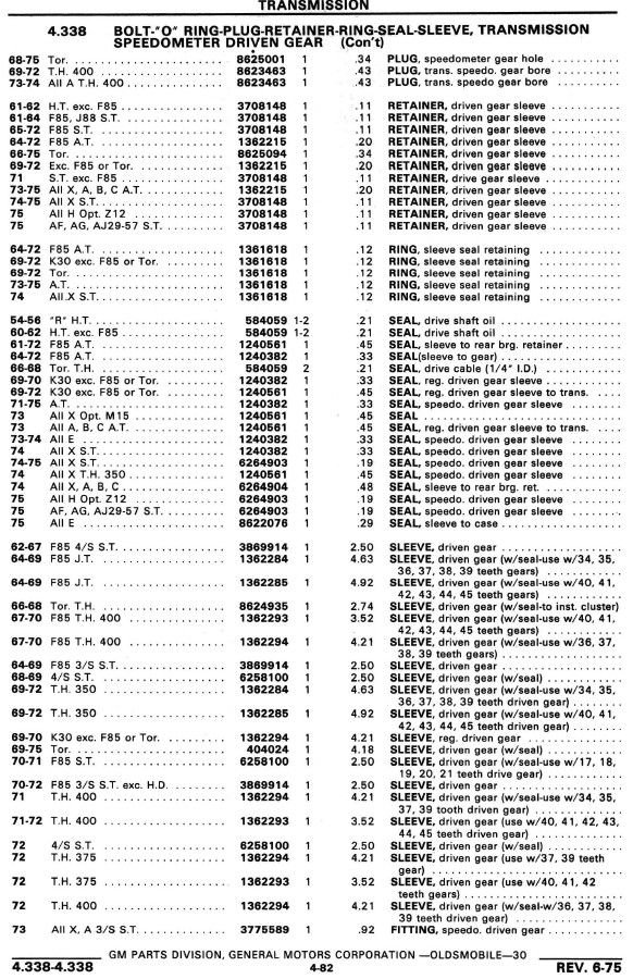

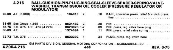

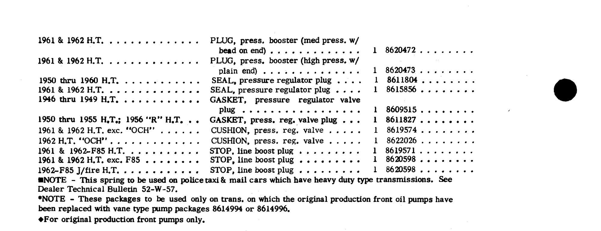

I don't think your photo is of the coupling limit valve - I think it is the pressure regulator. I don't think you can see the limit valve from through the inspection cover like that. It is more on the top. You don't need to replace the plug, just the o-ring on the plug. I'll see if I can get you a part number.
Old Jun 6, 2025 | 07:04 AM
  #33
Posts: 26,014

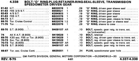

Oldsfan - I'm out of my league here, just thought I'd puke up the part numbers as talking points so you might validate & I can save you the searching, maybe?
Old Jun 6, 2025 | 09:47 AM
  #34
Oldsfan's Avatar
Joined: Jul 2006
Posts: 331
Close. We need group 4.216.

  #35
Posts: 26,014
Roger that.
Old Jun 6, 2025 | 10:14 AM
  #36
Posts: 26,014
I'm useless in this case...my parts manual jumps from page 4-56 to 4-59. Appears not to contain 4-57 through 4-58. I might find another parts manual in my library & I'll look later if you haven't found the P/N.
Pretty sure this image is useless....
Old Jun 6, 2025 | 11:40 AM
  #37
Oldsfan's Avatar
Joined: Jul 2006
Posts: 331
Part #8615856. No longer available. Having a spare transmission and working in a dealership parts department, I took the plug from my spare and matched it up with one from my bulk o-ring stock.
Old Jun 9, 2025 | 06:37 PM
  #38
Joined: Jun 2022
Posts: 378
Wondering if I am able to get the plug out, if I can just try and match the o-ring / seal with another one as close to it as possible?
Old Jun 11, 2025 | 12:01 PM
  #39
Joined: Jun 2022
Posts: 378
This must be it...and I went ahead and bought it. $15 free shipping on the way today.
GM Transmission Pressure Regulator Valve Seal Part # 8615856 - NOS | eBay
Old Jun 12, 2025 | 08:13 AM
  #40
Oldsfan's Avatar
Joined: Jul 2006
Posts: 331
There ya go. NOS rubber parts kinda scare me. I had an issue with control arm bushings once. Hope it all works out for you.
