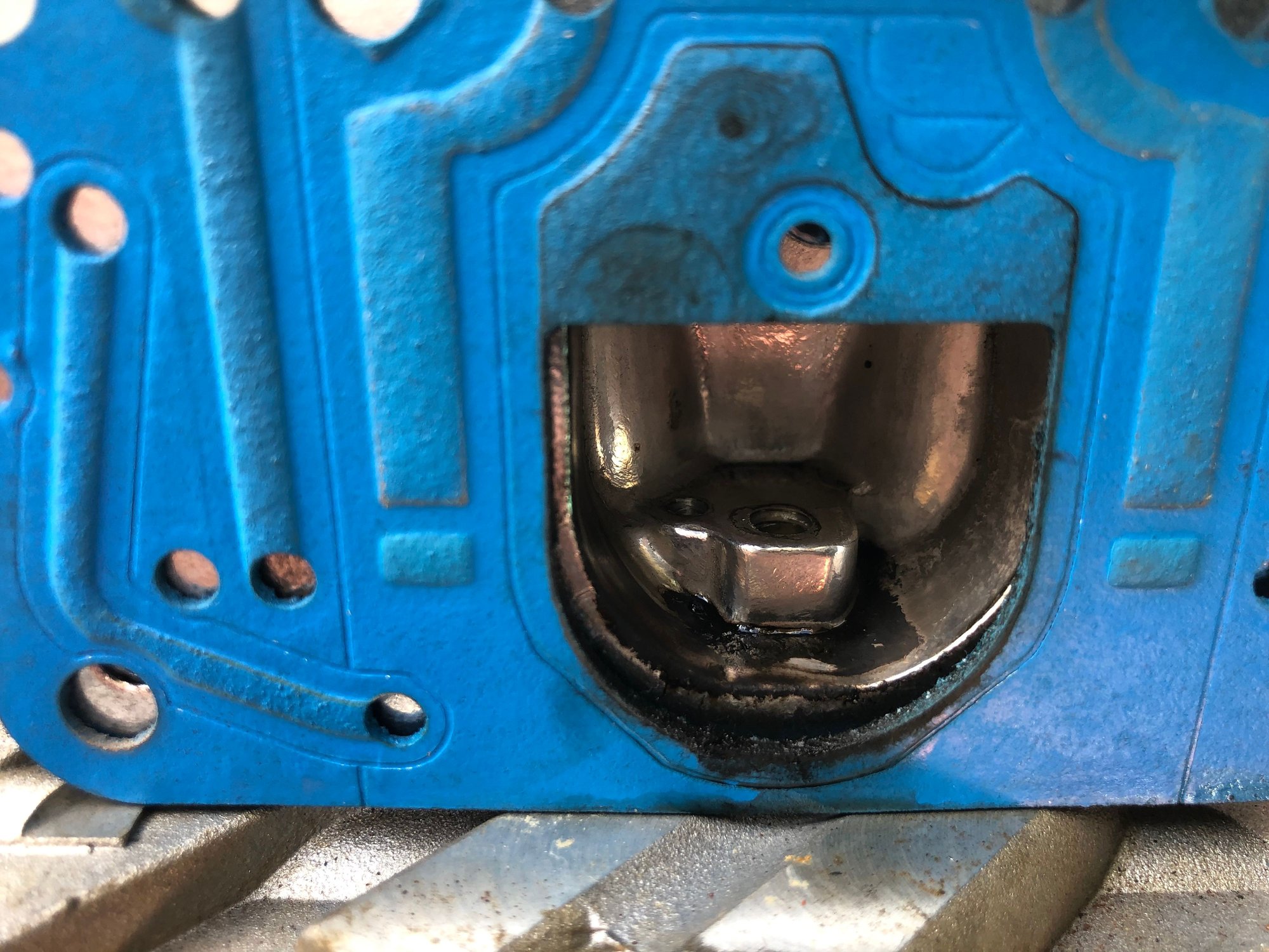

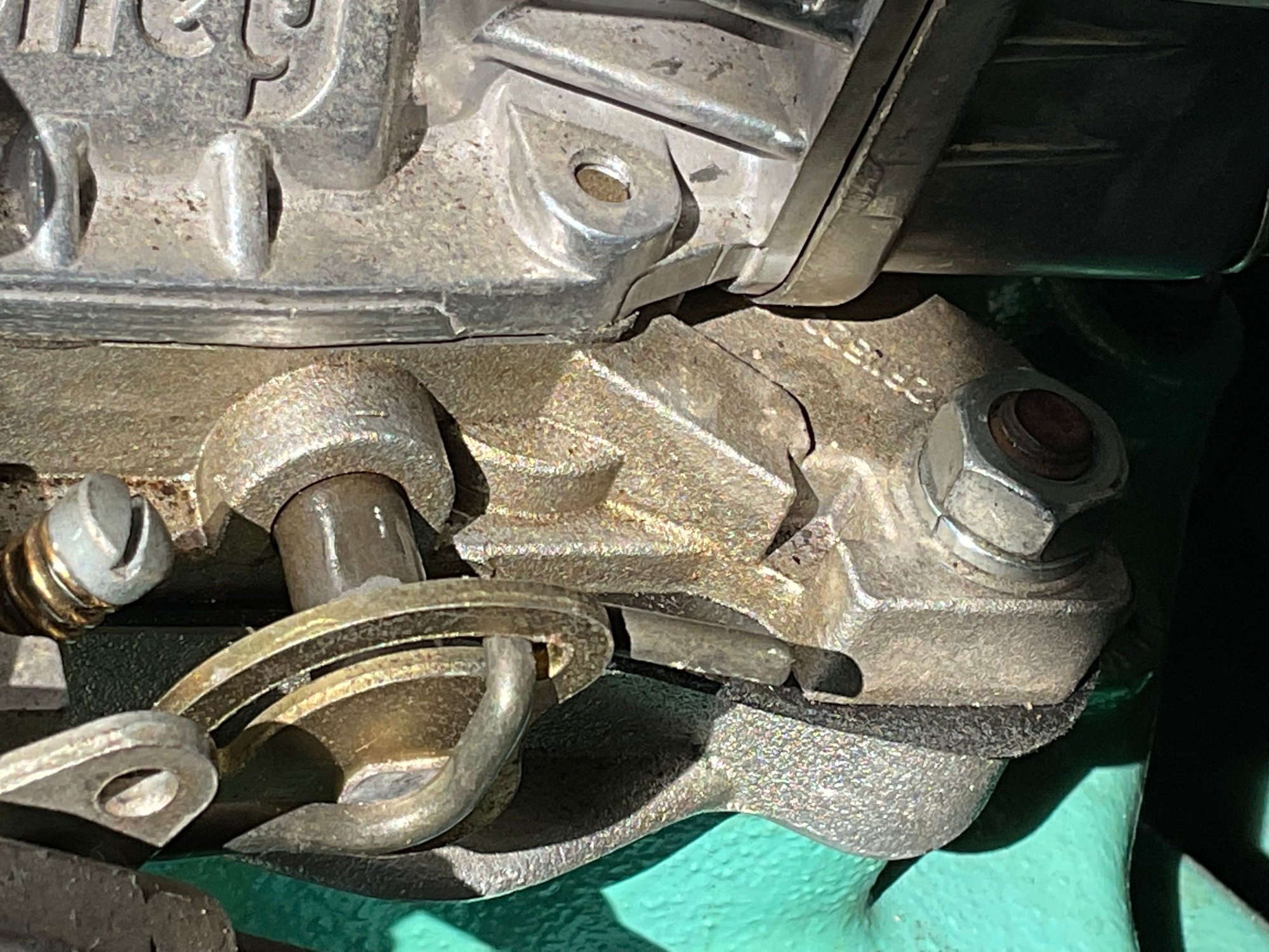

tried starting her up this morning when it did finally go went a few metres and stalled. Now have fuel leaking from baseplate and that shaft I zoomed in on.
The Holley was on my old 394 for about eight years with no issues but was sitting unused for the engine change about 5 months or so. So trying to get her going again to get it to the assessors from when a car hit the rear fender.
Any ideas on what has happened here?
Cleaned the needle and seat on the front bowl was a bit of crud in the carb filter so I’ll do the rear bowl tomorrow.

If you had the Holley on another car for 8 years it's probably due for a rebuild. It's not uncommon to have to crank a carbureted engine for a few seconds before starting to refill the fuel bowls. I always give my 71 3-5 seconds of cranking before I step on the gas pedal to set the choke and activate the accelerator pump.
Old Sep 24, 2023 | 06:40 AM
Sugar Bear's Avatar
Posts: 4,109
It is likely dirt on the other needle and seat

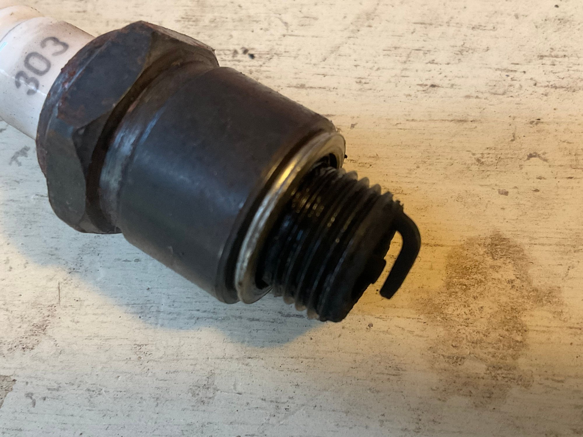

Would I just take all the plugs out or is there some way to dry the fuel up in the engine?
Four rear plugs dry a bit dusty and four fronts are wet. Black soot when attempting to start up and the other day when I nearly did start it sounded awful like running on half the cylinders.

John - I have minimal experience w/ Holley. Appearance of your spark plugs (black, sooty & wet), coupled w/ leaking fuel suggests a rich A/F mixture &/or your float(s) (primary & secondary) need adjustment. Did you measure your vacuum and adjust your A/F mixture (idle mixture screws) after you installed the Holley on this engine? Does your model Holley have the primary & secondary fuel float bowl level adjustments with a sight glass? The car might well have stalled from a flooded condition.
What model Holley carburetor is it?
Old Sep 25, 2023 | 03:13 AM
Posts: 26,056
BTW - I'd begin with a brand new set of spark plugs set to the proper gap. There's a great deal of black soot all over those plugs. Yes, you may be able to wire brush clean them & that's an option, but the electrodes are very sooty (from a rich fuel condition).

This carb is the Holley 600 cfm with vac secondaries no sight glass on this one. Having it apart today there were two floats one either end.

Agree on your point re new plugs I just cleaned the lot I am not 100 percent happy the ceramic is very discoloured so new plugs coming up.

You mentioned you disassembled the carburetor. Did you rebuild it with a kit, or just blast out the internals with carburetor cleaner? The needle & seat, accelerator pump cup and power valve are all parts that wear and new ones are included in a standard carburetor rebuild kit.
x2 on replacing the spark plugs if they're super sooty and discolored.

yes pulled it down only a little to clean both needle and seat sets and cleaned with carb cleaner. The power pump kept vacuum but the accelerator pump?
Didn't look at that too thorough though.
No kit put through I just apart to inspect and clean.
