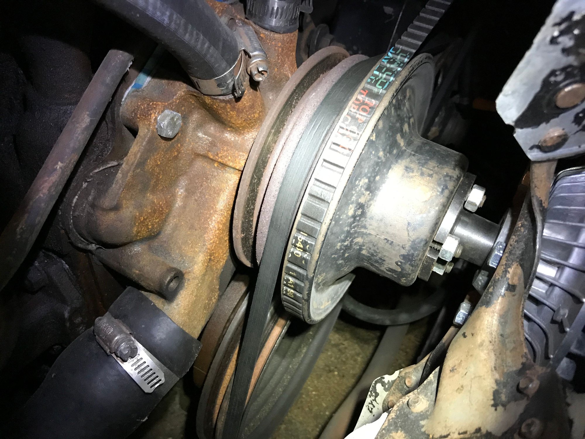

Hello all, hope this is in the right place. So I did an AC delete, and I was looking to get a two groove pulley for the water pump, so I went to my local NAPA and ordered one. Come to find out it was too large as it was grinding on the crankshaft once installed, so I exchanged for a smaller one. Low an behold (as is always with working on a car) this one too small. Like an idiot, I threw the original one on without measuring and I’ve had to deal with belt squeal off and on ever since. I have an Olds 350 Delta 88 Royale and was wondering if anyone has found one that works; and if so, would you kindly point me in the right direction? Not to sound like a smarty pants, but I am sure the belts been tensioned properly each time, but the belt squeal is still present. Any and all helps appreciated as always, thank you...

Sorry for the late reply, but @cdrod , that seems way too big. I believe @Allan R was right as those are for older models. @69 Hurst , i believe yours in more in the neighborhood i’m looking for. I havent been able to pull it apart yet as its my daily, and I dont have a day off until Friday.
i doubt these will help much, but about this size. I appreciate the help all, and @69 Hurst ; let me know what you think. Id say they may be close, but the problem ive had is the actual pulley size is okay, but the fan bolt holes are too close together.

Why can't you just source out some new belts that fit the existing water pump, crank and Alt pulleys? That's what I ended up doing. I do have a smaller 3 groove pulley (code KE). Here's a link to it's thread. See if it will help you with your project. It's much smaller than the ones already in discussion. Water Pump Pulley KE
I did downsize my power steering belt, though not the alternator because I didnt think it would be affected. Did i misguess ?

When I downsized my WP pulley (required when converting from standard to HD cooling), I needed to change out both PS and Alt. You said you had AC on the car so you might be able to get away with only one belt change.
