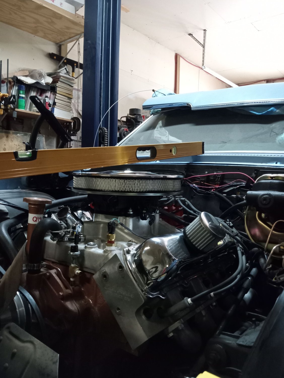

I believe I have solved my issue with air cleaner clearance on my car with Holley 4150 EFI and Edelbrock performer RPM intake! I bought a drop base and a 1/2" spacer and it seems to have enough clearance now. I needed the spacer because the drop base would not fit with out it. The true test will come when I install the hood!
Looks to me like your straight edge is showing the top of your hood, not the underside.
Old Aug 30, 2022 | 12:15 PM
Posts: 16,688
Yeah ... better hope your engine is balanced and the mounts are in good shape, because it looks like it's gonna be pretty tight to me.

yea I know! I am hoping that the hood has a little crown for some more clearance. i have not put the hood on yet because I have some more work to do, but when I do I will lower slowly and put some clay on top so I can see just how much room I have, if any.

The engine is balanced but I might have to weld some straps onto the mount or put a cable from engine to frame like I did on my 65 Stang but I will wait to see after I put my hood back on!
