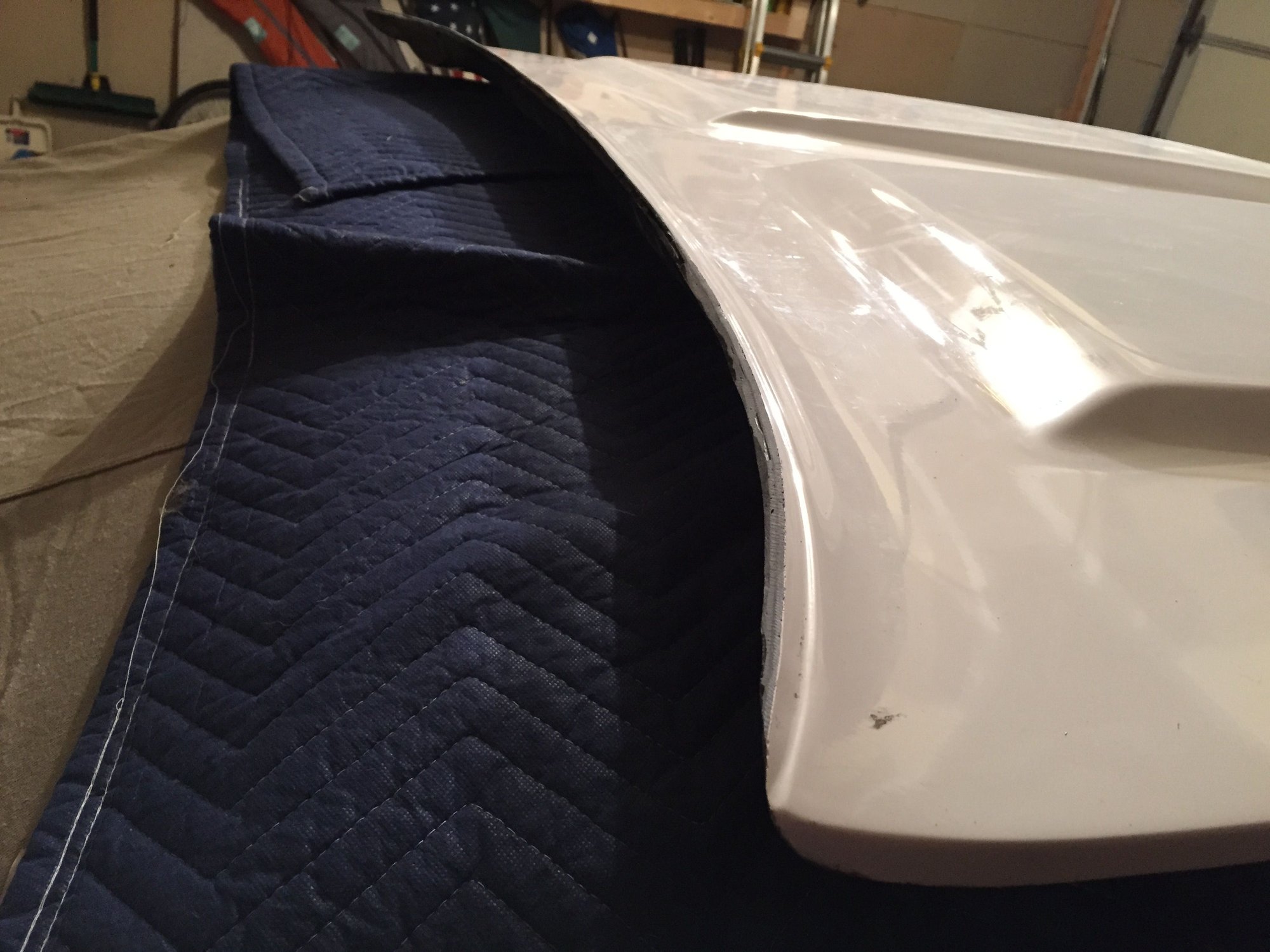

A few months ago I decided to buy a W-25 hood for my ‘72. After a ton of research and reading I landed on a Fiber Concepts hood. I made a few calls to the owner Rob and he generously spent a lot of time with me answering all my questions. So I went ahead and ordered one from him. I felt good spending $1200 for a hand-built hood that would need less prep work than the Glasstek that didn’t seem to have as good reviews.

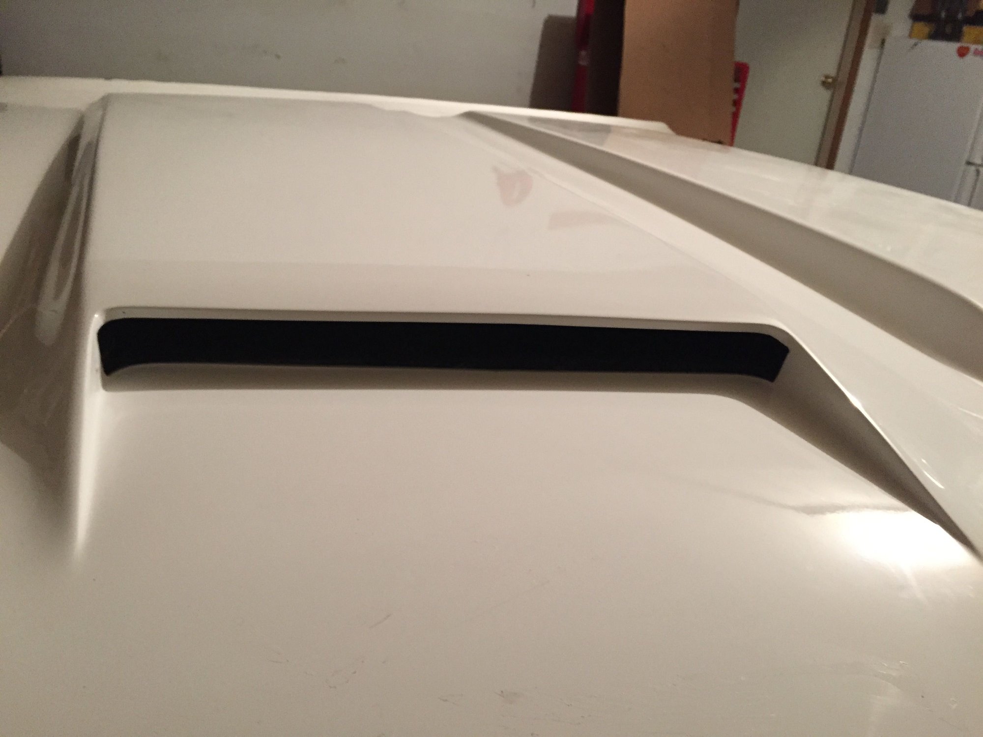

The body shop I had do the work is an extremely respectable place that I’ve had do work on other vehicles for me and the results have always been terrific. I know the owner well enough to trust him with any work. The hood arrived and the shop owner called me to come look at it. He pointed out quite a few things that were going to have to be fixed on it and several fitment issues (my car was already there at his shop so he had it mounted before I got there). The sides didn’t match the fenders, the front edges were way off, the scoop cutouts were jagged and didn’t match each other. We looked it over and he said it would take more work than he had expected but if I wanted to go forward he would make sure it turned out great.

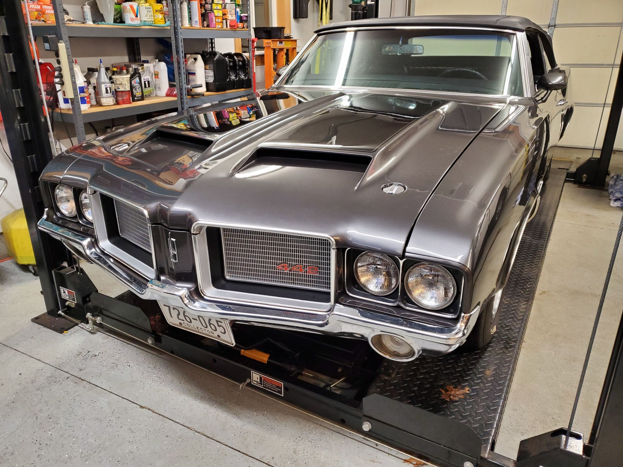

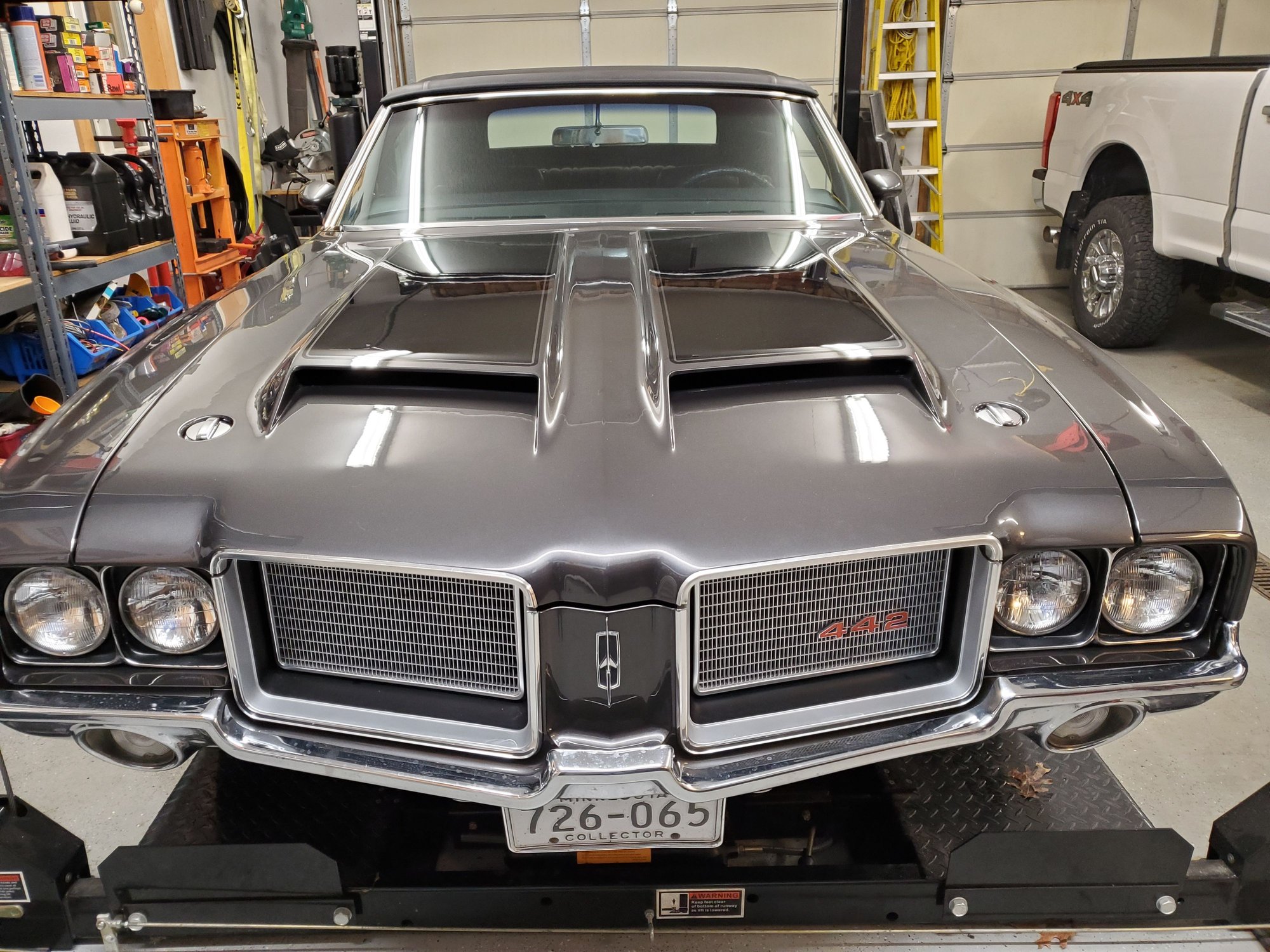

he called me yesterday and said the car was finished. It looks and fits good, but it ended up costing me $4600 to get it that way. Pretty unhappy and disappointed with my purchase.
He ended up putting over 50 hours of labor into fixing and fitting the hood to make it right.
would I do it again? No way. Was not worth $6000 to add this hood. Wishing I had tried the Glasstek or searched for an original steel hood.

Did you take any pictures of the issues?

Awesome job, there are other stories on here about how bad the aftermarket W25 hoods fit, Thornton price sounds high until the bill is presented to fix a bad fitting glass hood..

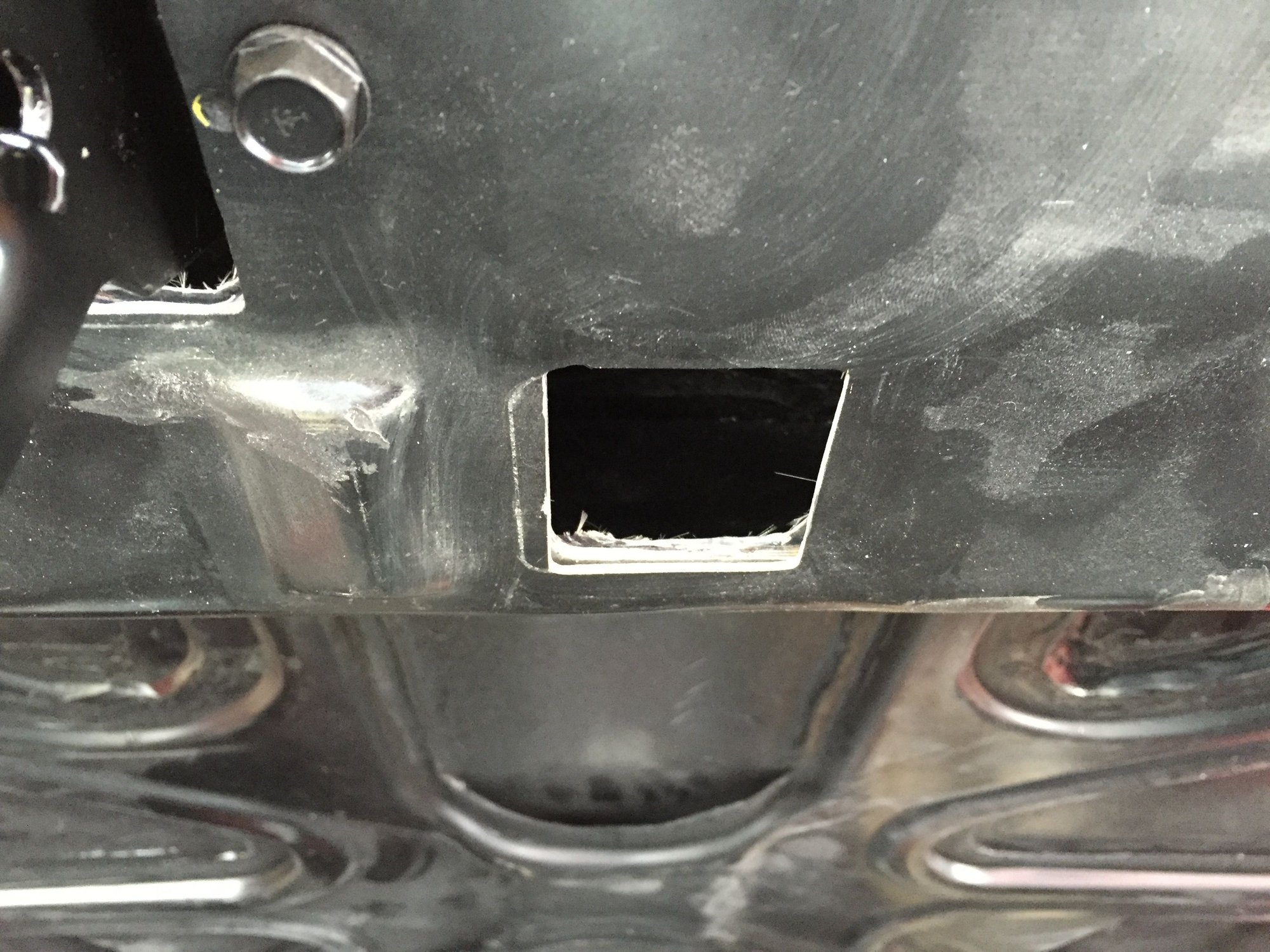

The hood looks great! I’m sorry to hear about the ordeal (and money) you had to go though to get it right, and your not alone. I got mine from Fiber Concepts about 3 years ago as well and it came with several issues. There was high spots on the top side from glueing the air box together, the intakes were all messed up, the underside was VERY sloppily finished. Also the hood latch section didn’t line up and had to be cut correctly. The fit was ok I guess with the exception of the middle front section. I talked to Rob about the issues, and he ended up giving me money off. At about the same my neighbor got one from Thornton’s and he just basically just painted it and bolted it on. He also got a free OAI air filter intake with his purchase.

Minnnesotajeff - sorry to hear about the hassle but the end result looks amazing! Do you mind telling a fellow Minnesotan who did the bodywork/paint and the name of the color you chose for the exterior? It's really a striking color.

Hi Terry, It is Shannon’s Autobody in Brainerd. The color is the original color of the car. It is called antique pewter and is code 18. I love it also, it looks gorgeous in the sun

Your car is Gorgeous!!
My OEM hoodwas pretty darn straight and it still needed a day and a half worth of touching up.Since mine was original I'm glad I kept it and very happy with the results. We have all had nightmare body shop issues. My body shop took off my fenders, ordered repos and when I told them to reuse the originals they said they already had the junk guy take them away. They had a few leaded areas on them but were orignal flat style fenders and then the body shop admitted in the end that it took them more time to straighten the repos than it would have to reuse the originals. I'm still upset over that 12 years later.
