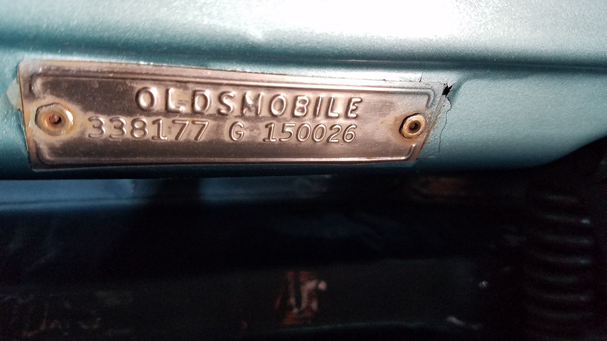

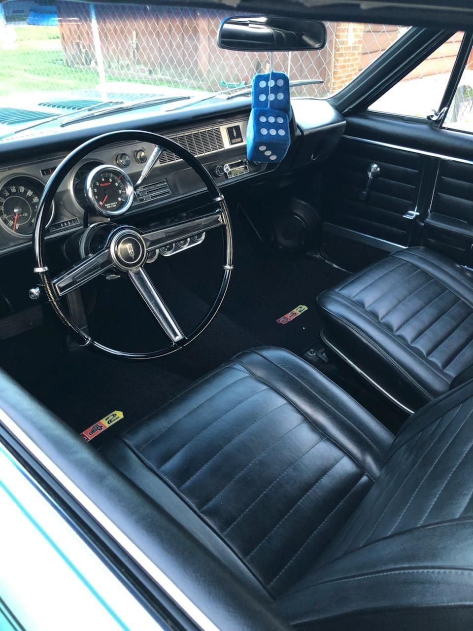

For anyone that has not seen my previous posts, I have only owned the 67 442 in the attached picture since 19 November of this year. I have a unique question, that I'm hoping the experts on this site can weigh in on. When I was reviewing the car before purchase, the owner told me the transmission was the TH400 first available in the 67 442s. On the cowl tag (pic attached), in the "Accessory" section, the 2nd column identifier is "Z", which is the identifier for the 3-speed TH400. You will notice from the attached picture of my dash that my shift lever is on the column. If you blow the picture up and look closely at the gear indicator area, you will be able to see there is a "D" position, and an "L" position, but there is no "S" for 2nd gear. Can anyone explain this to me, I am 99.9% sure I have a TH400 transmission, but can't explain only two forward gear positions (D and L), in the dash indicator box?

Nice car! Since your car was restored it looks like someone may have swapped the dash bezel with one from a Cutlass which would have just the 2 spd (jet-away) trans, maybe the original was cracked or the finish was bad. It could be from a '66 also. All '66s,even 442s used the 2 spd trans. Can you "feel" the detents for all 3 of the gears in the column,does it shift 3 times when you're driving it?. Can you get a pic of the trans pan & put it up on the site?? I'm sure someone on this site has an extra indicator lens or a bezel that you could buy.

As for whether the 67 442's had an option for the TH400 tranny, there are numerous trusted sites referenced by this forum that document it was available on the 67. As I mentioned in my original post, this is backed up by the 2nd Accessory Column on my cowl tag which has the "Z" code denoting my car was optioned with the 3-speed TH400.

The "5V" on the cowl tag proves that this is a real 442 (well, at least the cowl tag came from a real 442...). The tag in the photos does not look like it's been tampered with, so we'll assume it's original. The TH400 was the only AT offered behind the 400 motor in the 442 that year. If you have the Protect-O-Plate, the trans unit number should match the one on the P-O-P. "2Z" is the correct ACC code for a TH400 installation. Note that the shifter gate in the column is different for a Jetaway vs. a TH400, so assuming the shift gate properly accesses all three forward gears in the trans, it is likely that the dash bezel was replaced with a more common one from a 2spd car at some point in the last half century.

Thank you for the informative and detailed response. As usual, you are a valued and trusted source of knowledge on these cars! Unfortunately, I don't have the P-O-P for the car. Since this thread started, I went out to the car and verified the shifter accesses 3 separate forward gear positions. So like you said, at some point (3 periods of restoration are documented), the gear indicator bezel must have been replaced with the more common 2-speed one. At some point I may reach out to guys on this forum and see if anyone has an extra 3-speed one they'd like to sell. It's not critical to me, because you don't even notice it unless you're an expert and looking for deviations from OEM specs. Thanks again for taking the time to rsvp.
