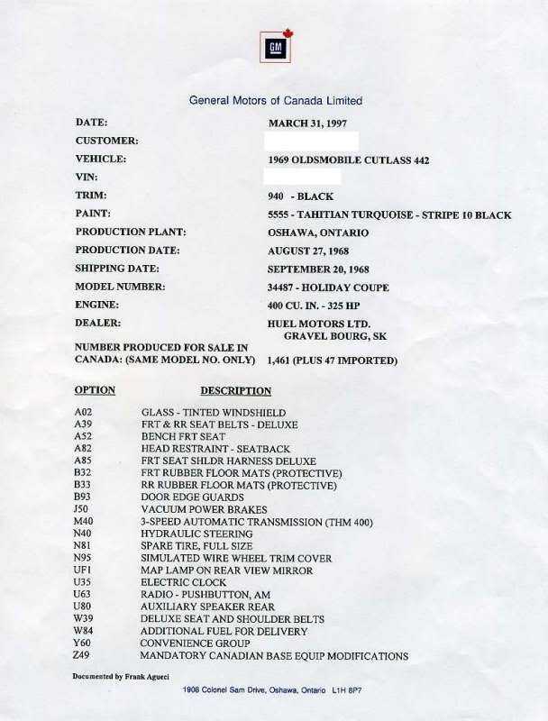

Here is a guy that can get you what you need I had him do a paper on my 68 cutlass He has access to G M documents at the Oshawa Plant it's Frank at 1905-440-7618 his web site is www.vintagevehicleservices.com Good luck

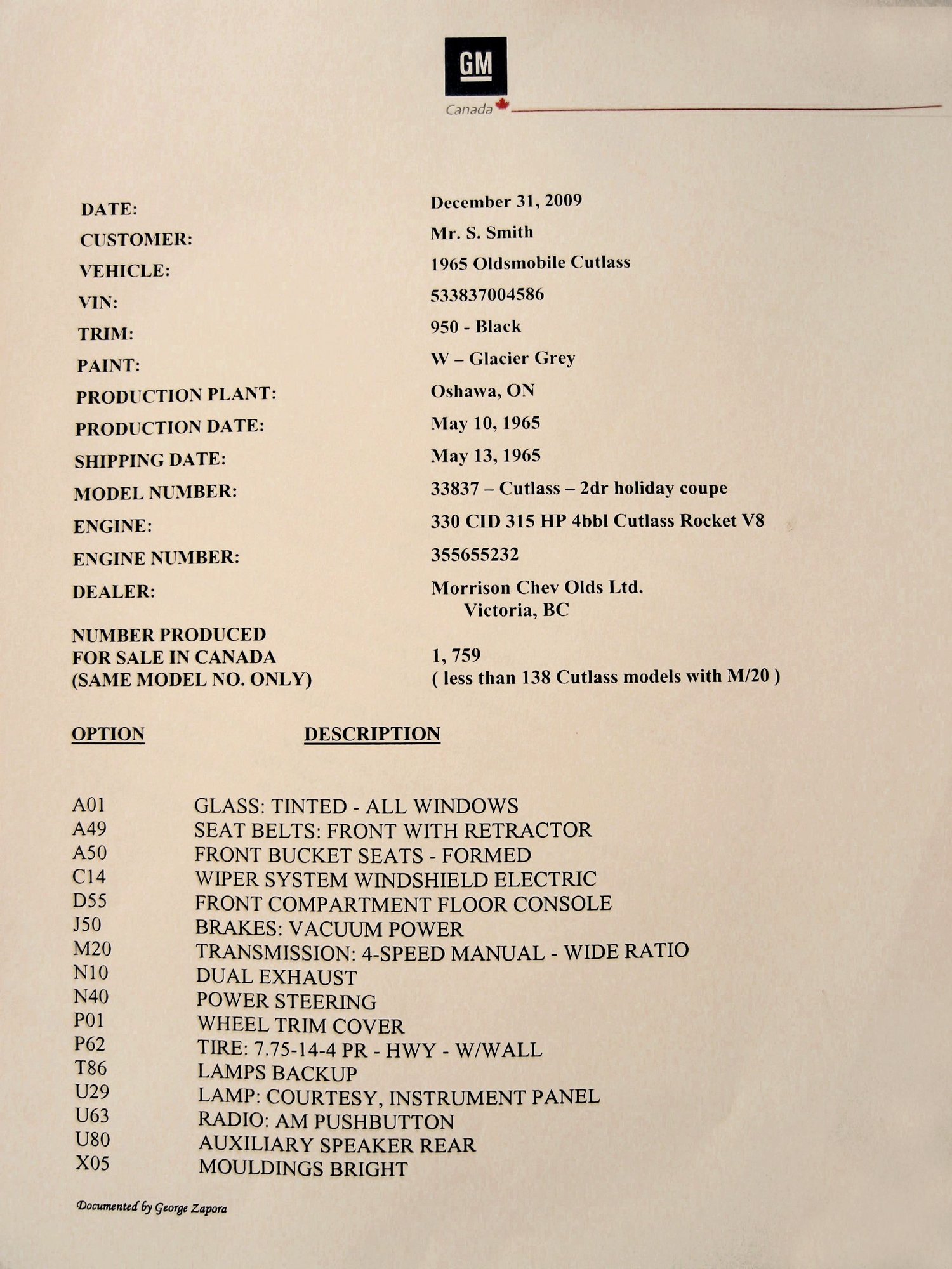

GM of Canada only send you to Vehicle Heritage site and they want $125 for info.

they do charge for the info, when i got my 65 search done i also got options and paint info, key codes etc

those are my docs for one of my 1969 442s now owned by my buddy Randy aka Fred Flinstone.
