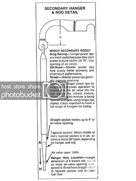

My 71 442 (non-W-30) Auto w/AC with original carb 7041257 has a "J" hanger.

Dang, photoshitbucket ruined it, I can repost if you can’t read, I got the chart from a carb guy here in the D.
it gives you the part number and the 2 letter code. Cliff or Ames sells them.

Here’s more,
