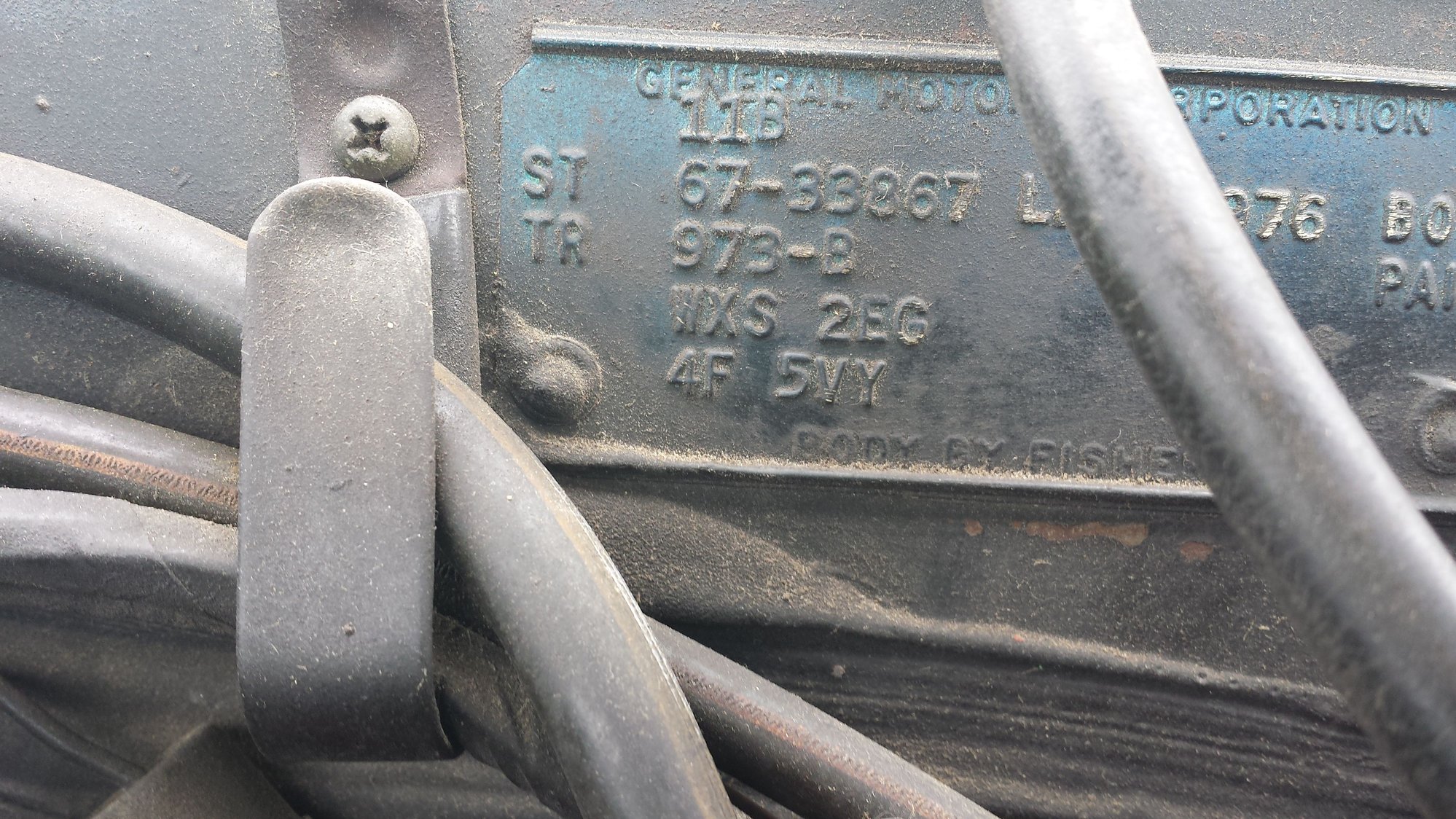

It is a Lansing car with the 5VY code with power windows and A/C. It has the original engine based on the protect-O-plate number, not sure about the tranny. Will try and post picture.

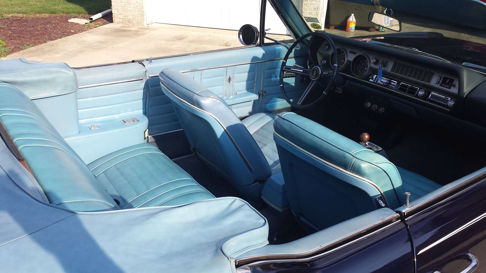

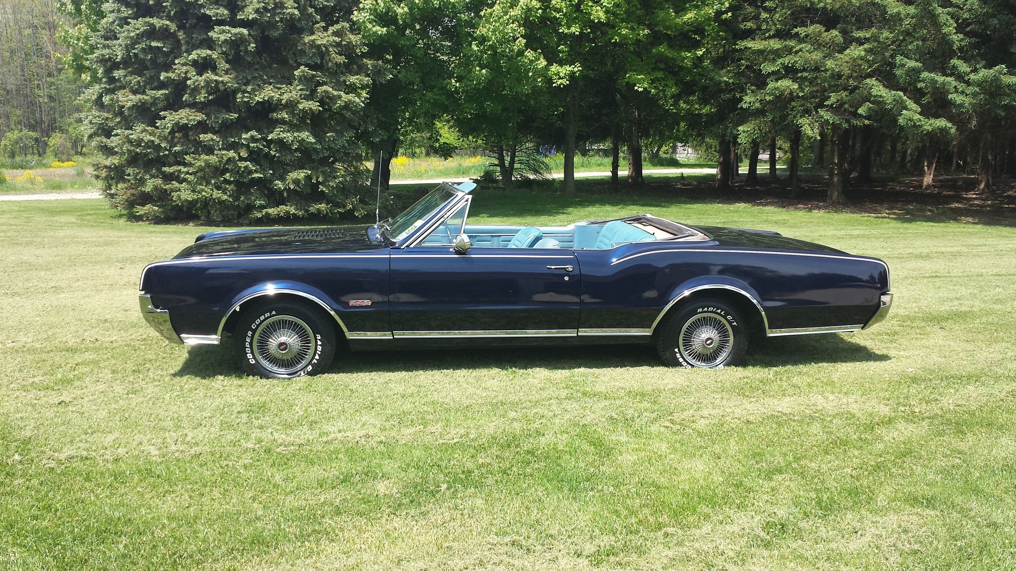

Few pix

Posts: 42,497
Its probably worth in the $20k+ range if its as nice as it is in the pictures and runs/ drives well mechanically.
Old Oct 31, 2018 | 07:21 PM
Posts: 12,806
That is a much nicer car than I thought you described. Eric is correct.

Old Nov 1, 2018 | 04:27 AM
35tac's Avatar
Joined: Feb 2015
Posts: 1,260
From: Medina, Ohio
Very nice. Pictures of the engine bay would be great. Looks like a keeper. Couldn't see the paint code. Looks like Midnight blue. Keep us informed and welcome to the forum. Good luck on the purchase.

Old Nov 1, 2018 | 04:23 PM
TDS_1's Avatar
Joined: Oct 2018
Posts: 14
From: Tallahassee, FL
Thanks to everyone for the input. The paint code is the midnight blue with the light blue interior. I understand the engine code comment but I am getting it at the right price so it's not a deal killer. Hoping for the best. Looking forward to getting the car and leaning on this forum for more input.
