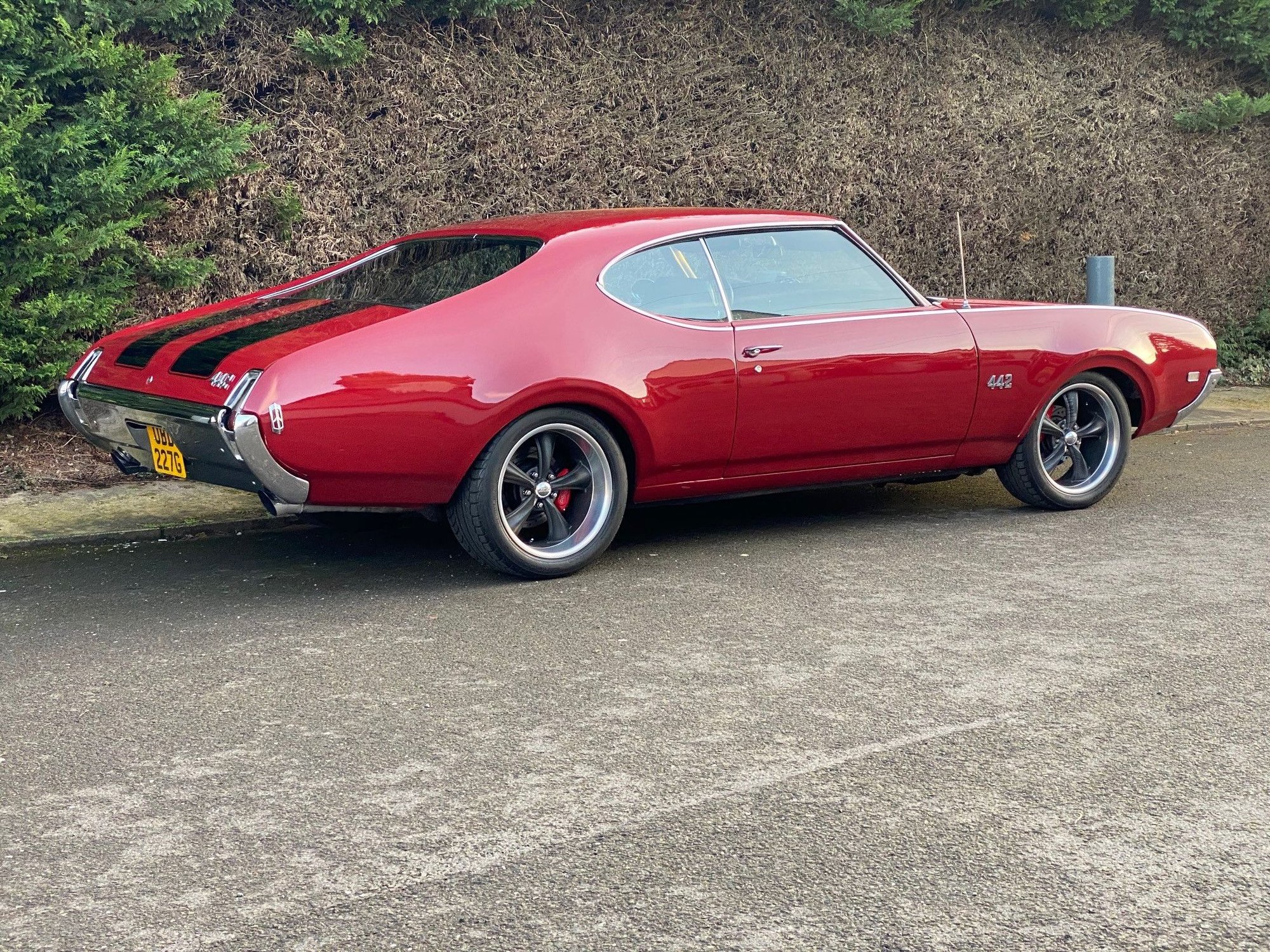

Im running 245x45x18's on the front and 275x45x18's on the rears. They fit the arches well but I have discs alround, not sure if this makes a difference. The fronts rub on the inside when on full lock and I will be adding spacers just not got round to it, the rears can scrub on the arches when someones sat in the back, even my 12yr old can make this happen and I have Hotchkiss suspension fitted so its quite a firm ride.

I dont think going to 40's would make much difference to be honest, from memory its only around 10mm/13mm in height on the fronts and rears, doing it again I'd probably look at 17" rather 18". I am no expert mind but I do like the way they fill the arches

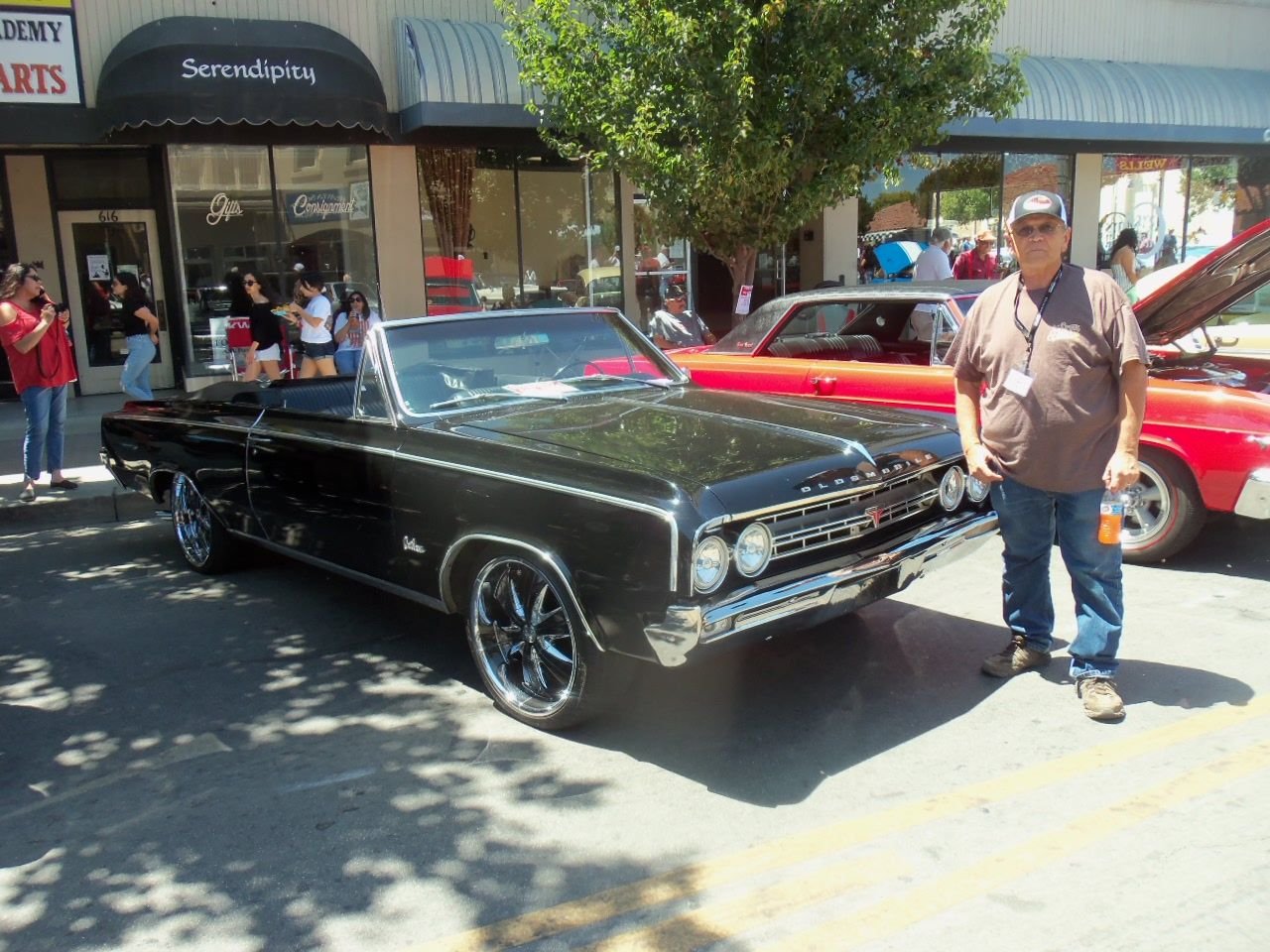

These 22" were on this 64 Cutlass just a little rubbing. They were replaced with 15X7 SS 1 chrome rims a much better look.
Old Apr 17, 2020 | 04:06 PM
Posts: 50,770
But what was the tire OD and width? The smallest 22" tire you can get is 245/30-22, which is about an inch smaller in diameter than the 245/55-18s the OP is talking about.
