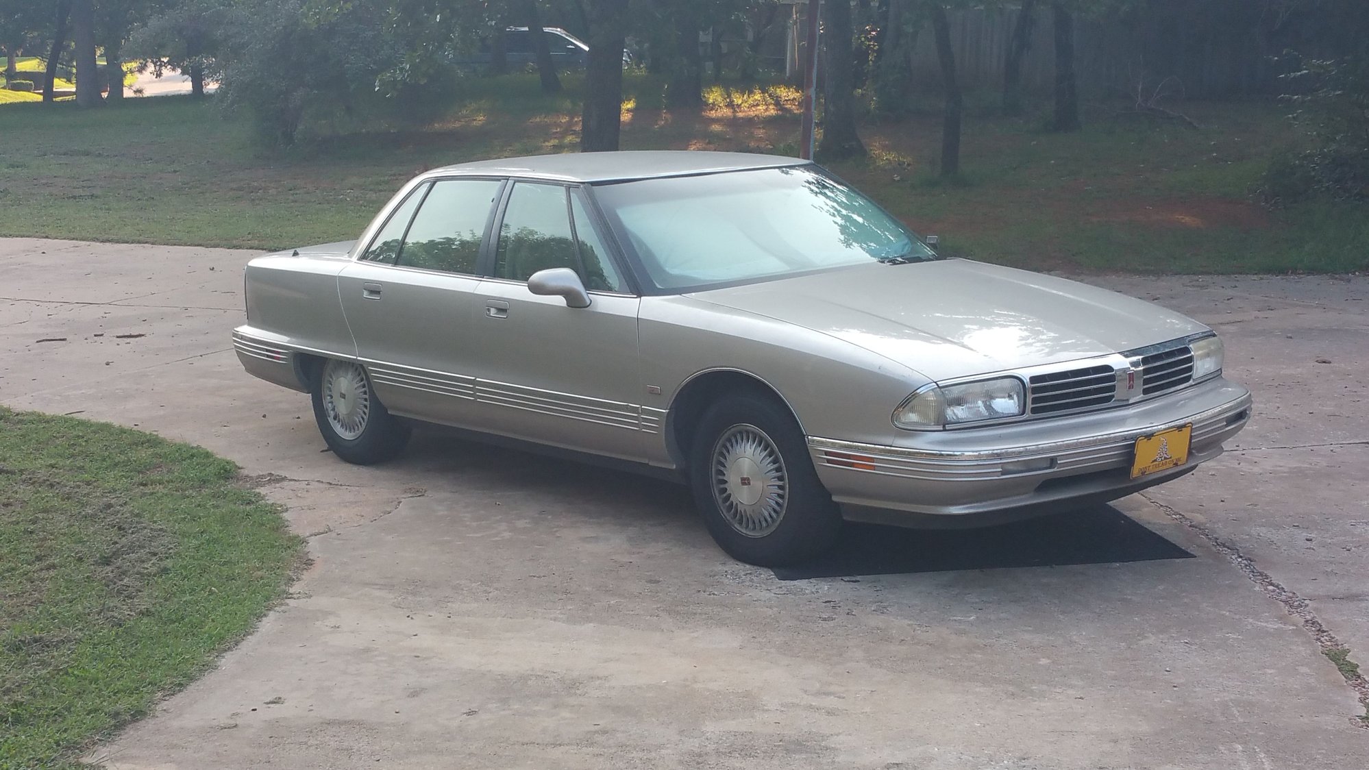

I wore out the tires on my 96 98. I drove it over 40k miles in the few years I had it. It looked better with white walls.
