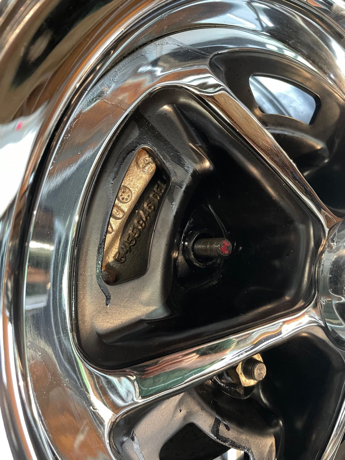

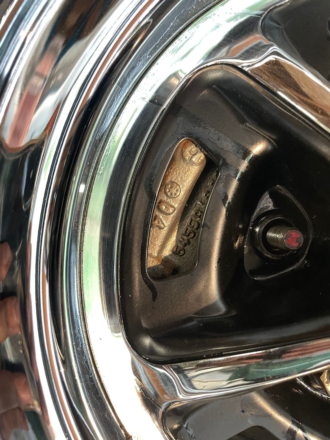

Hi Folks,
Just spent a ton of money on 4 new wheels & tires for my 68’ 442 rag. It has the factory 4 piston disc brakes up front. I was told everything would fit with no issues etc. The trouble is, the outside of the caliper is contacting the inside of the wheel preventing the wheel from turning/spinning freely. This is a bummer. Do I need to swap out the 68’ four piston calipers and rotors to the newer style single piston caliper used on 1969 to 72’ cars? Will that work? Thanks in advance for your assistance!

How much room do you need? If you only need 1/16" - 1/8", I might try to clearance the caliper first. Remember that the 67-68 4 piston calipers are solid mointed not floating like the 69 up, so they should not move around much once you get good clearence. If they are the original date coded calipers for the car, you might want to get a new pair of calipers rather than grinding on your origianls.

Yes- all original / unmolested. Calipers are the original GM 68' calipers and rotors for 1968. I thought about wheel spacers but am not certain that would look great. Additionally, it may compromise the front end somewhat by extending the front wheels away from the car- not sure what impact that might have on things. I suppose washers would be the poor mans approach to things and allow me to slowly build up the required height that I need to push the wheel away from the rotors. I get grinding the surface of the contact area on the caliper but can't bring myself to mar the finish of an original set of GM four piston calipers that we pay so much for nowadays. I just wish the folks at Wheel Vintiques would have disclosed this PRIOR to me spending good money. Surely I can't be the first one to bring this to their attention??

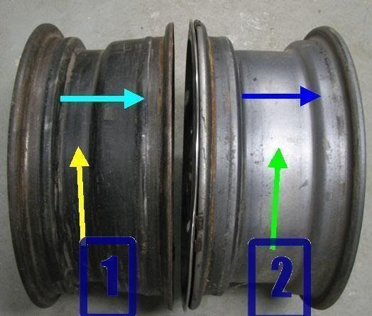

The issue isn't the 14" or 15" wheel hoop. It's the center. They're ALL the same size in the centers whether 14" or 15" hoops. So even with 15", they both meet in the middle at the same locations.
It sounds to me it may either a backspacing issue that wheel vintiques never will admit to being wrong, but the tape measure doesn't lie, or the hoop design on the inside. The lips and drops and ledges and overall shape could be different than the originals that actually fit. They did it all over the place on the SSIII rims they used to sell. Knowing them, the 15" hoop they use on the SSI would likely be the same hoop, thus the backspacing would likely be a tad deeper. The SSIIIs would clear the single piston brakes, but not sure of the quads, even with a 1/4" extra backspacing than factory.

Ok, so, the answer is, it depends. There's multiple SSI's. Some of them fit disc brakes, some don't and this has nothing to do with the SSI center, but the hoop.
66-69 all chrome 14x6: does not fit oem disc
Certain 69 all chrome 14x6: does fit oem disc
70-72 trim ring 14x6: does fit oem disc.
72 all chrome 14x7: does fit oem disc.
Those repro rims, it depends what hoop geometry they were using. I have two sets of 69 SSI all chrome 14x6 oem wheels and 69-72 caliper disc brake take off spindles set, assembled. I have put one of the wheels on it and spun it. Please also remember all SSIIs clear oem disc; the same hoop was used, just with different center.
See Joe's picture.

i would try an 1/8" spacer, you seem to have plenty of threads sticking out of the lug nut.
