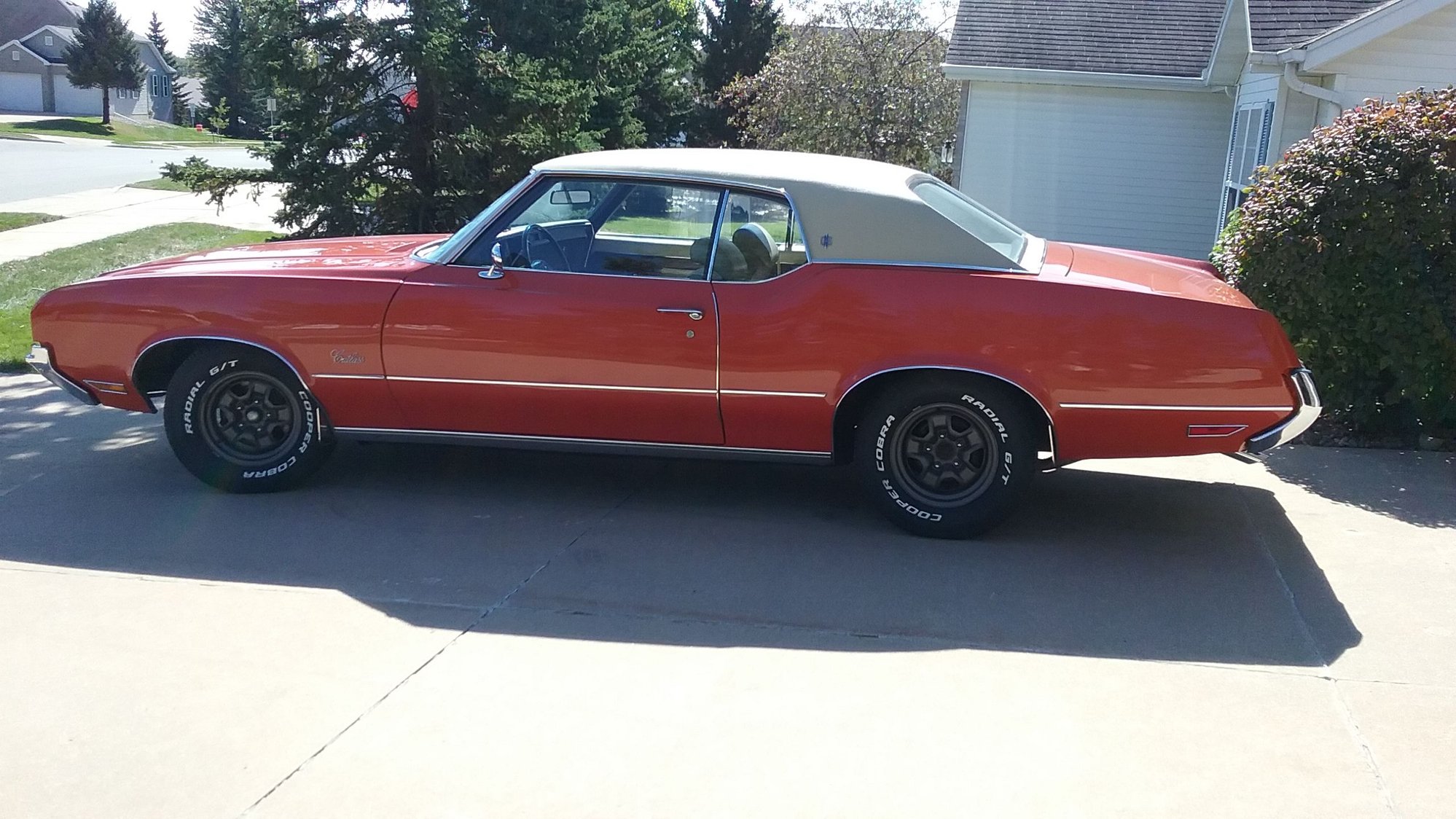

235-60-R15 or 245-60-R15 up front and either 245-60-R15 or 255-60-R15 out back should be workable sizes for the wheel combo you noted if they are 4.5" backspace. I would keep to 1 size larger for the back than the front though. I would either go from front to back - 235 / 245 or 245-255 since you're planning on using 2 different width rims.
OR... you could ditch the 15's altogether and move up to 17x8 all around if you're not completely set on wanting a white-letter tire set. On my '72 I run 17x8 rims with 4.5" backspace and 245-50-R17 rubber all around and they are essentially the equivalent of a 245-60-R15 in overall wheel height and depth.
Benefit of larger rims is the increased choice of more modern tires - i.e. updated technology with improved ride/handling over the well aged BFG/Cobra designs. Both still arguably respectable for their limited interest use these days, but not really cost effective anymore in my opinion.
