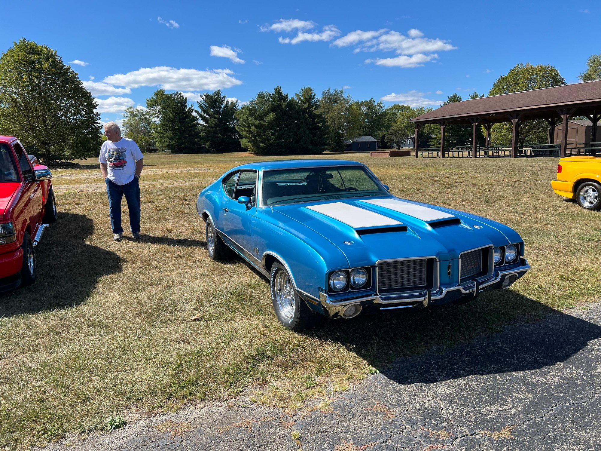

Wheels are American Racing Torq Thrust II. The front are 15x7 and the rear are 15x8. Tires are 225/60R15 in the front and 255/60R15 in the rear. I ran 275s in the rear before and they rubbed. These wheels clear Wilwood calipers. The 15" Oldsmobile Super Stock II/III wheels from the mid 70's hit the caliper. In addition, the 15" wheels from Wheel Vintiques (Super Stock I style) also hit Wilwood calipers. Yes, I learned the hard way!. I have a Hotchkis B-body spindle conversion also, which lowers the front about 3/4".

1972 Cutlass 442, no rubbing at all!
15 X 7 61C 5X4.75 with a 4 inch BS CRAGAR SS with P235-60-R15 Radial T/A’s on the front
15 X 10 61C 5X4.75 with a 5.5 BS CRAGAR SS with P295-50-R15 Radial T/A’s on the rear
Thanks to all Classic Oldsmobile members who gave me great information!
