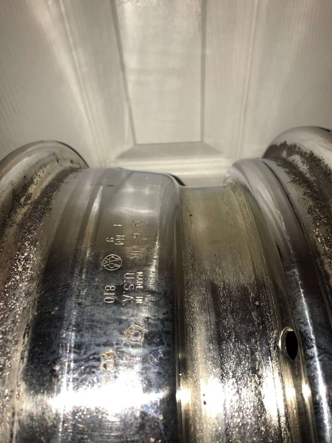

I bought a set of SSI wheels and one of them is something I can't identify and was hoping someone could shed light on this for me.
These are all 14 x 6 JK code wheels. Two are 795 code and I know what they are. One is 810 code and I know what that is (made in 69 only to fit disc brakes). The 4rth is an 813 code which somewhat looks like the 810 code in that it looks like it may fit disc brakes but I'm not sure if it is an Oldsmobile wheel. The 813 code wheel is from 69 like the 810 wheel but the profile is different as the pics will show and is different from the 795 wheels. To make it more confusing one of the 795 and the 813 wheel is bright chrome on the spokes and the other 795 wheel and the 810 are as I expected blasted so they have a frosty look on chrome on the spokes. The bright chrome 795 wheel doesn't have a date code on it but the the frosty one is from 1968. Also the 813 wheel backspacing looks to be 4 inches even. Any help in identifying if this 813 wheel is an Olds or something else is appreciated.
The 813 code wheel
The 810 code wheel

the 795, 810 & 813 are the HOOP shape & size
JK (or J / JJ) is the bead design
Motor Wheel Corp made all these wheels
the satin spoke ones started as Oldsmobile SSIs, the bright spokes started as (over-the-counter / "speed-shop" or other) MAGNUM 500s
the M4/9 stamp inside the "HOOP" indicates Motor Wheel Corp., plant #4, 1969 (plant #1 is Lansing, MI & plant #5 is Chatham, ONT - anyone know where plant #4 is/was?)
there should be an additional date & wheel code stamped on the lip
