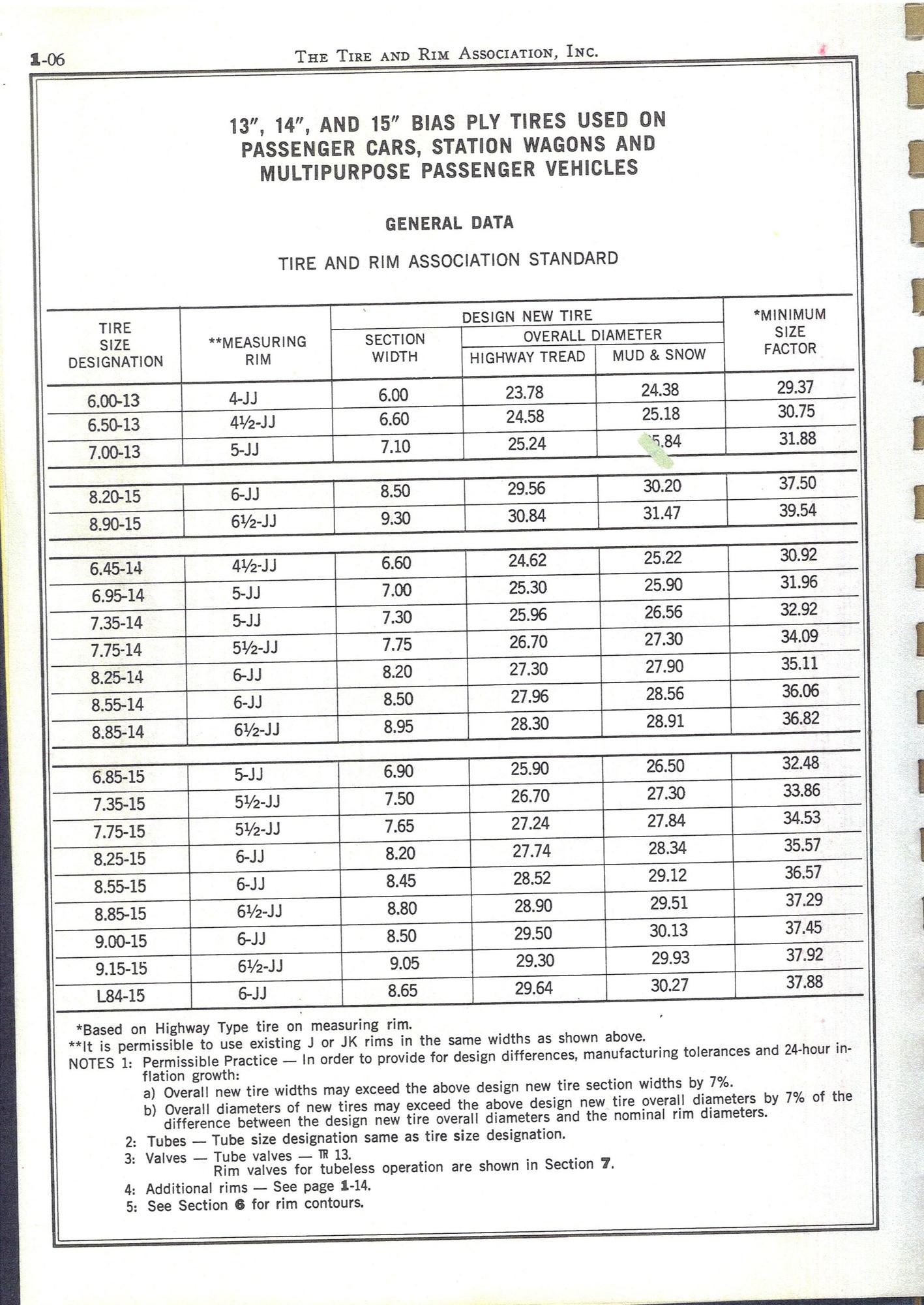

Half an inch larger diameter will raise the car 1/4", and actually less than that due to sidewall flex. The lettering is the usual black molded script, You can barely see it.
As for 225/70-14s rubbing, the 1965 cars were available from the factory with 7.75 x 15 tires under RPO P27 and P28. That tire size was 27.24" in diameter with a section width of 7.65" when mounted on a 5.5" wide wheel.
The original tires on a 1965 442 were 7.75 x 14s which were 26.70" in diameter with a 7.75" section width.
225/70-14s are 26.4" in diameter with a section width of 8.86".
215/70-14s are 25.85" in diameter with a section width of 8.46".
Anecdotal information that a particular tire rubbed is meaningless unless you also know the wheel offset used and whether or not that car had a disc brake conversion that pushed the wheels outboard.

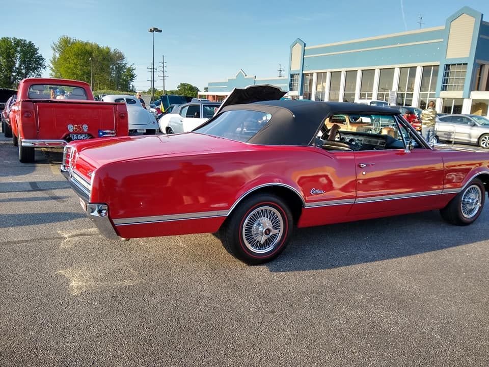

For three years now I have had Coker BFG Silvertown 215/70R14 Red Lines mounted on 14X7 steel rims and I like the stance of my car. Best ride I have had and I like the stance. Red Lines look great with my red vert. Many compliments.
Wayne

I talked to Bill at Diamond Back. He said that the Coker BFG Silvertown redlines are built under license by Specialty Tire at the former McCreary Tire factory in Indiana PA. I asked him about the balancing challenges I've seen on multiple web sites, and he said that their uniformity issues stem from using old equipment. That said, the rubber on Wayne's '66 looks sweet!
Bill recommended the DB SS (Street Steel) over the DBIII BFG Radial T/A, especially for a more 60's tread pattern. And I sure don't need an M&S rating. Starting tires for the SS's come from Singapore, and the T/A's from Mexico.
