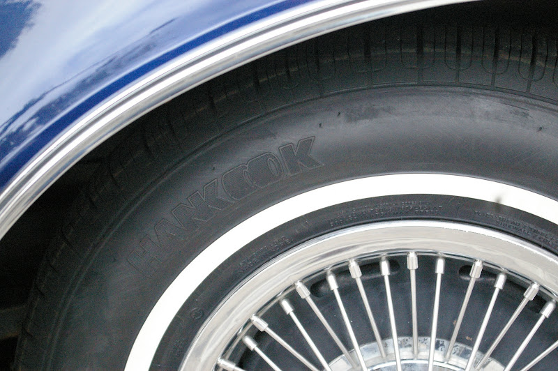

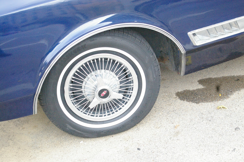

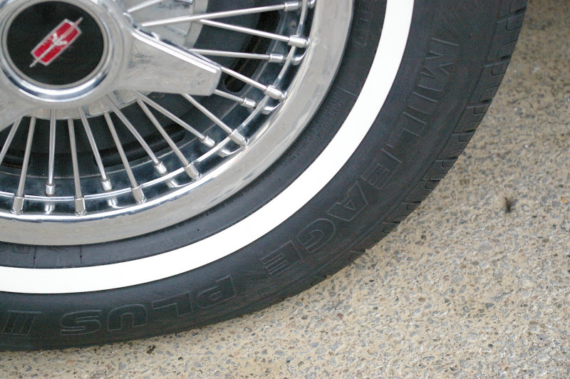

Well I got new tires installed on Tuesday (of last week). I decided on the Hankook Mileage Plus II P225/70R14 because (as discussed above) they appear to be the only major non-specialty manufacturer making tires of that size which have white sidewalls, not just white lettering. They were quite reasonably priced.
As requested, here are a few pictures of an installed tire:
The full-sized images are available here.
