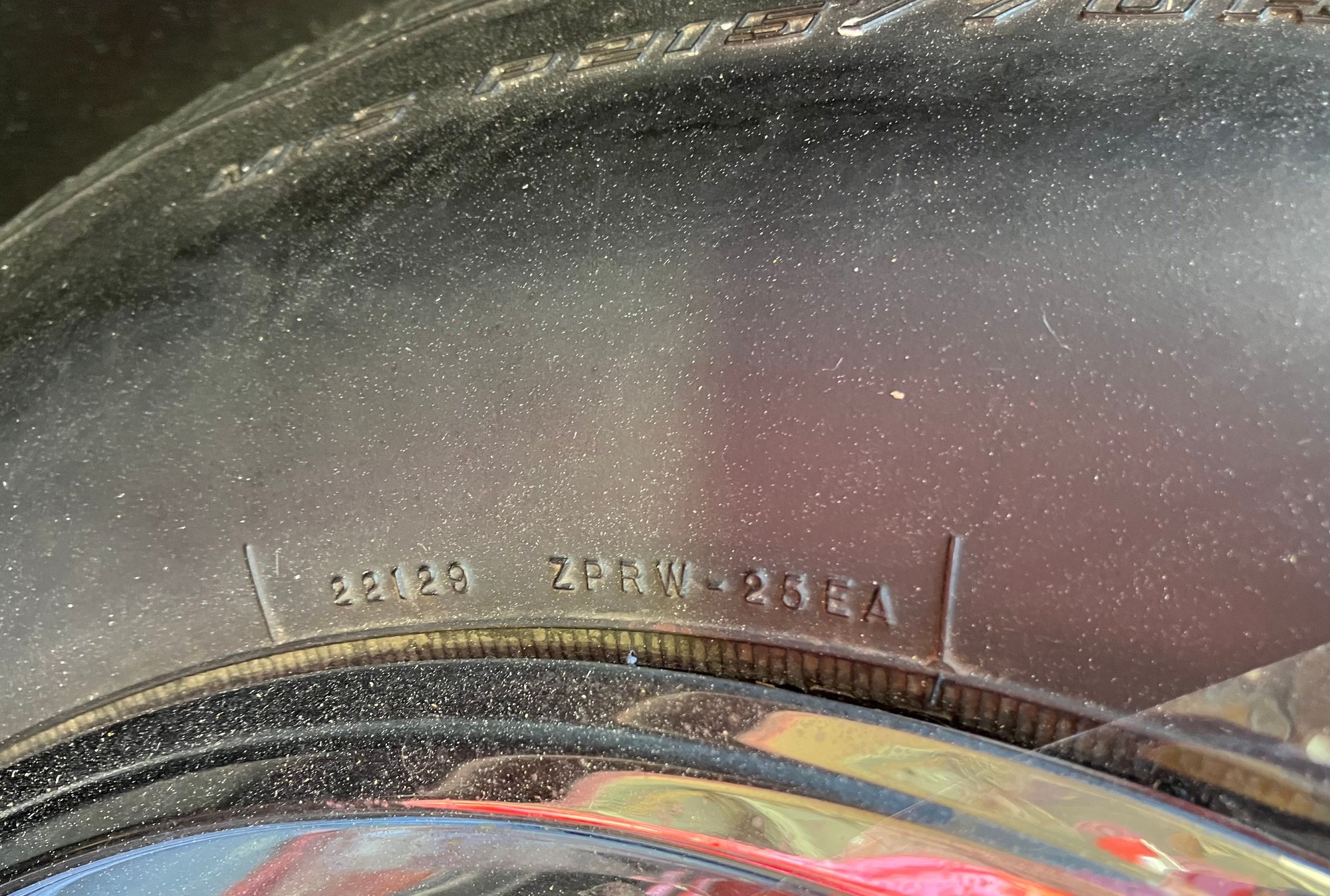

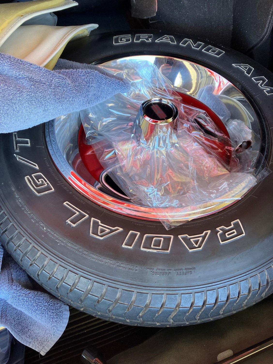

My spare is probably very old, no conforming DOT post 2000 stampings, only these numbers, Replacing it, just curious - any guesses?

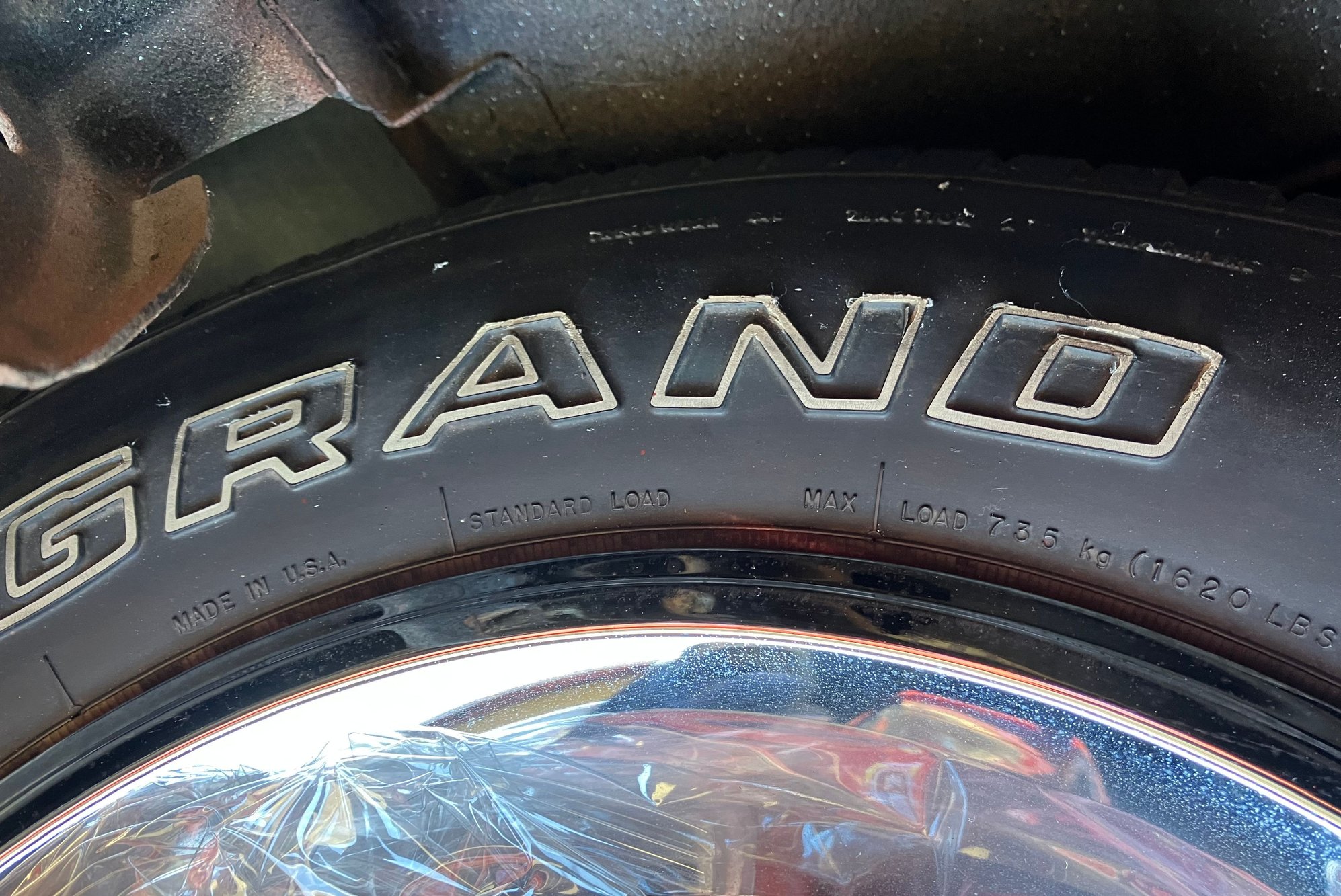

At least it was made in the USA.

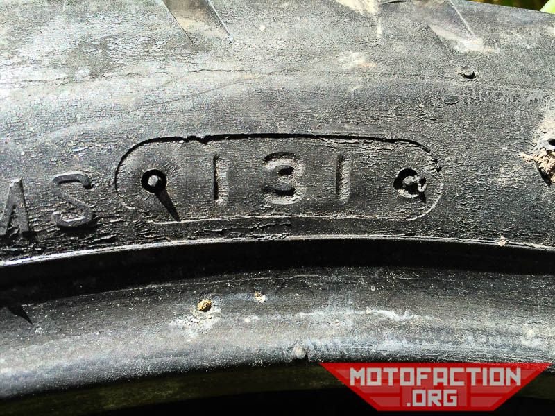

Date code is in an Oval Melted Rubber / Embossed thingy
Tire date codes for tires made before 2000 are three digits long. The first two digits indicate the week of the year, and the last digit indicates the year within the decade

Thanks guys I’ll flip it over tomorrow. Didn’t see anything like that on the raised white letter side.

Three digits located on the other side, 066. ‘96? ‘86? ‘76? Holy cow.

Perhaps my previous post wasn’t clear, forgive me. The three numbers (designating pre-2000 date of manufacture for tires in the United States) are 066. The sixth week of the sixth year, of whatever decade.
Apparently, thats why DOT went to four numbers, with the first two remaining as week of manufacture, and the second two being years, so there was no guesswork necessary versus the single digit representation year of manufacture.

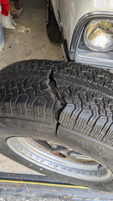

My new to me 66 GTO had this tire in the trunk so I inflated it to 32 psi as the spare and a few months later it LOOKED LIKE THIS just sitting in the Trunk inflated - so ya old tires pre 2000 are NOT Safe lol

I had a trailer tire do that once. It wasn't that old. I reached with a pair of dykes and snipped the valve stem before I changed it. I cant believe it didn't explode.
