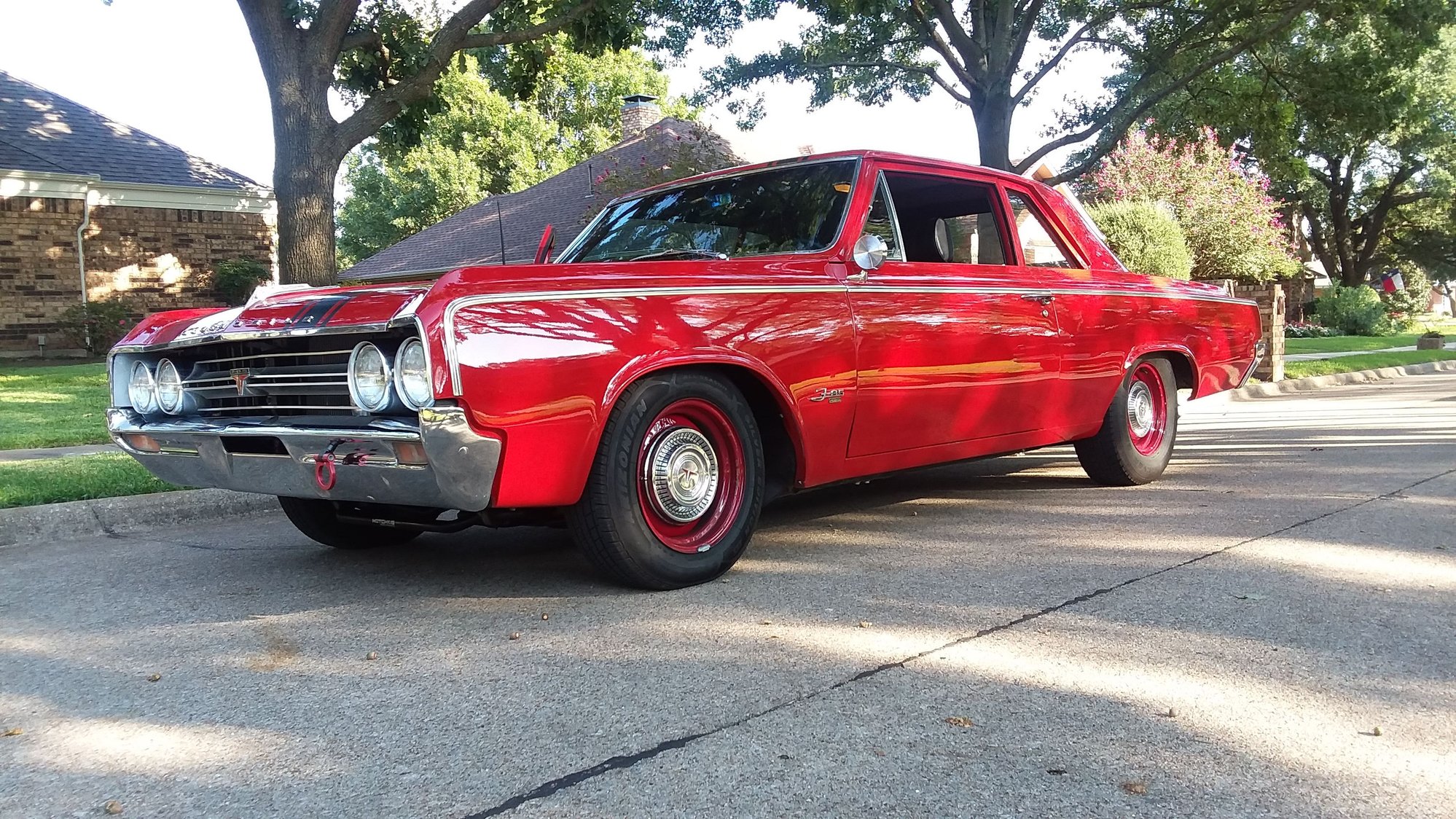

When I build the 64 F-85 post car, I bought a real nice set of GM big car 15 inch steelies from a fellow club member here. That will take care of it. At least it worked for me, just another idea
