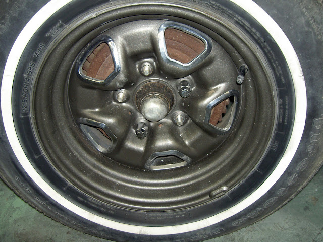

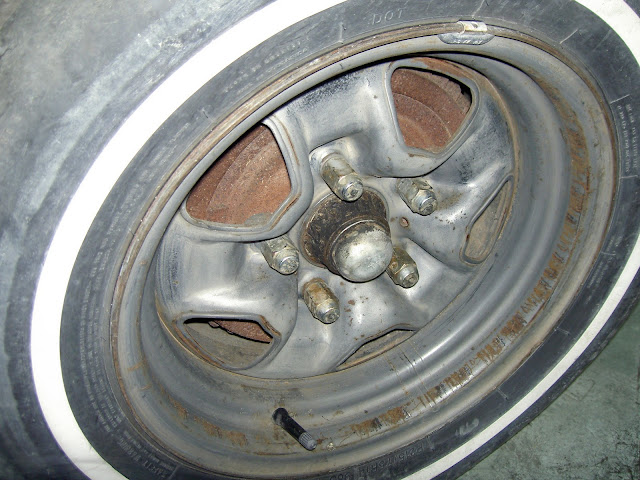

Anyone know the color/shade of grey the wheels were that came on 1972 Cutlass S. Can't remenber if I special ordered them grey or if it was standard. I'm attempting to restore to original.
The area exposed to the sun is much lighter that what has been hidden under the ring for all these years.

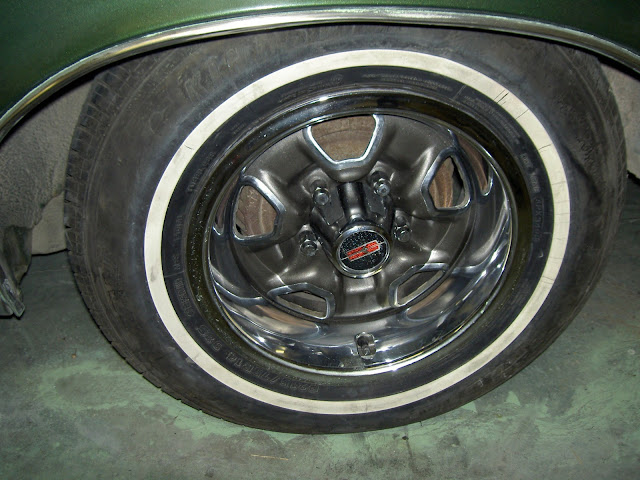

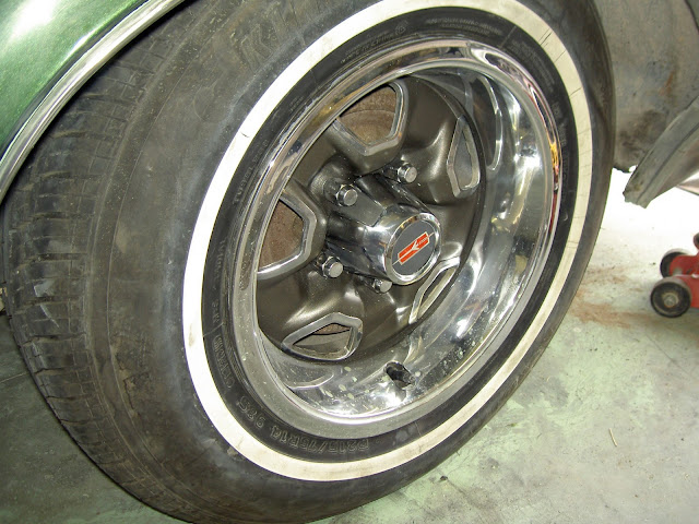

Thanks to all for the all the advise on colors, light, dark, grey and no clear coat.... I commited and ordered the spray paint for Super Stock II wheels from Fusicks WP 5S Silver Gray Paint and what arrived was labeled "Charcoal Grey" My origianl wheel paint had faded to a lighter grey and the paint hid under the rim was a darker grey. so I think what I have ended up looks pretty much original? If not it look so much better than before....You can follow my pictures and see the remakable recovery back to new condition... amazing what a couple coats of paint will do.
Before starting wheel rehab

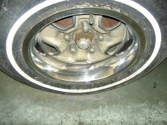

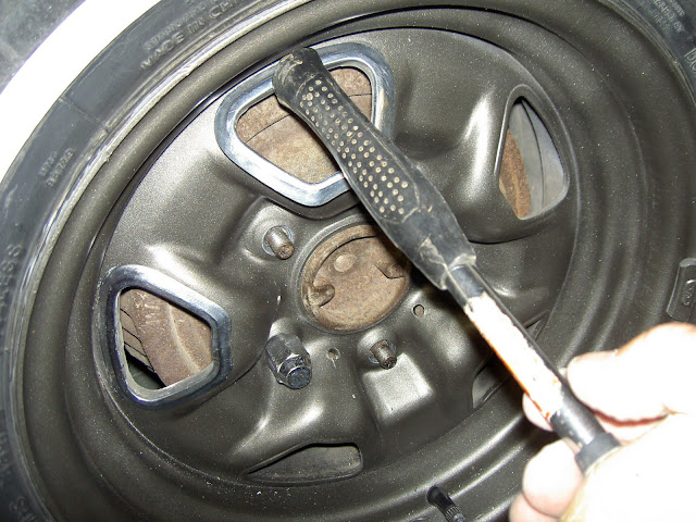

Original wheel with Bezels removed. They can just be poped out from the back.

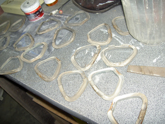

Polished them all up with Mothers...and fixed clips with screwdriver

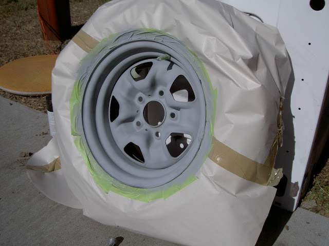

Masked off tire and did a rust proof primer...

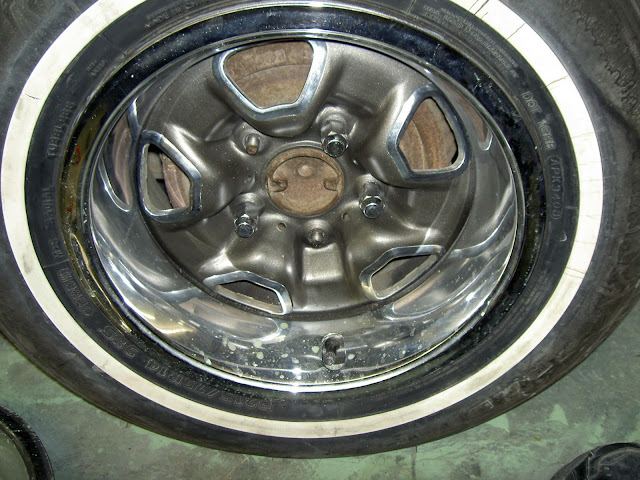

Sprayed a couple coats of Charcoal Grey Wheel paint...
Popped back on the Bezels

put the original Wheel Trim Rings back on after polishing.....

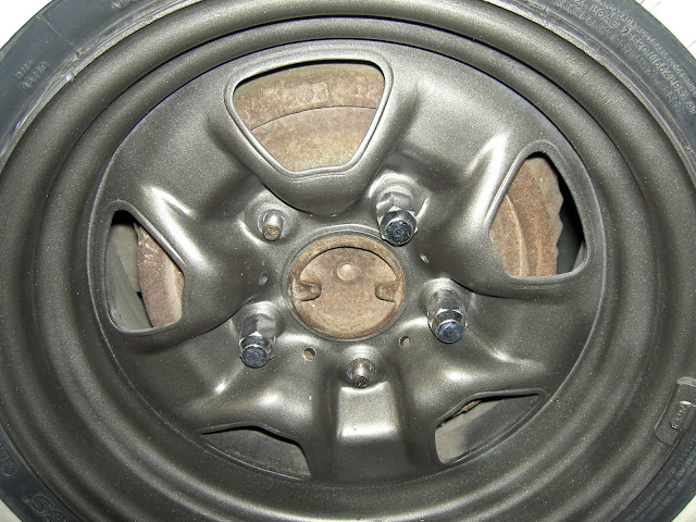

Pulled the wheels and replaced the Super Stock center caps, applying a little red Lock Tight to hopefully keep the screws tight...
End result looks great, but might be a little darker than original. Not sure so that argument can continue...
