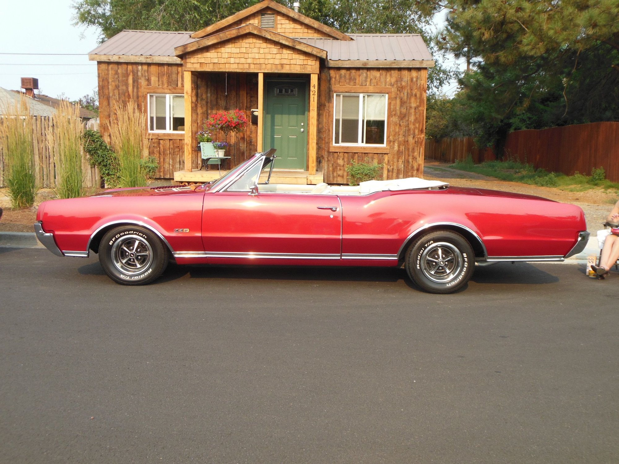

I have the 235/60SR14 on my 67 442 on 70-72 Rally 1 14 x 7 wheels. THey are too short. Look okay but too short. Will go with 235 70 sr 15 next time. Or even a 17" wheel.

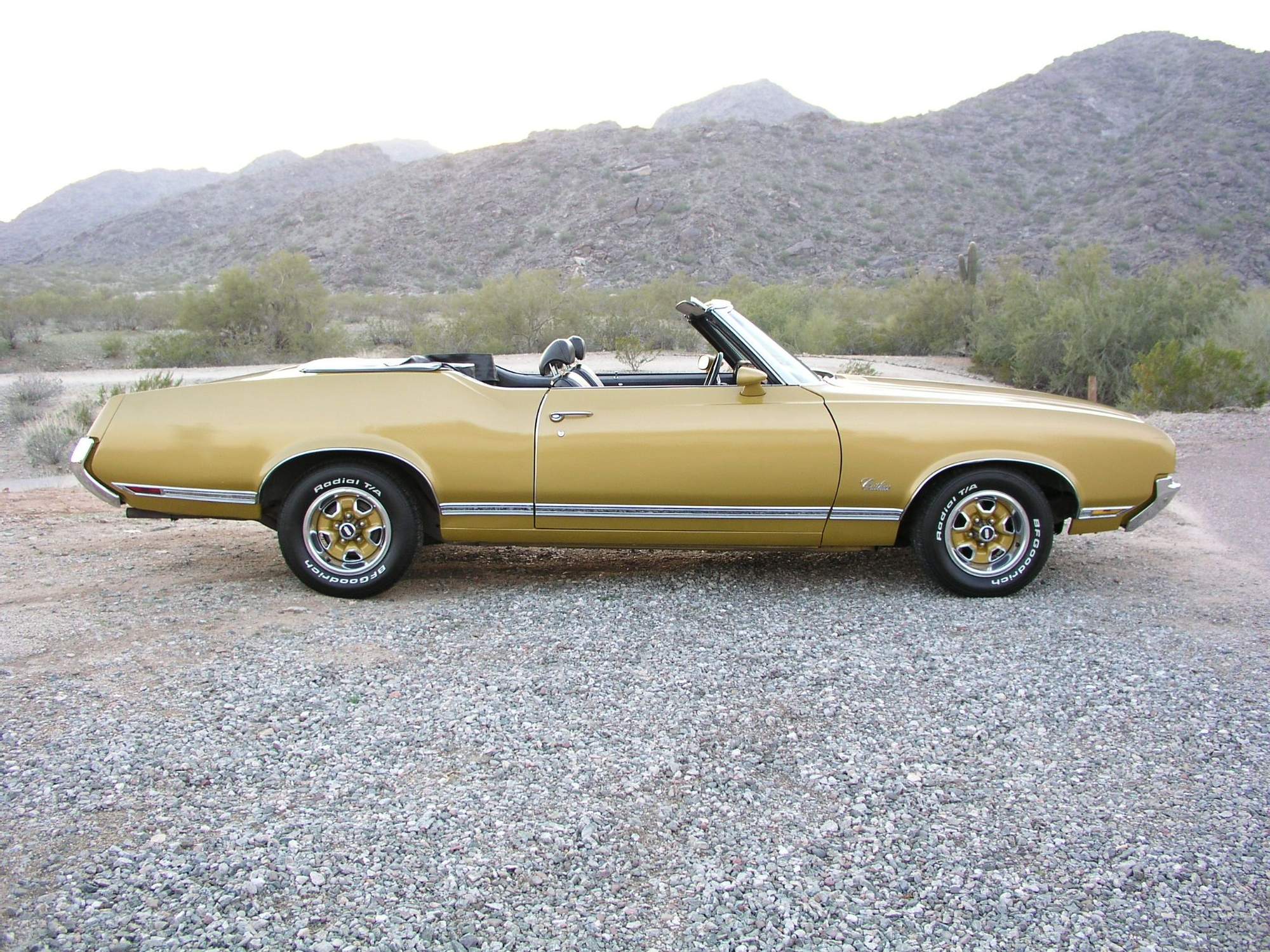

This is 205/70R14 front and 225/70R14 rear
This is a 235/60R14 on a 14×6 rim on my 70S.
205/75R14 front and 235/60R14 rear.

Those sizes look perfect, very 1972 HURST Oldish!

Isn't it great to be a part of a group so passionate about cars, Oldsmobiles in particular? My "Those sizes look perfect, very 1972 HURST Oldish!" were in regard to Fun71's convertible.
