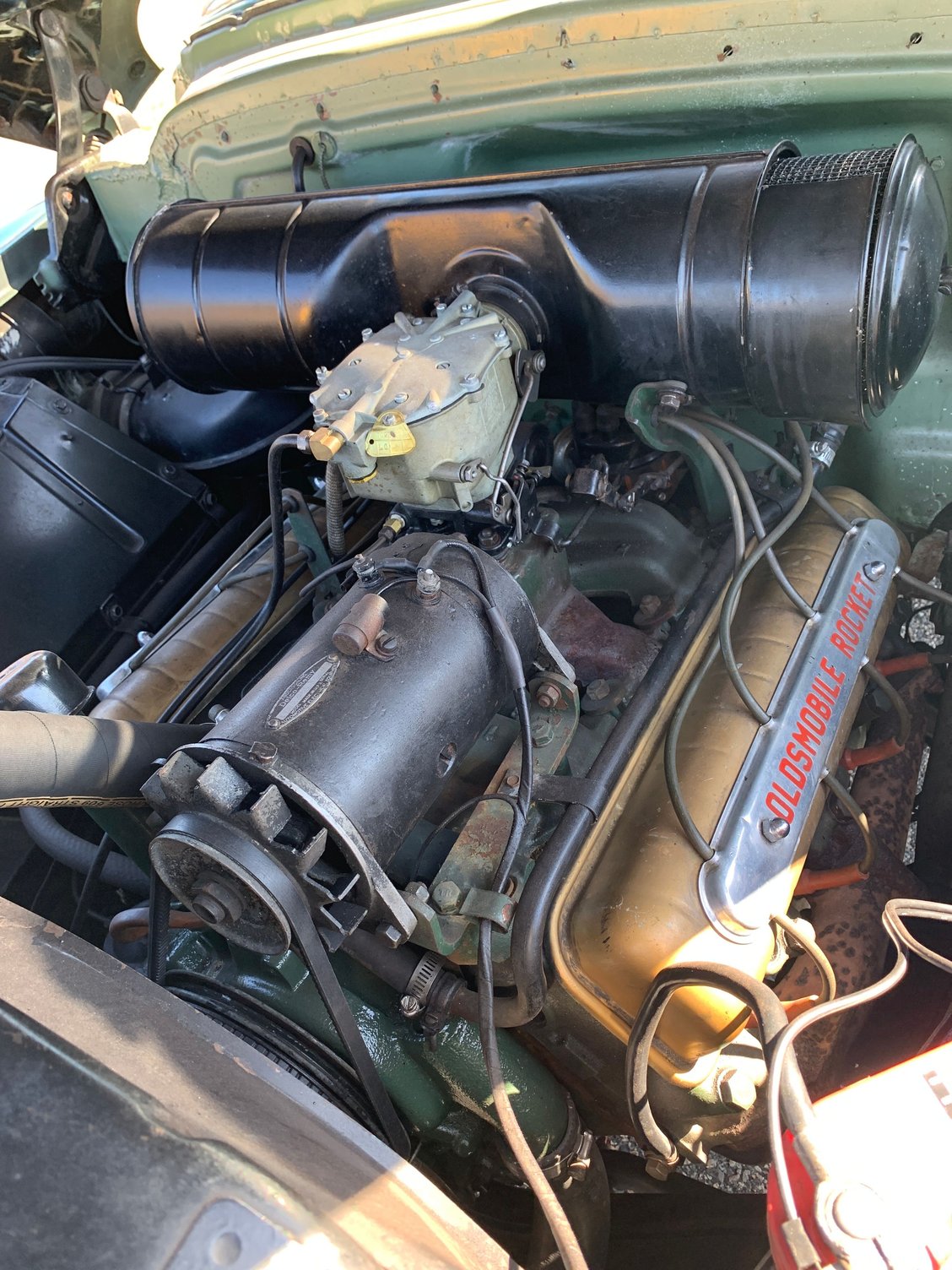

The long Maine winter helped me tackle some big projects. Many of you were a big help with the 1949 Olds 88 restoration! Today was the maiden test drive after every major mechanical system (and lots of body work) was done. The original 303 with 30,000 miles fired right up and ran great for the first 15 min or so. Then it began to stumble a bit. I’ve replaced the plugs, ignition system, set idle, dwell and timing all to spec. New exhaust system. After an hours drive it began to run so poorly I had to pull off the road. Backfiring through the air filter. It ran better at wide open throttle, but still wasn’t “right”. I’m suspecting vacuum leak. Maybe at the intake manifold? Ideas?

Made it home! Barely!!! Easter miracle for sure. Pulled all the plugs. None are fouled. All look very clean after the two hour drive. However, two plugs on the passenger side looked BONE DRY. Odd. I wonder if I have an issue with valves? I then checked for vacuum leaks at the carb and intake manifold using both propane and carb cleaner. I cant seem to see or hear any leaks. I swapped out the coil for a new one from Napa on the way home. I had an Echlin IC-9 (a 6v coil) on it before that tested good. I was told at my Napa that the correct part number is IC7SB. Thats a 6v coil too. I am using the stock 6v. So coil is out. I am curious about the difference between the IC-9 and the IC-7 coil... Either way, it didn't change a thing.
I have no reason to believe any of my carb settings changed. It was a total carb rebuild that I did myself. It had this stumbling problem before all the work was done. My carb rebuild and adjustments using a vacuum gauge, timing light and dwell meeter helped it run much smoother at idle, but this recurring issue happens once its been driven a bit.
