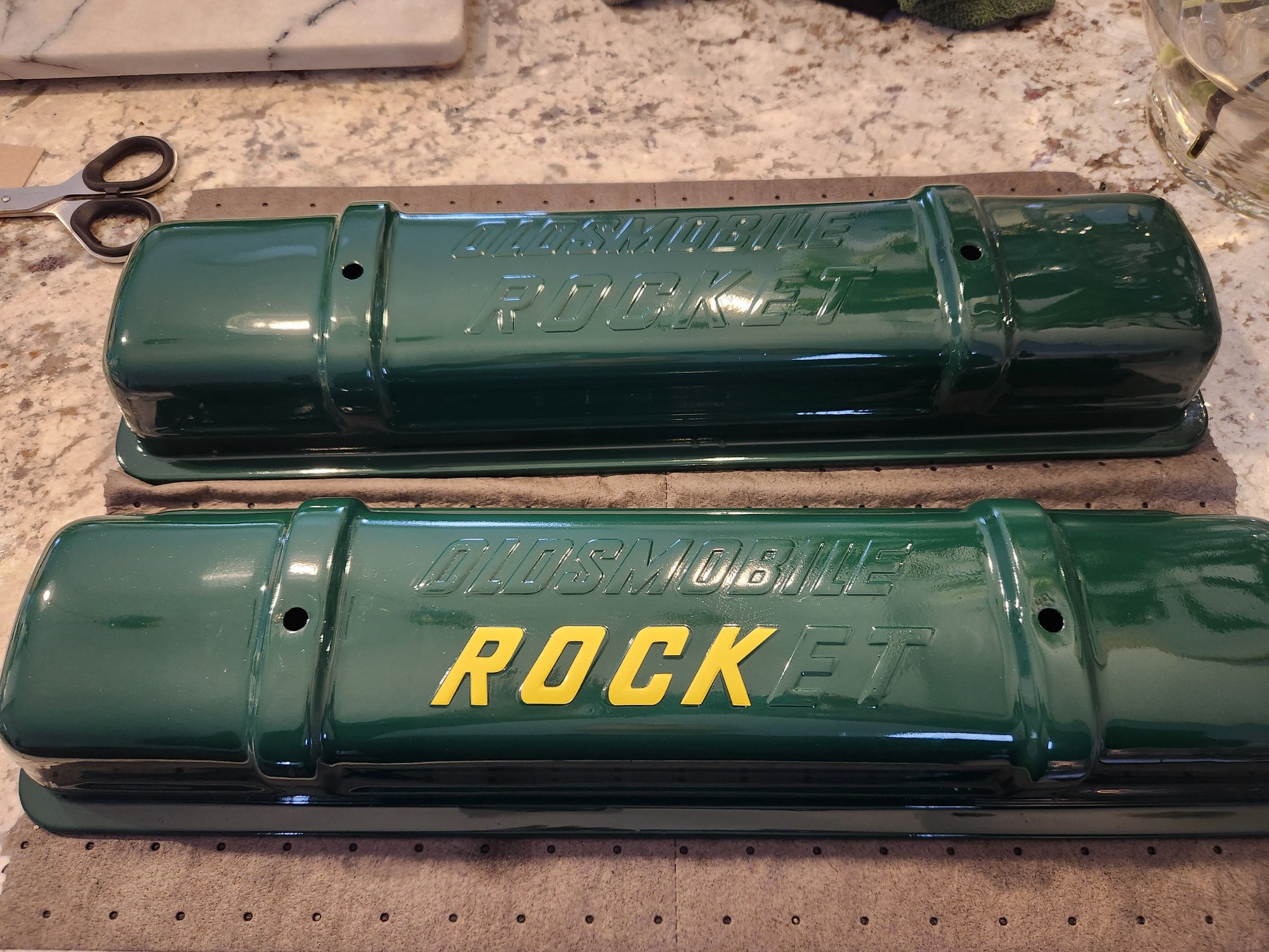

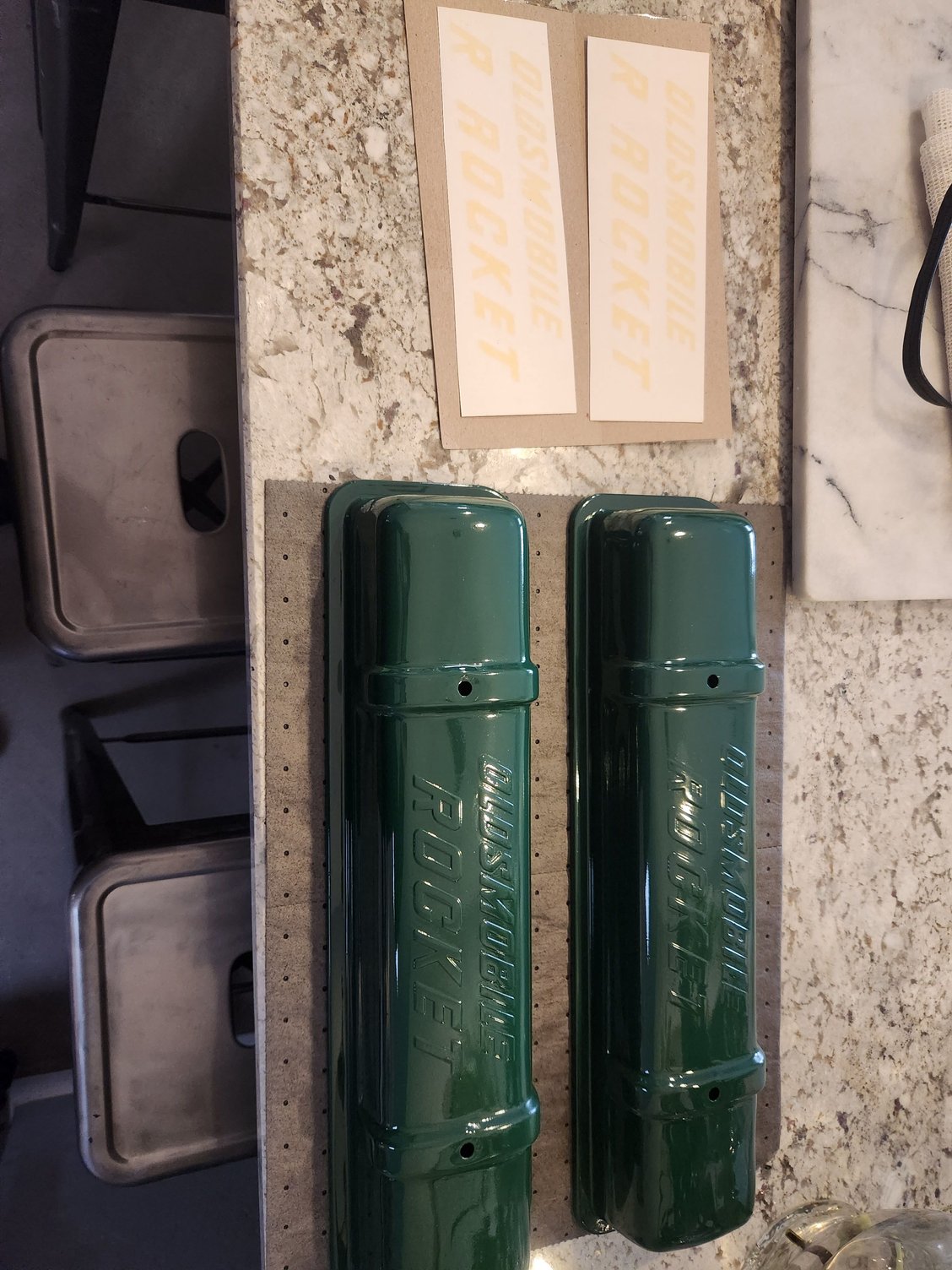

I was just going to use a spray bottle with water and soap so I can move around before locking them in. Any thoughts?

Yes good idea, also seperate the Oldsmobile from the Rocket to make it easier, especially since the decals go on top of a raised stamped surface.

I have done quite a few decals on boats and cars and a spray bottle of dishwashing detergent will work. It doesn't have to be real strong. That is a good suggestion Dan gave you about separating the Rocket from Oldsmobile. I did a set of these on the 54 I had and they held up really well.

Im just doing one letter at a time.

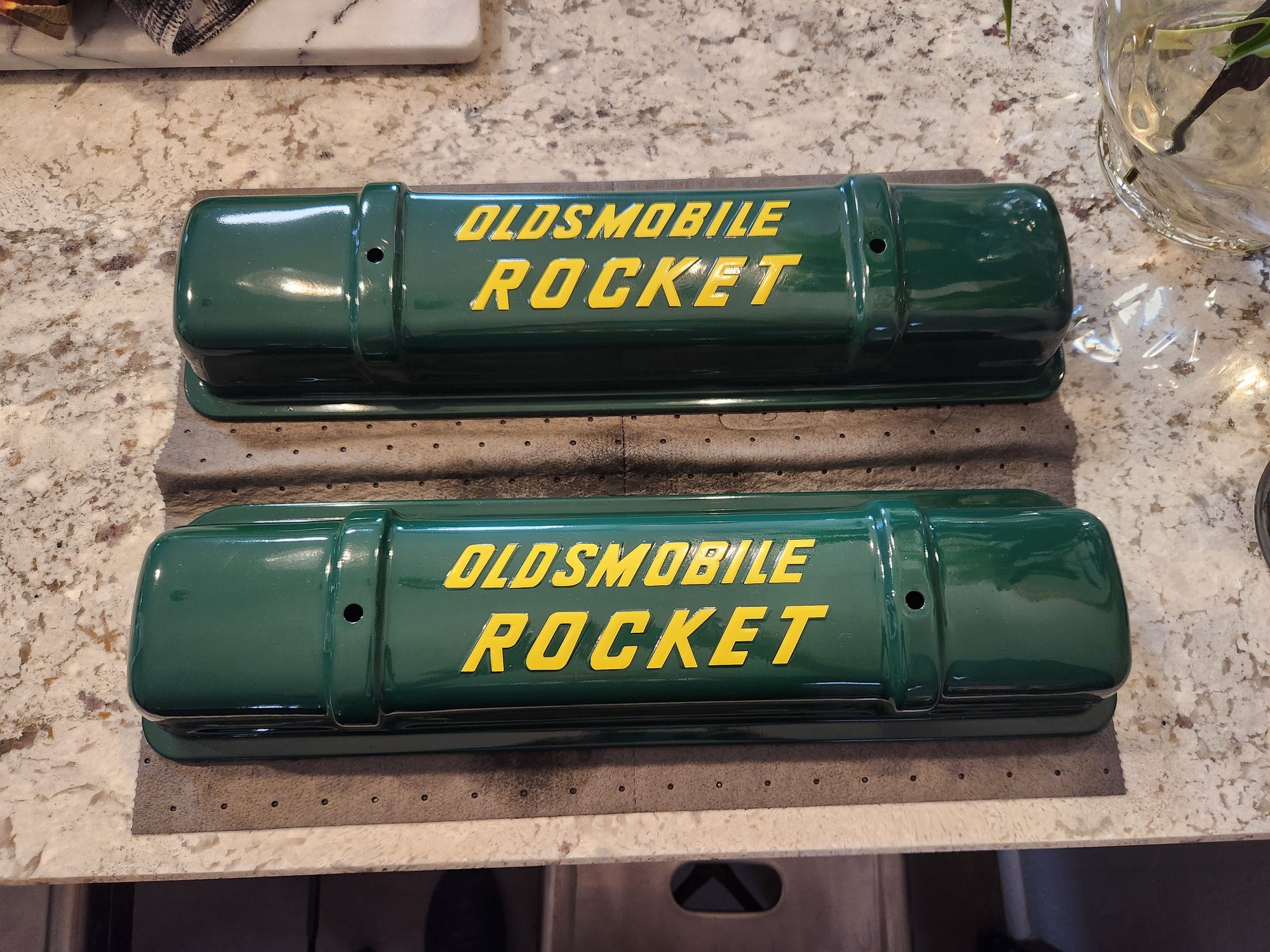

Ok done! Not bad. How do these Fusick decals hold up?

The decals hold up well. At the factory they actually painted the letters with a roller.

They look great! You may be able to put a clear coat over them to help seal and protect.

I never clear coated mine and they held up very well. I doubt it would hurt but probably not necessary. You would need to use heat resistant clear coat.

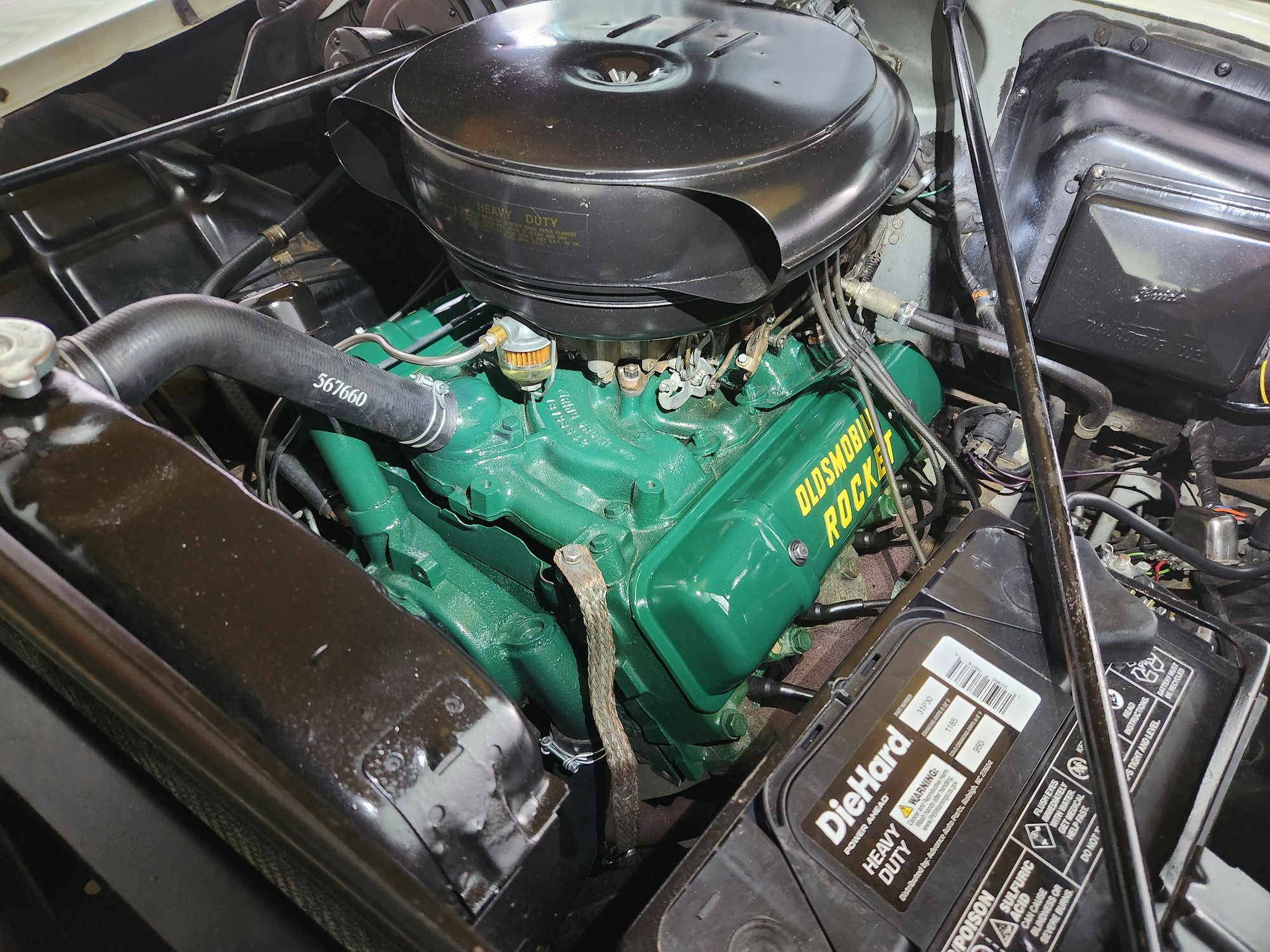

...and that's a wrap! All done. Thanks for all the comments, probably won't try to clear coat them.

Very nice job. Engine looks great.

I also put mine on one letter at a time. They are holding up very well. I also painted the intake manifolds with temperature and color correct paint. But the intakes already have discolored between the second and third spark plugs on both sides. I wonder why.
