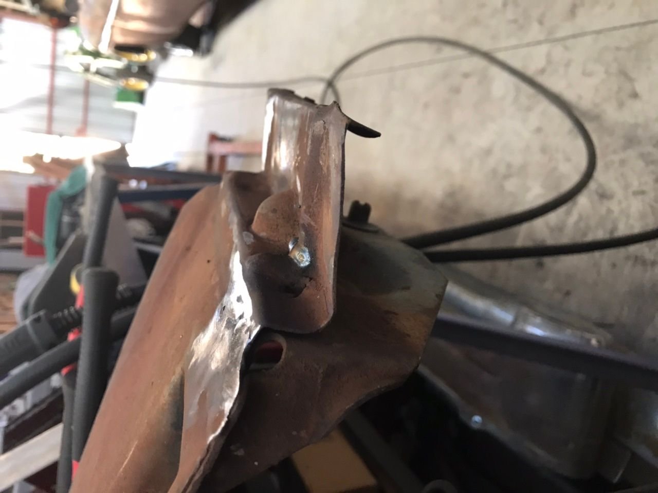

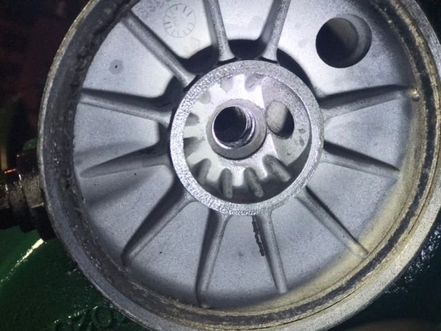

Well damn! Went to install the oil filter housing and got it cross threaded!

Thank you guys, I ordered a tap and die set to see if I can chase the threads? The cross thread is only about 1/4” deep.
We’ll see if I can salvage it?

What bolt/thread size is it ? Is it threaded all the way through ? If it is, you can screw a bolt from the back side to straighten the threads a bit. You might get lucky with a tap, but when something gets cross threaded, it mucks up the lead thread and you can cross thread it again. You might have to consider removing (grinding) the first thread or two. OR buying a replacement part.

It’s a 9/16-12 thread. No, it’s a blind hole, great suggestion! I’ll resort to buying a replacement part if I bugger it up anymore then I already have!

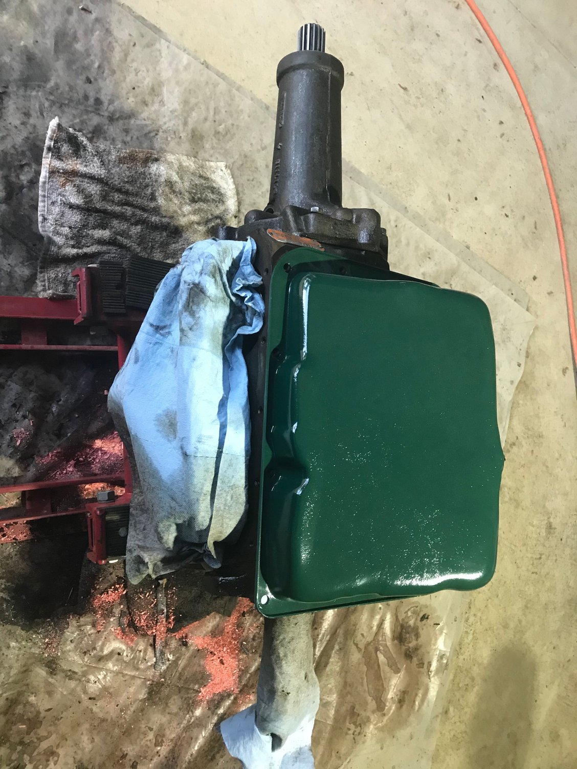

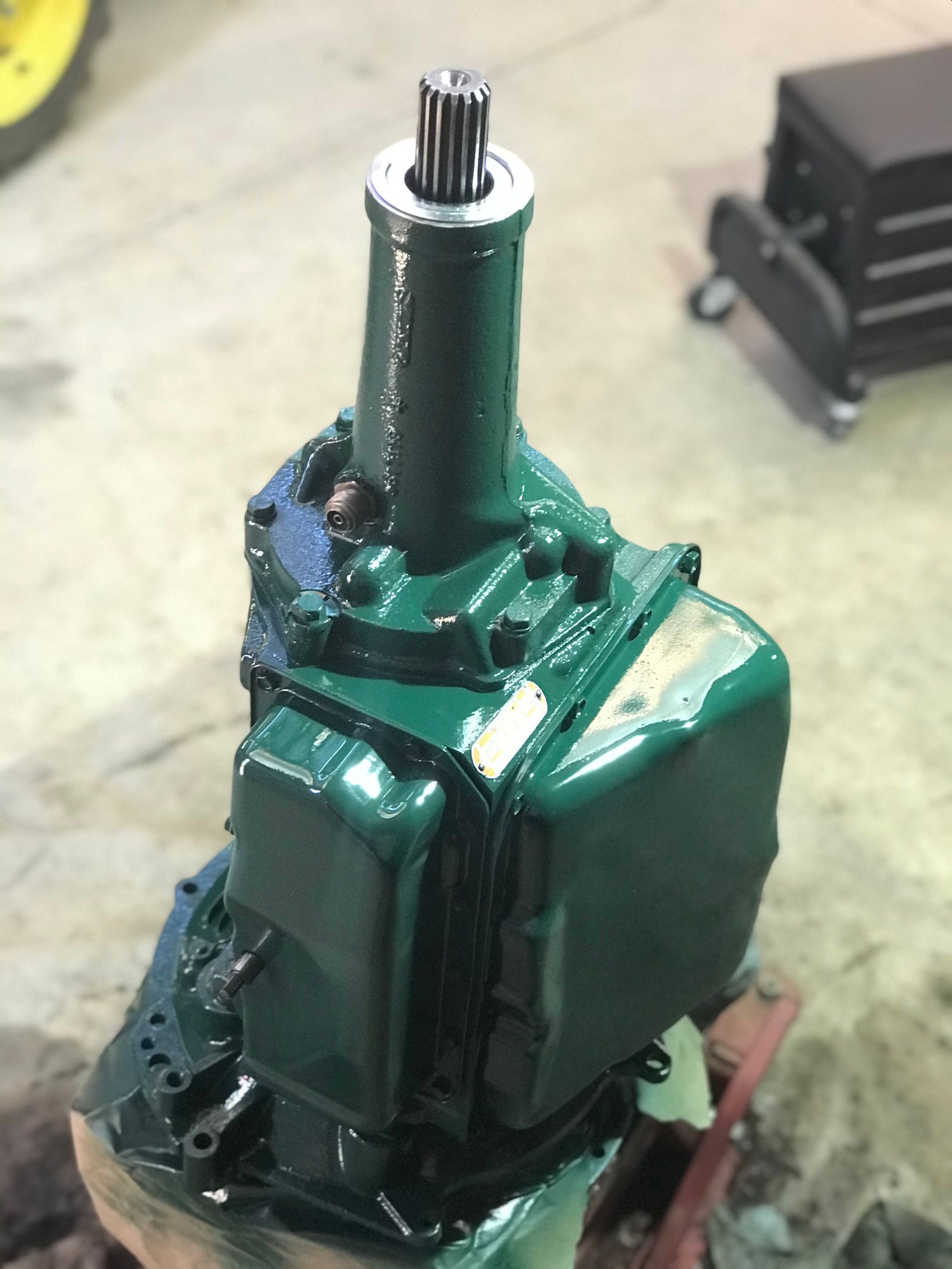

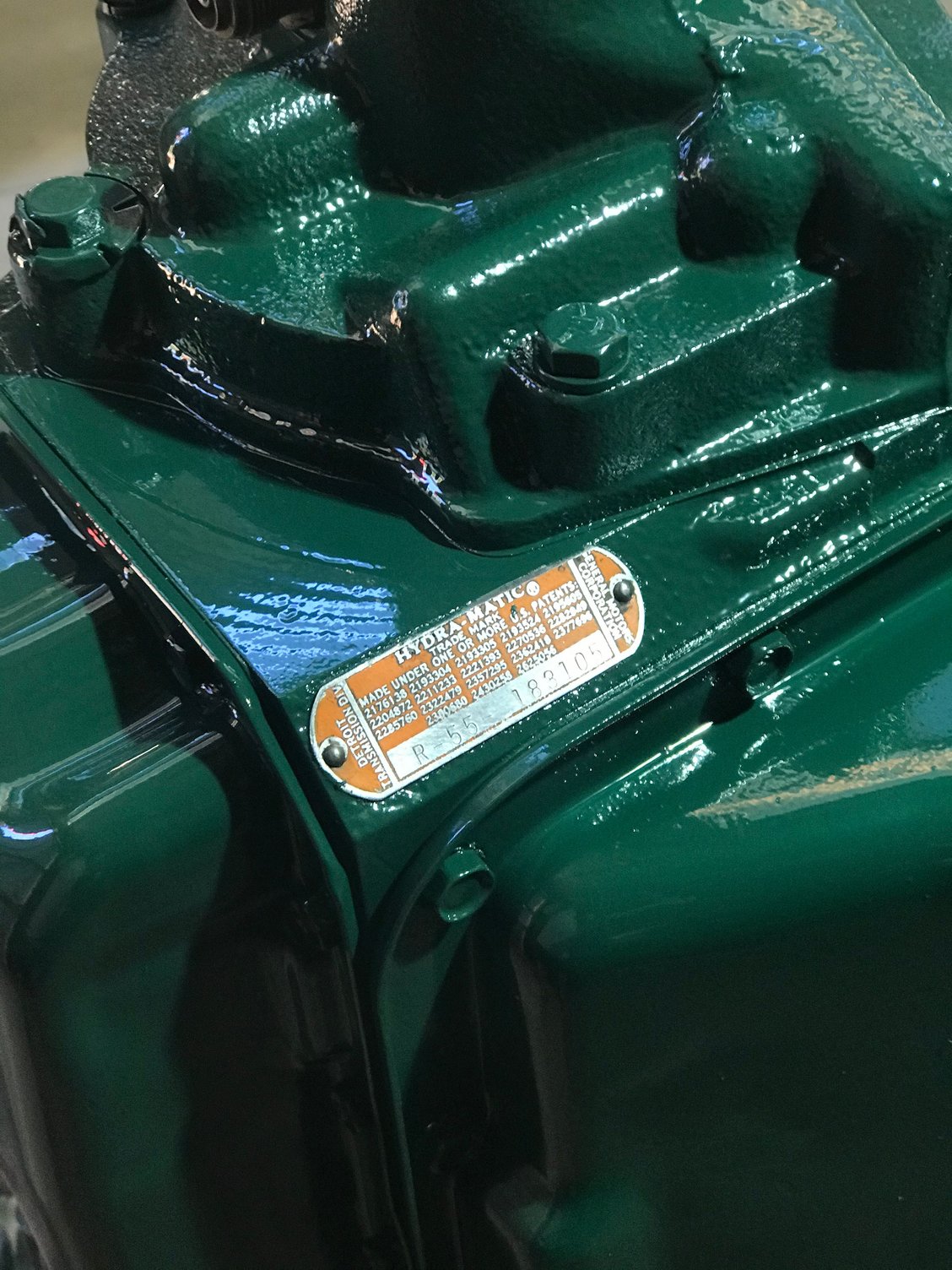

Hydramatic 55-R
Making some slow progress on the trans cleanup...
I purchased a gasket kit for it and installed it while I had had the bell housing and rear drive housing apart!

Man,,,,,,,,,,,,,,,,,,,,,,,,,,,,,,if that don't look familiar. I just need a hot rod to put this in. I like it.

very cool! Now find a 54-56 2dr to put her in!

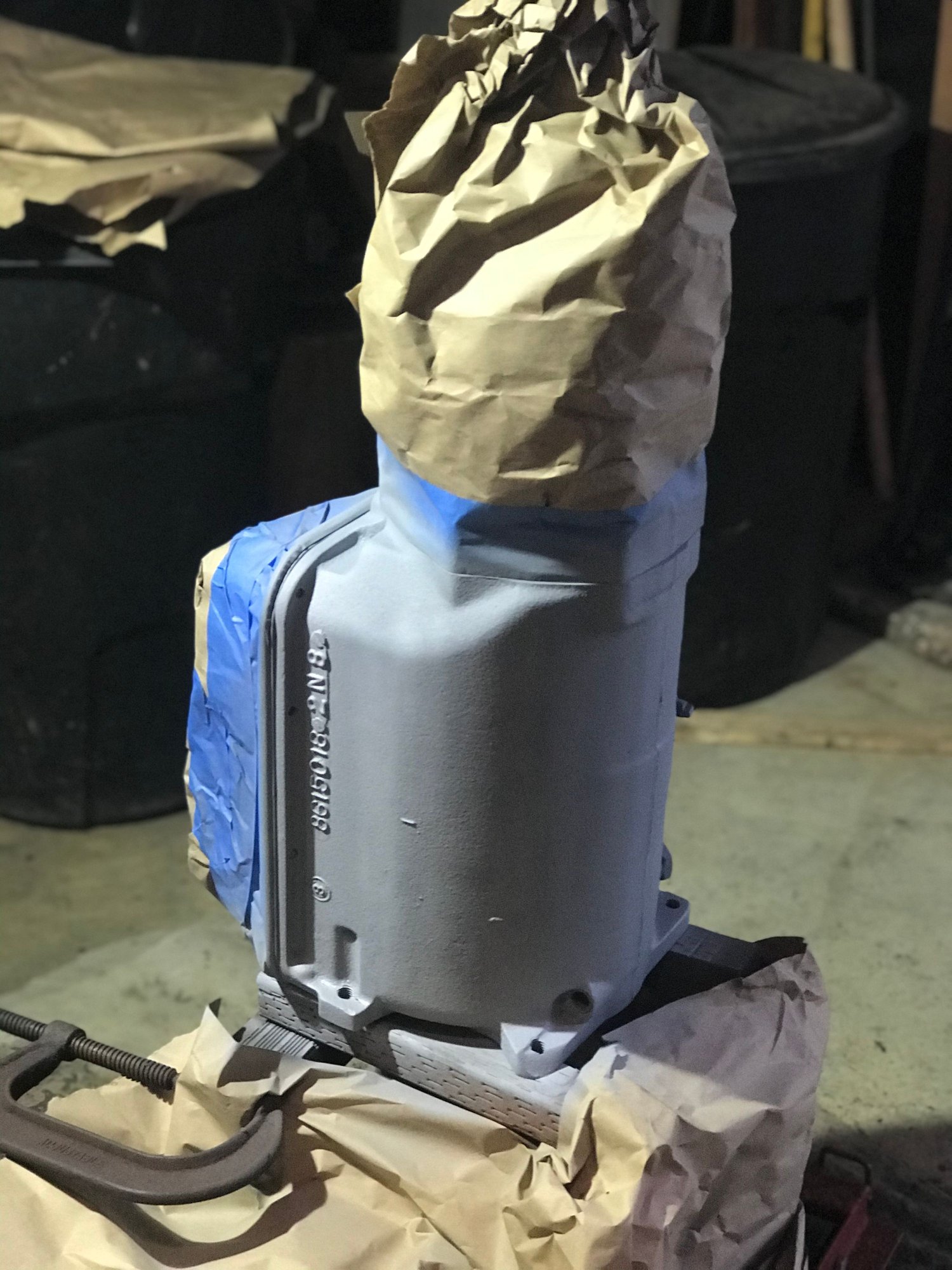

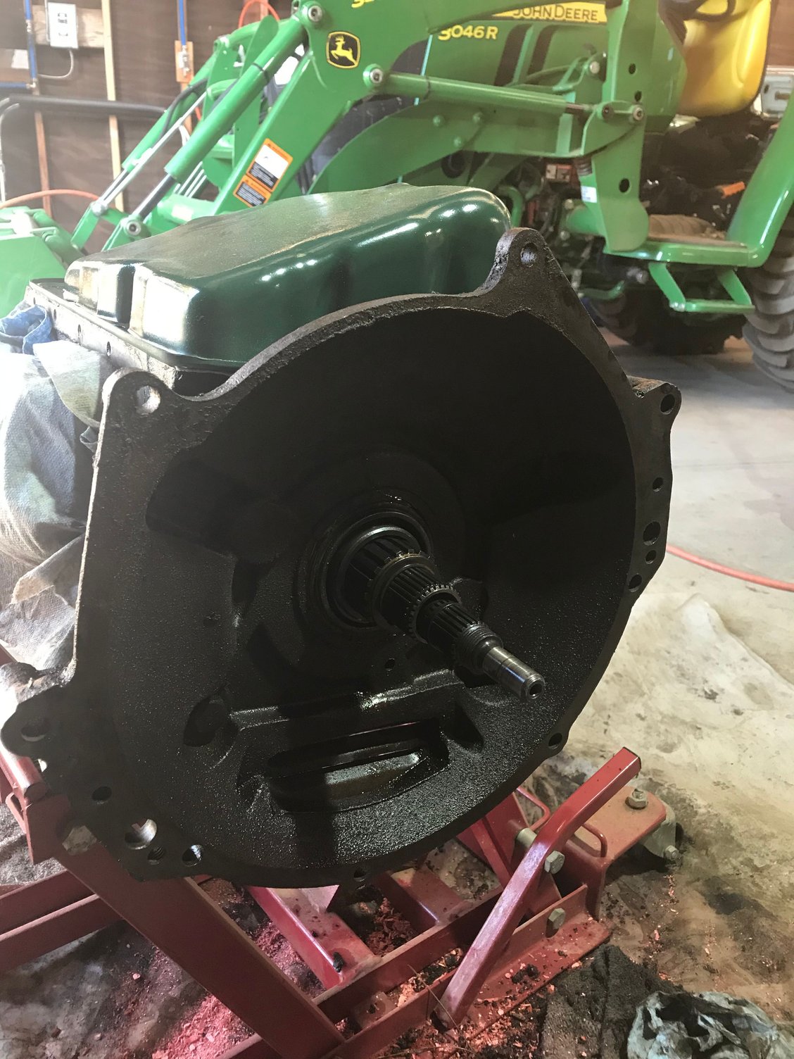

Ready to mate to the motor....

Looks really good Don. Don't pinch your fingers mating them together.

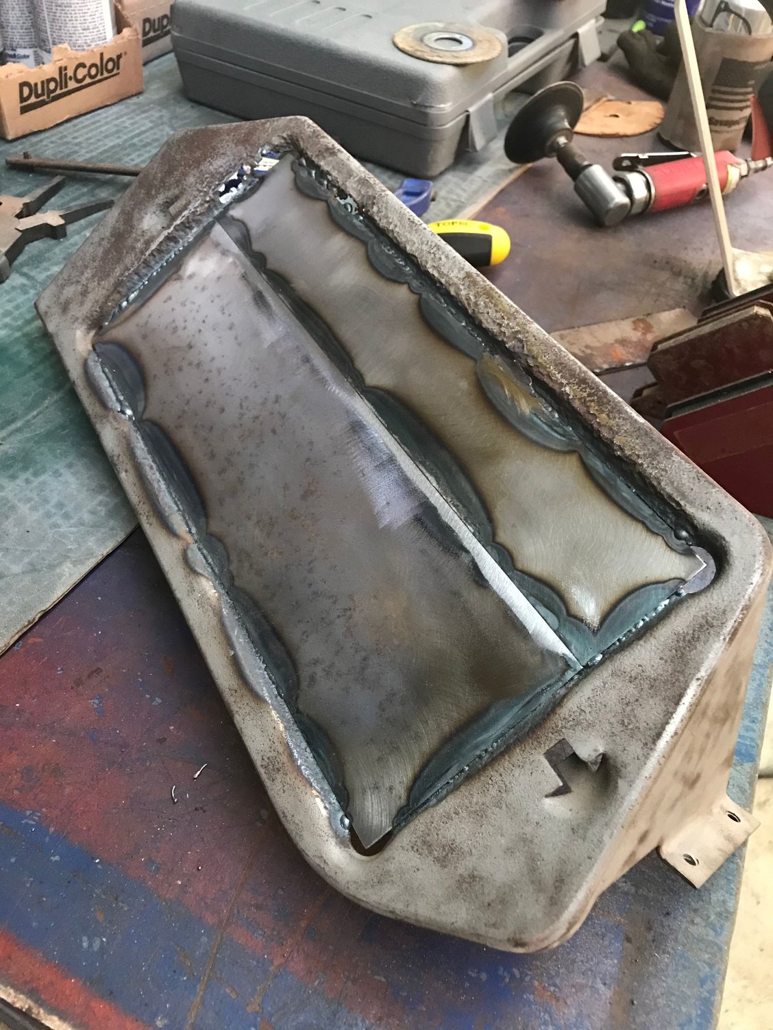

Been slow progress with all the craziness going on in our Nation! Hope all of you are safe and well?
Been trying to focus on the engine bay prep, so much crap from all these years in there.

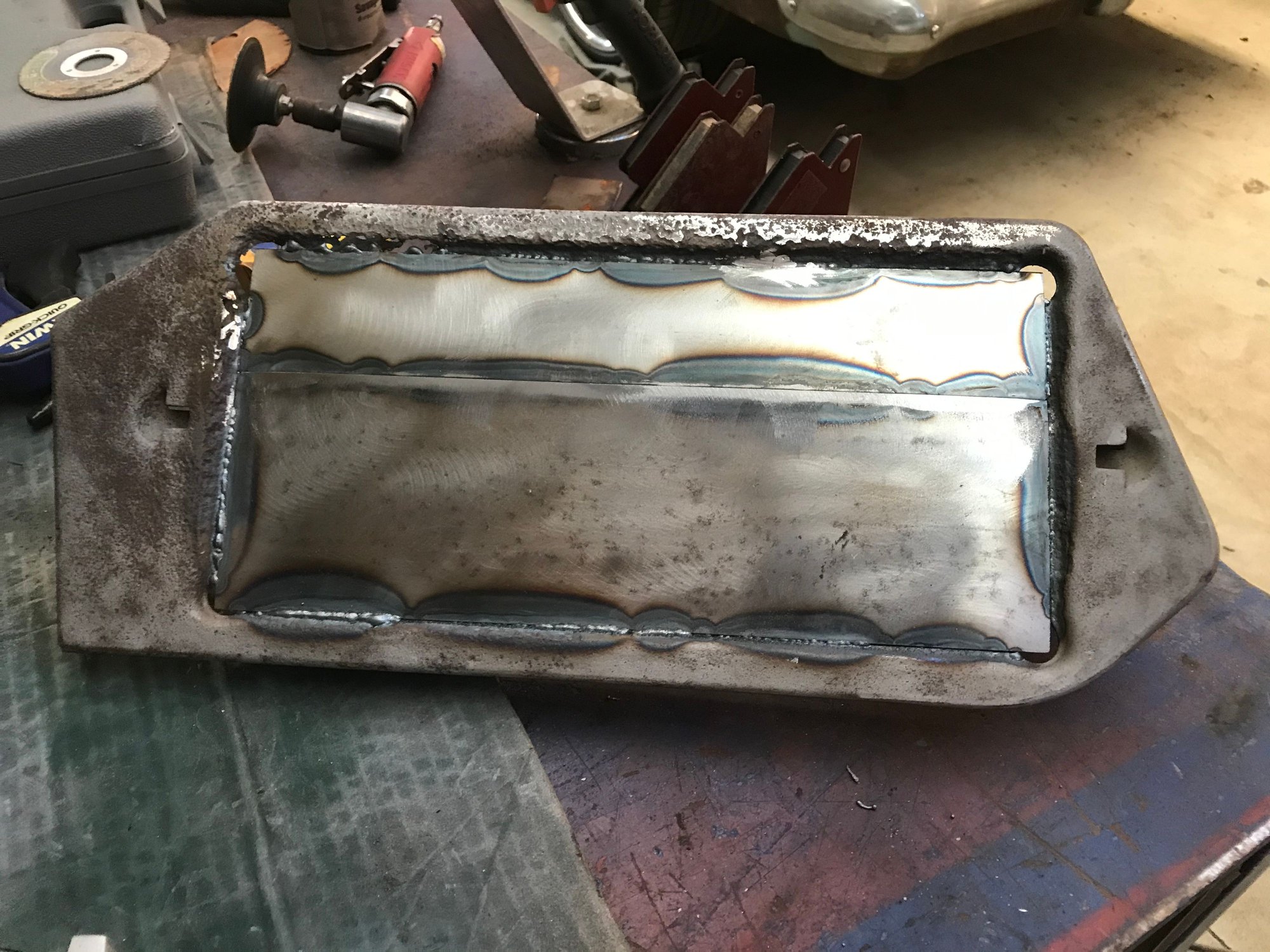

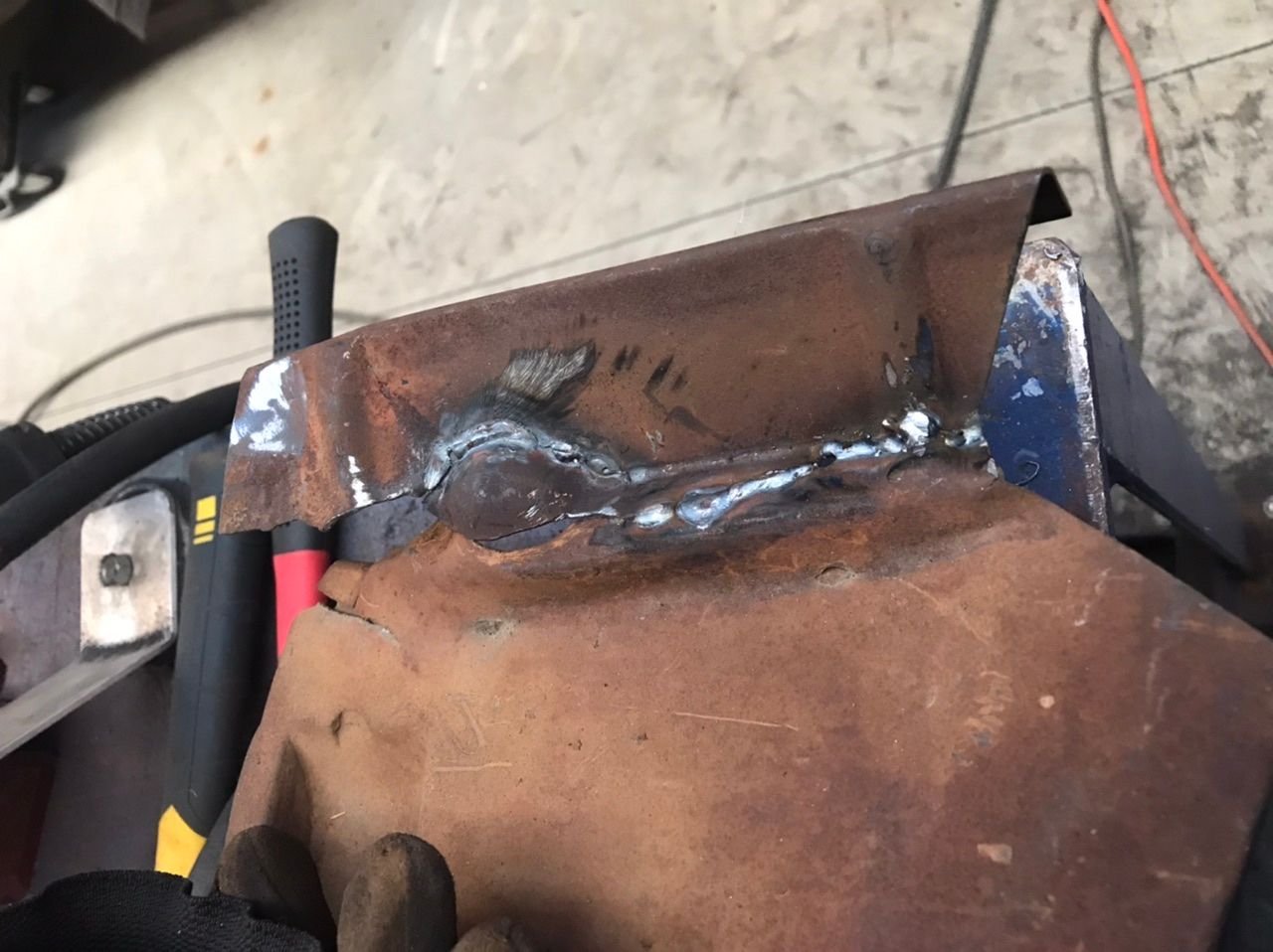

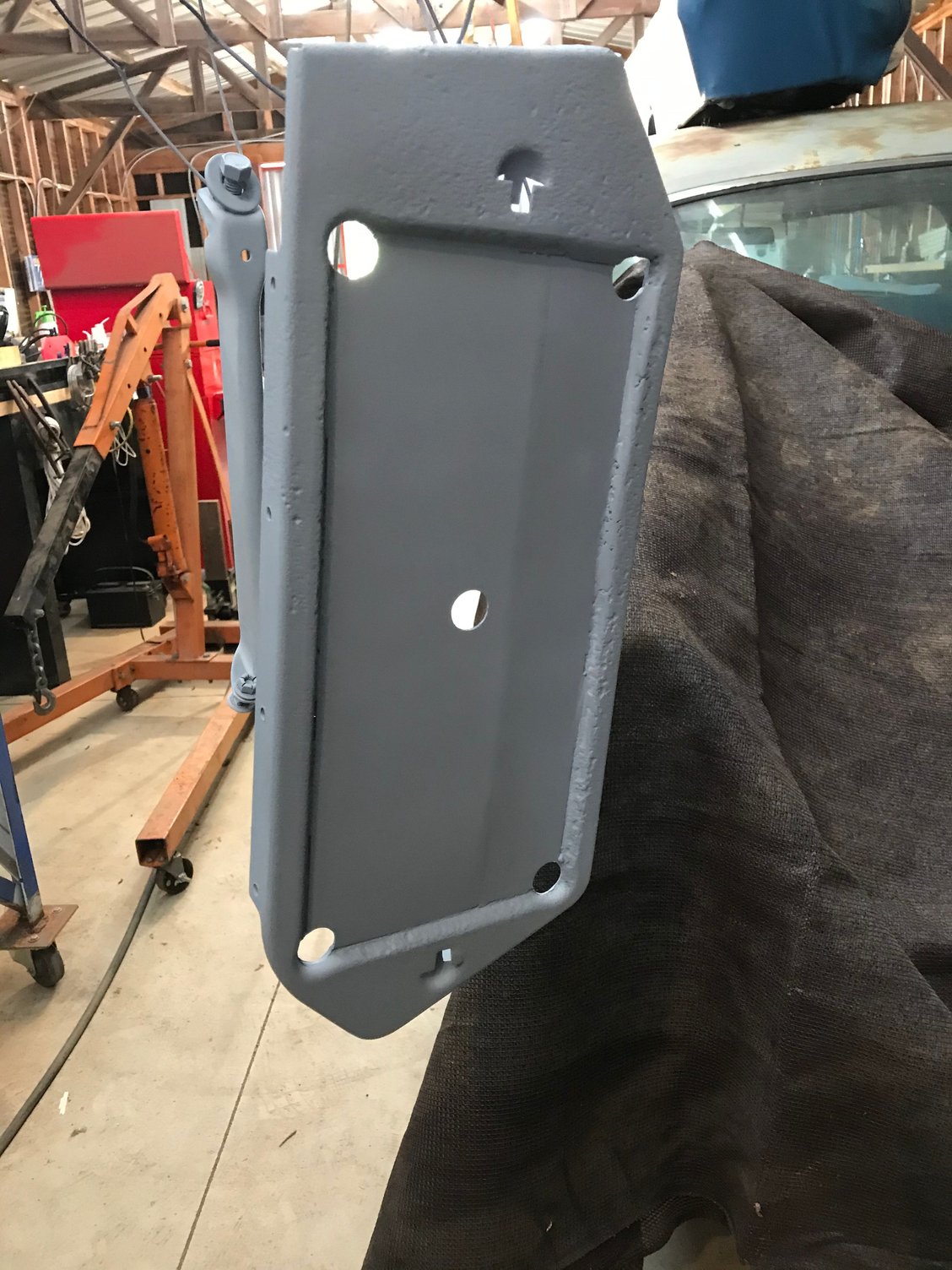

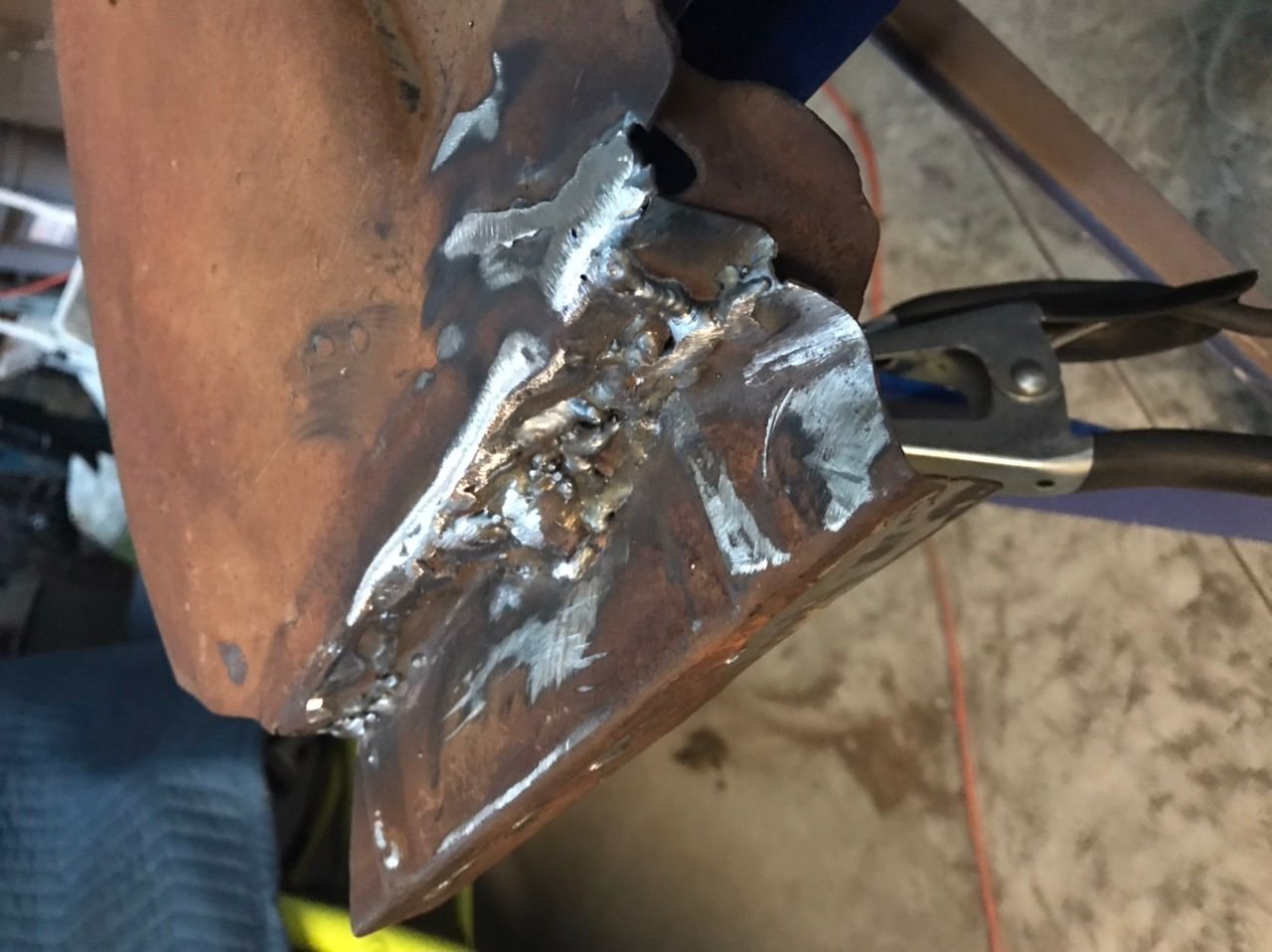

The battery tray needed a new base so I fabricated a fix.
Some of the thin areas blew through in the weld but managed to patch those to make it work.
Should have no problem holding a battery now?

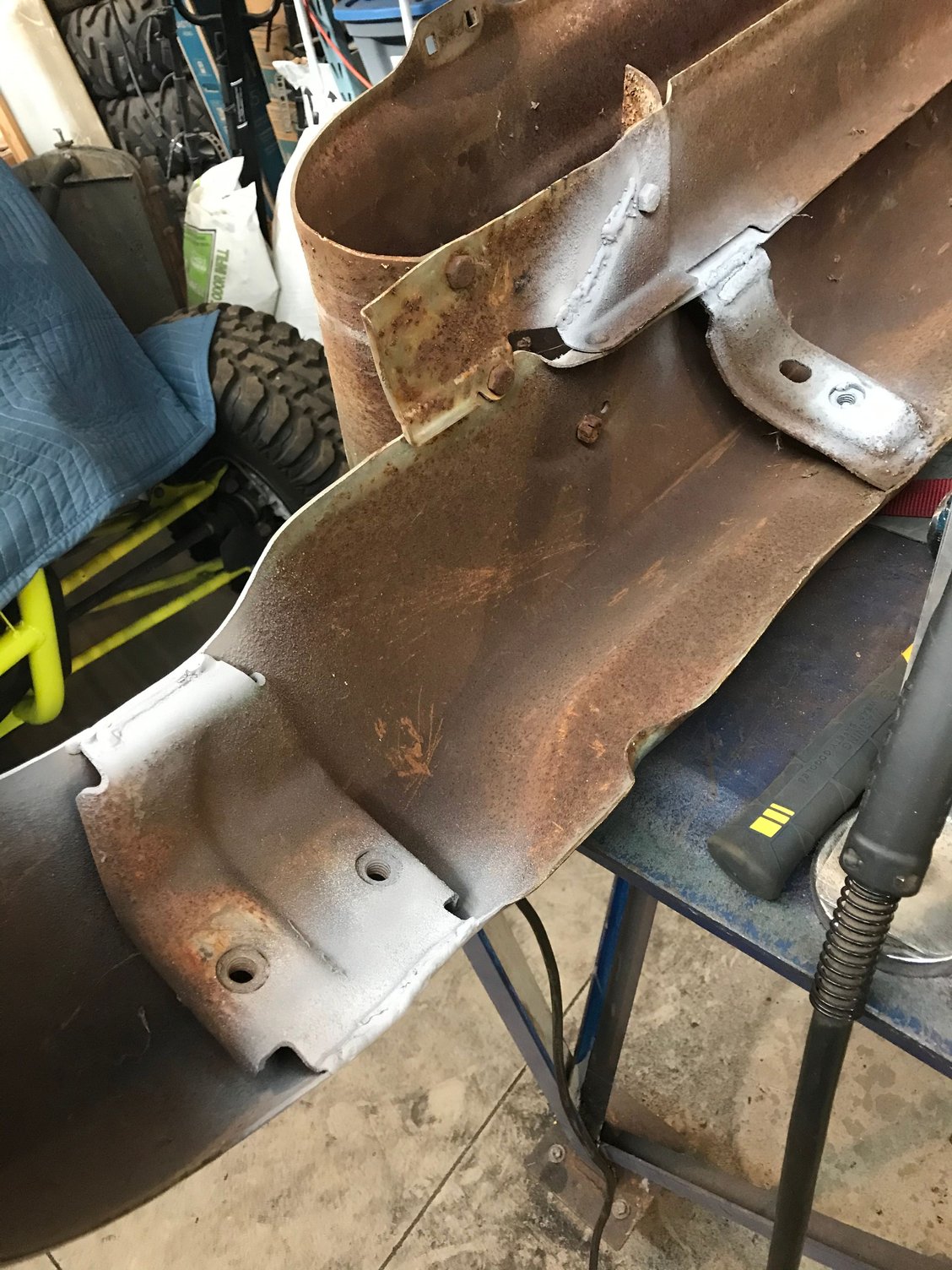

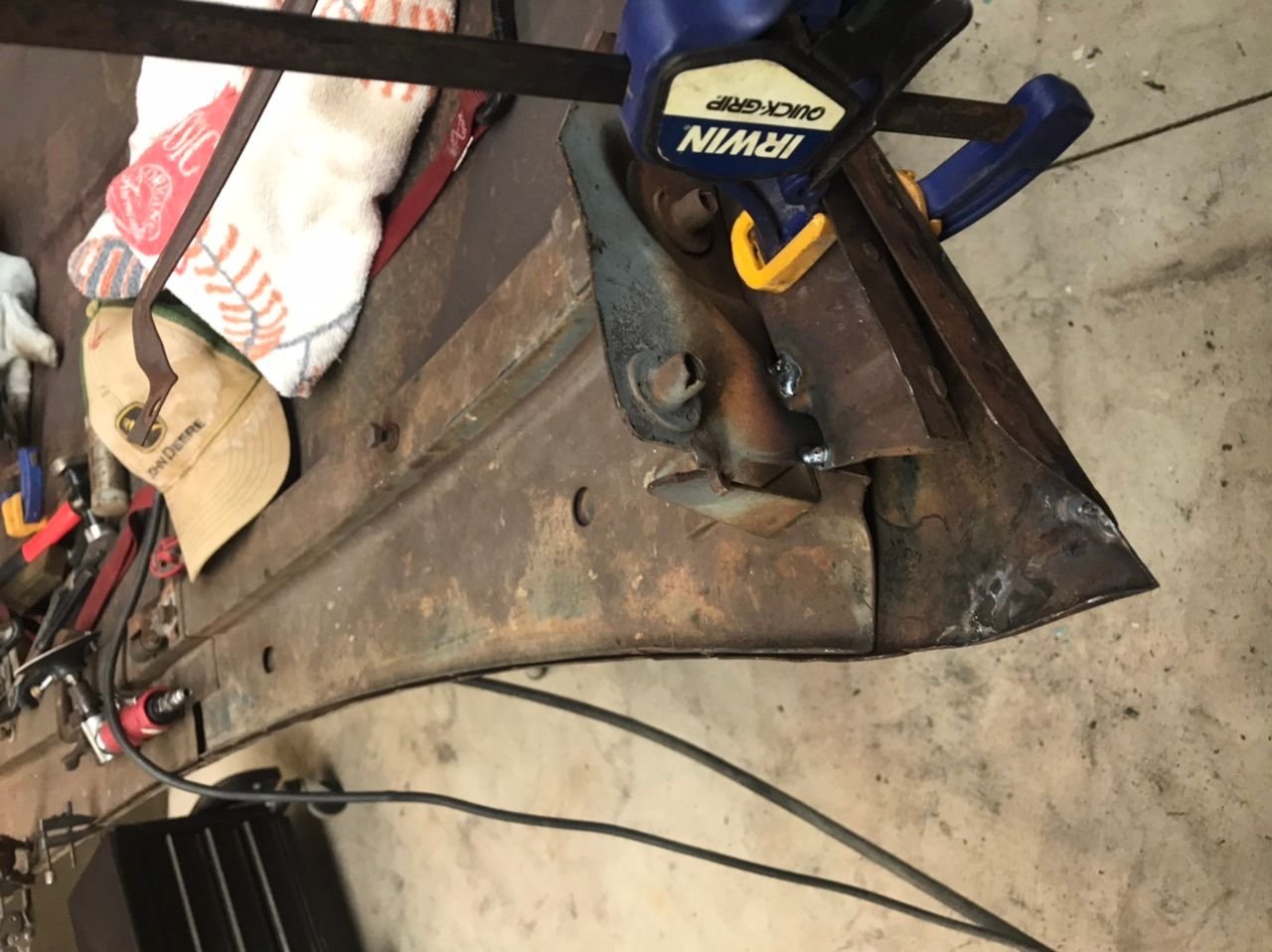

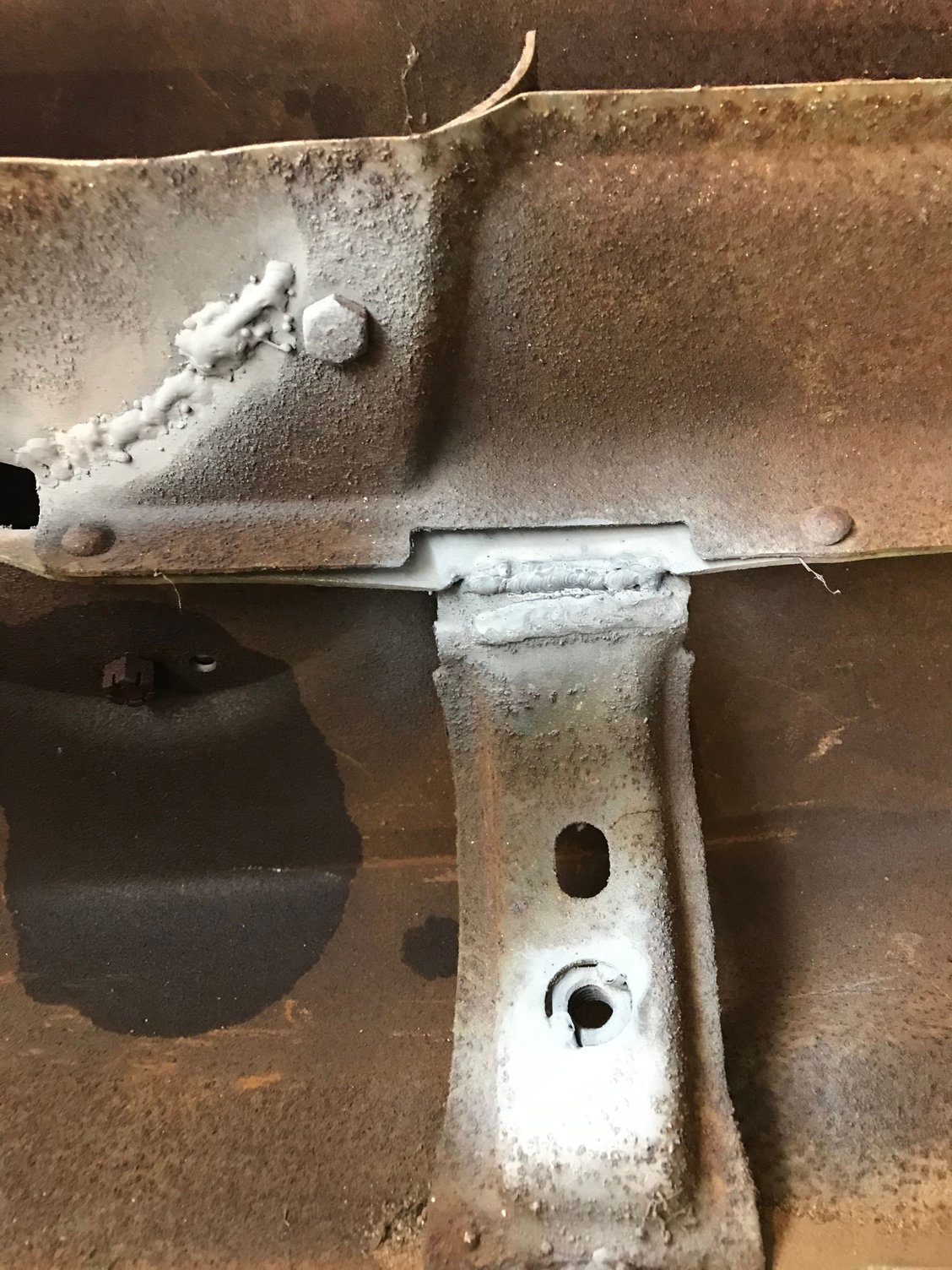

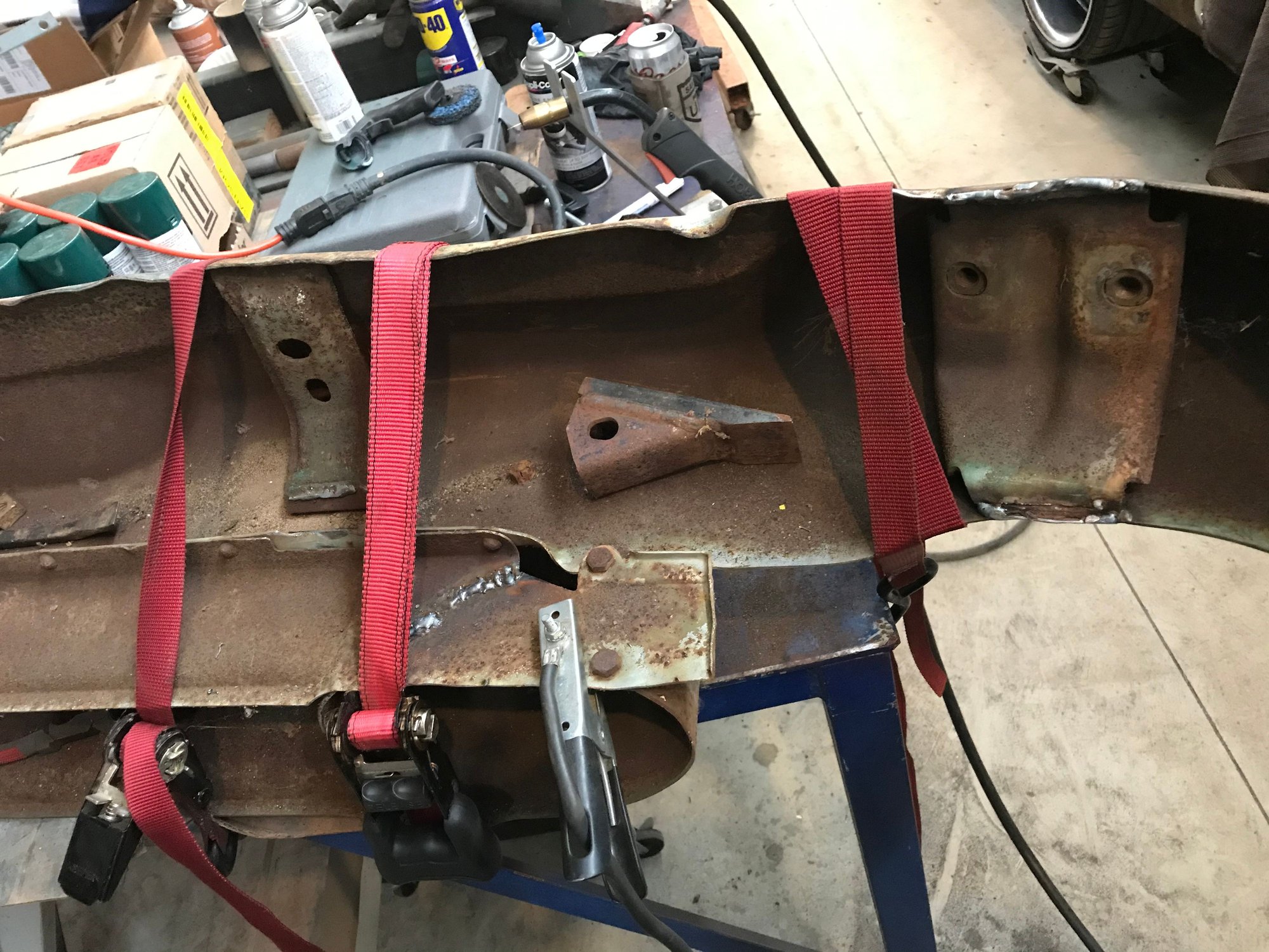

While I had the welding going I decided to do some fixes to the front bumper...

You are making way better progress than me Don. Keep at it. That battery box looks great.

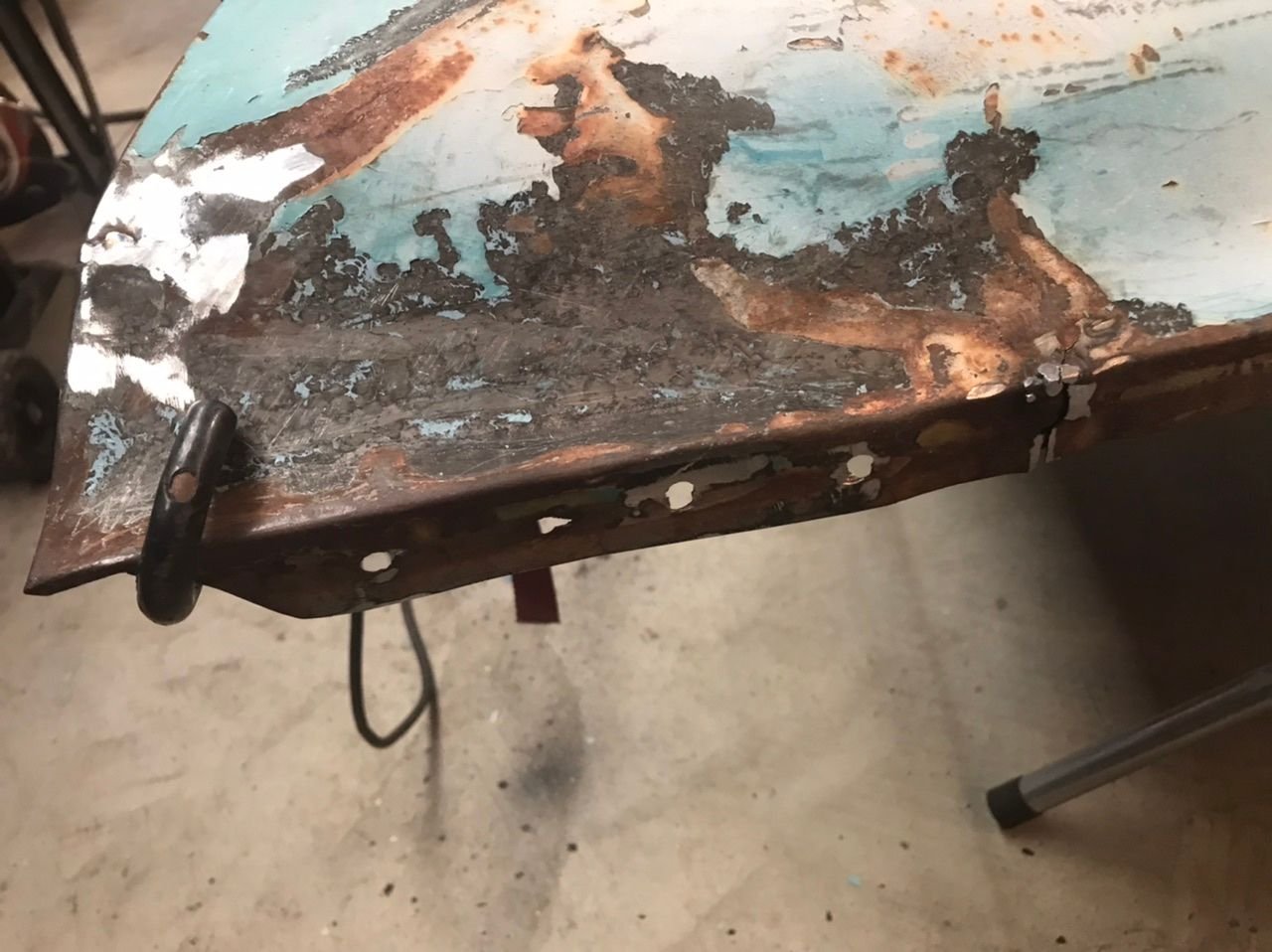

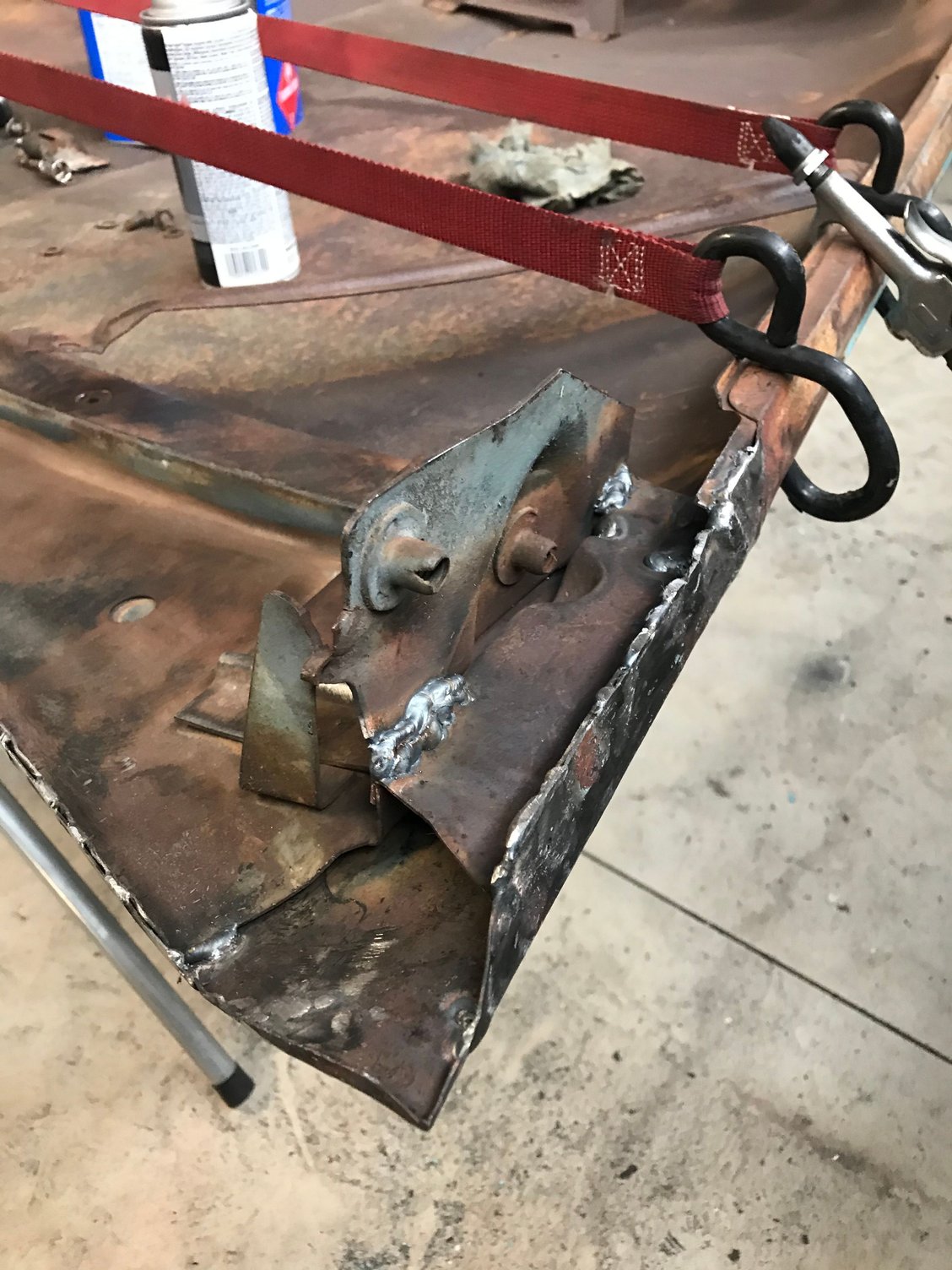

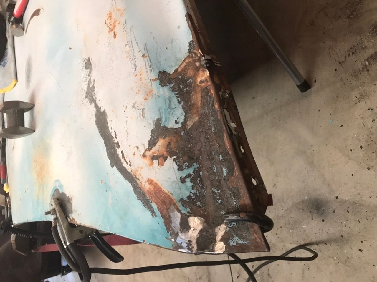

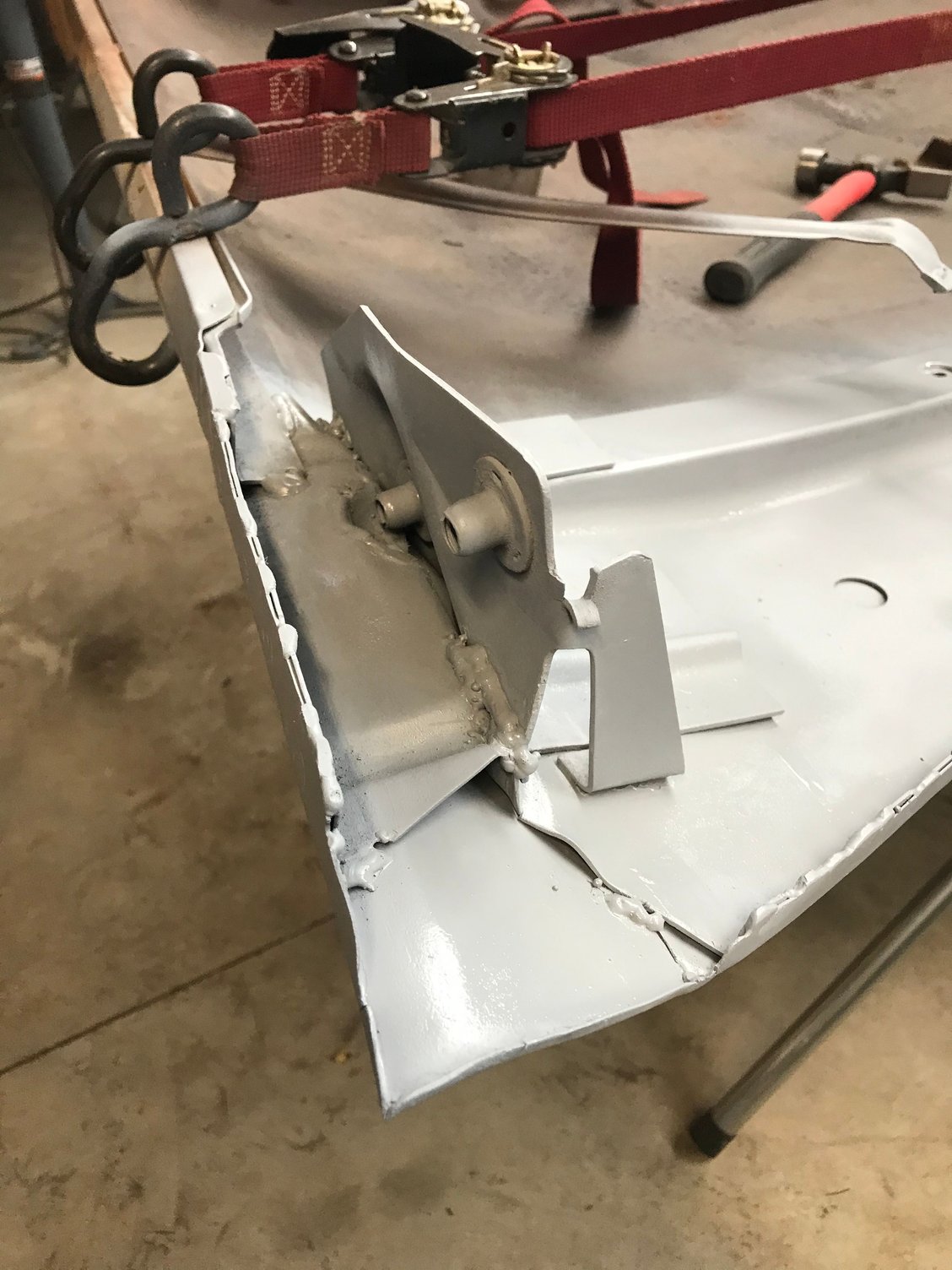

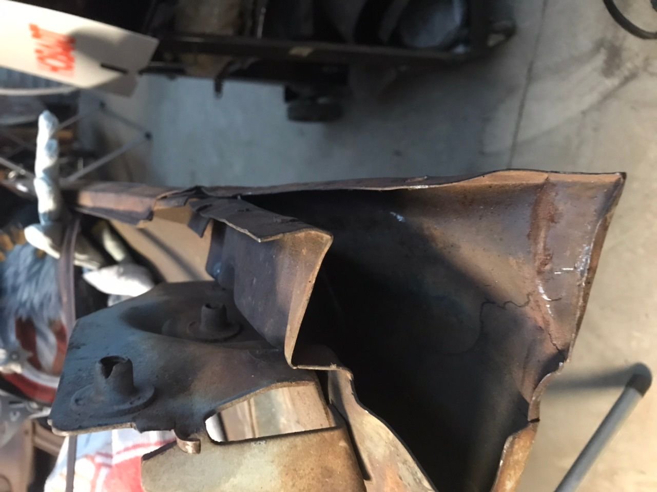

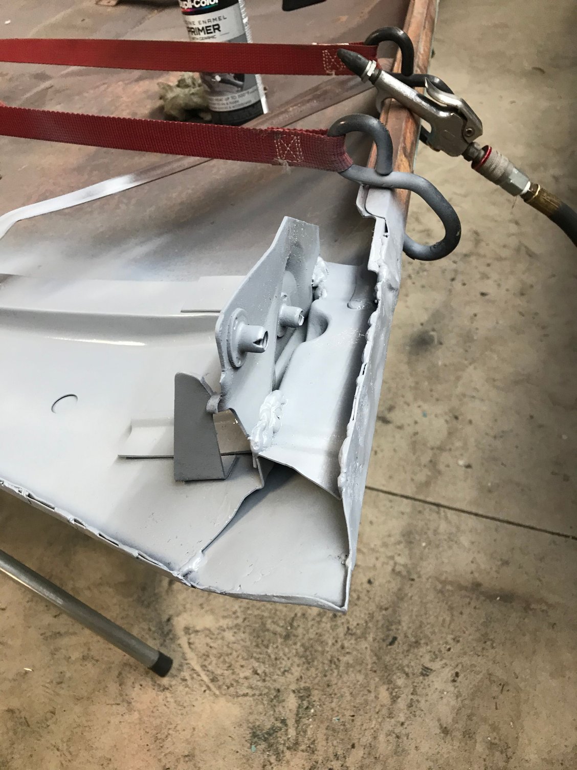

Here we go with some major hood mangle repair! Wish me luck that all goes well with being flush with the body?

...that engine is clean inside compared to others I've worked on...
Crankcase ventilation had most to do with it. After PCV was introduced, residue had less of a chance to settle on its surroundings

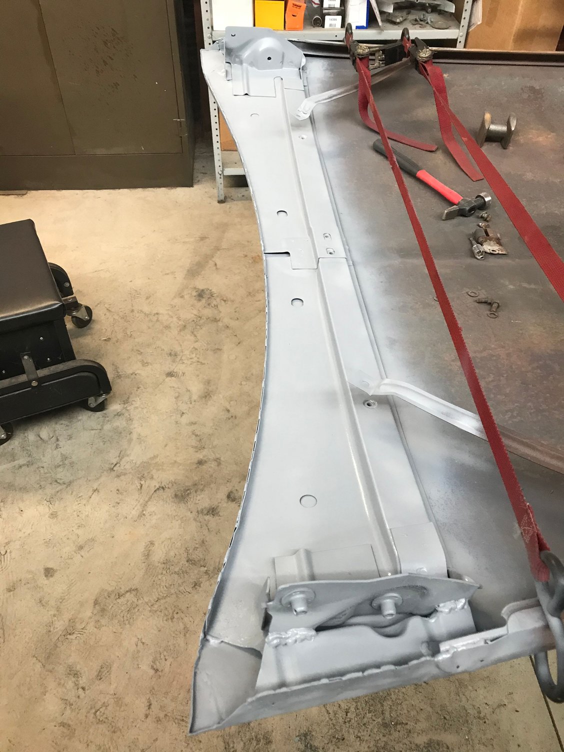

Turned out pretty good, now to see how it mates up to the deck and fenders? 🤷🏻‍♂️

Looks good, I’m in the same boat as far as hood repairs go. I’m following along with your progress.
Old Jun 14, 2020 | 09:38 AM
  #68
Gofishgobig's Avatar
Posts: 79
From: Southern Ca
Thanks, I think at some point the hood unlatched and flew open based on the damage I see? 🤷🏻‍♂️
