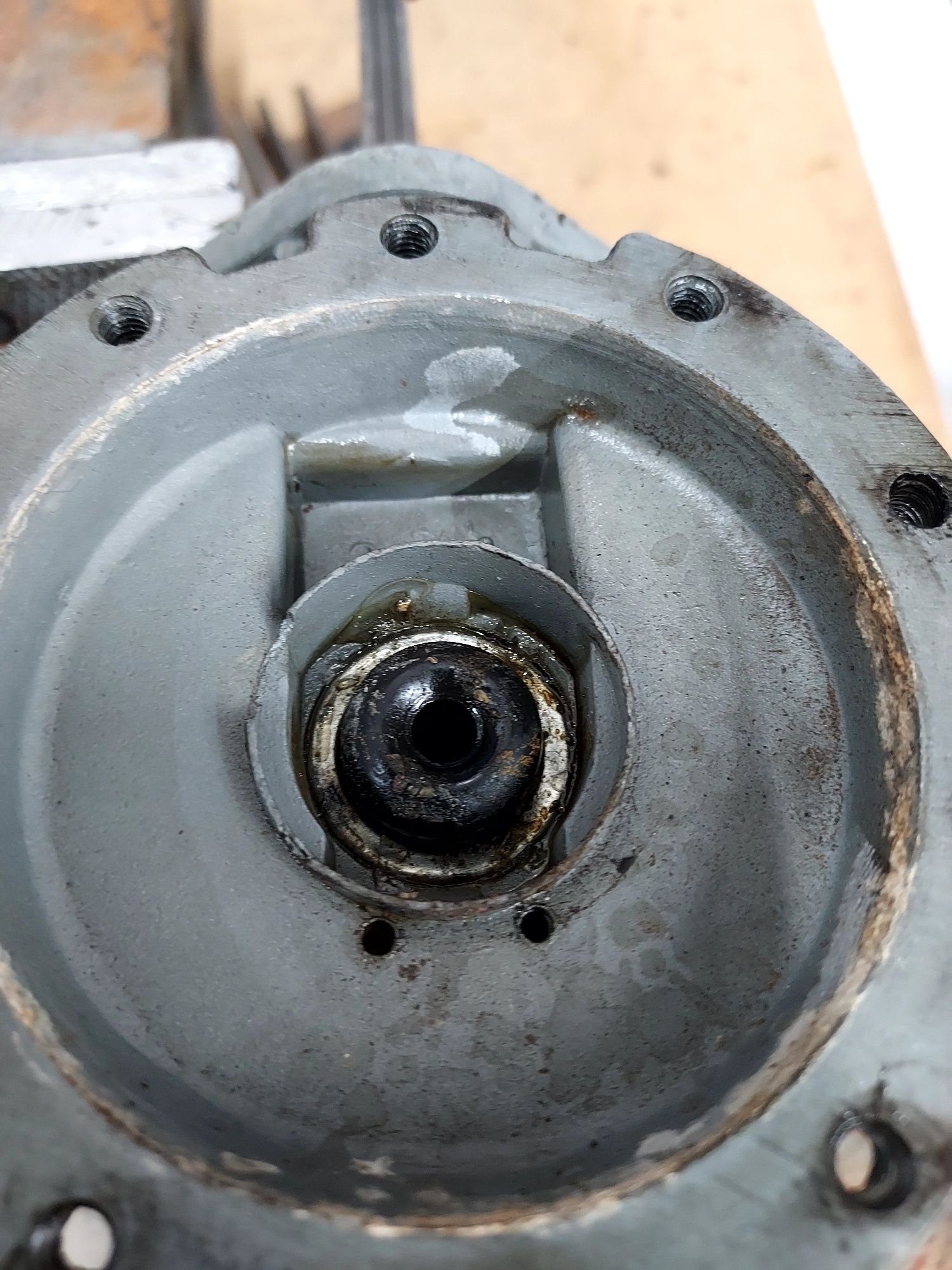

Pump has been into before. Screw heads show signs so not sure if it happened then or in use.
Is it fubar or will it be ok?
The whole lip is nicked up so I don't think it seals to anything.

This is before I removed seal. Just evidence I didn't do it.😁

To answer my question it appears the chip in the casting will not be an issue.
I've got vacuum on vac side and suction on fuel side
Old Aug 8, 2024 | 06:16 AM
Posts: 26,056
Mike - I think you're likely correct about this. It appears the circular lip functions as a guide to secure whatever it is which slides/goes into the orifice itself - more or less evident by the numerous chips on that lip already from many removal & re-installations. Likely the "lip" plays no part in the actual sealing but instead acts as a holder. Good luck.

There is a spring that goes in there but it is much narrower than the ring. Only other thing I was thinking is a bump stop for the diagram ring as that seems to be the only thing that may touch it. 🤷‍♂️
It definitely doesn't seal anything.

A closeup view of the sectional view of the pump from the book Fig 8-68 shows that feature piece's function is to keep the spring of the fuel diaphragm from walking inside the housing. A small piece missing should not effect it.

the spring in my pump sits in and below that lip nothing like that picture where it sits around the lip. That's why I was a bit confused.
This pumps been worked on before so who knows what they put in there.
