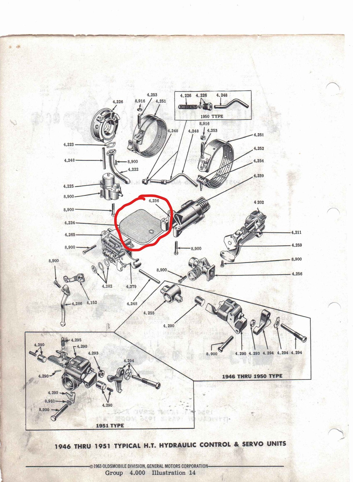

Did you clean the oil pickup screen circled in the pic below?
Cleaning everything up, and a fluid change may solve your problem.
If not, a band adjustment may be in order.
The procedure will be in the shop manual or the Hydra-Matic manual.

When I dropped the bottom pan the screen was quite clean. It has some particles on it but not enough to affect the operation of the transmission.
I have completely torn down, cleaned and reassembled the manifold. I did not find any evidence of a problem.
It appears the problem is either in the adjustment of a band or a worn clutch.
If what I've done does not cure the problem it will most likely require removing the transmission in order to rebuild it.
