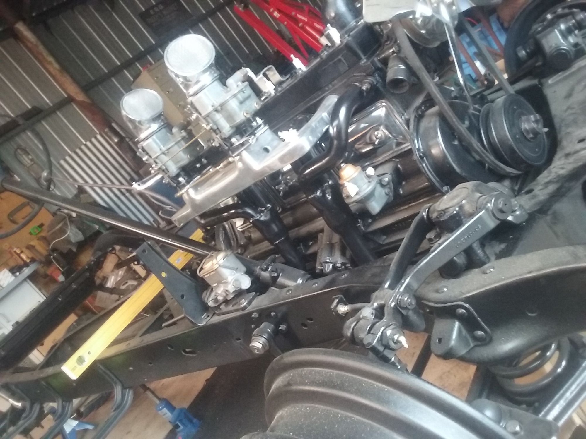

Your sloper looks like you are putting in a big effort to restore. That inlet manifold looks impressive. Can I ask a few questions about your car? What brake master cylinder are you using? Are you keeping the wooden frame? My doors sag a bit on the wood. Did you rebuild your shockers - my rear ones are leaking - I read somewhere that a place in Heidelberg might rebuild them, but I don’t have a name.

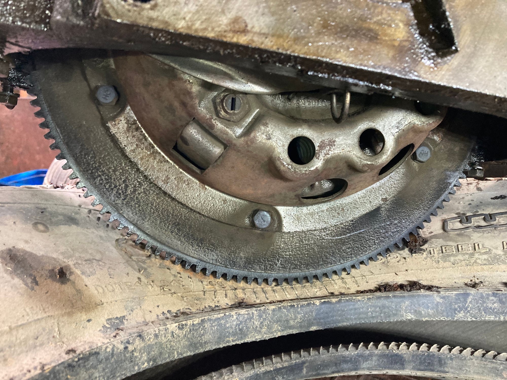

Does anybody have a suggestion about removing the bell housing. The dowels are rust free and not interfering.
. But I am not sure what pressure to apply to the bell housing in case it breaks😳😳😳.
I have given it a few good whacks with a rubber mallet - it’s teasing me, but not really moving too much.
any advice appreciated

Are you sure that all the bellhousing bolts have been removed ?
Especially the ones I have circled in the photo .
You will probably have to remove the flywheel to access them .

Thank you for both the response and information. No I didn’t know that those bolts were there.
So, if I am to remove the flywheel, I would need to remove the pressure plate and clutch.
Current view
Clutch fork

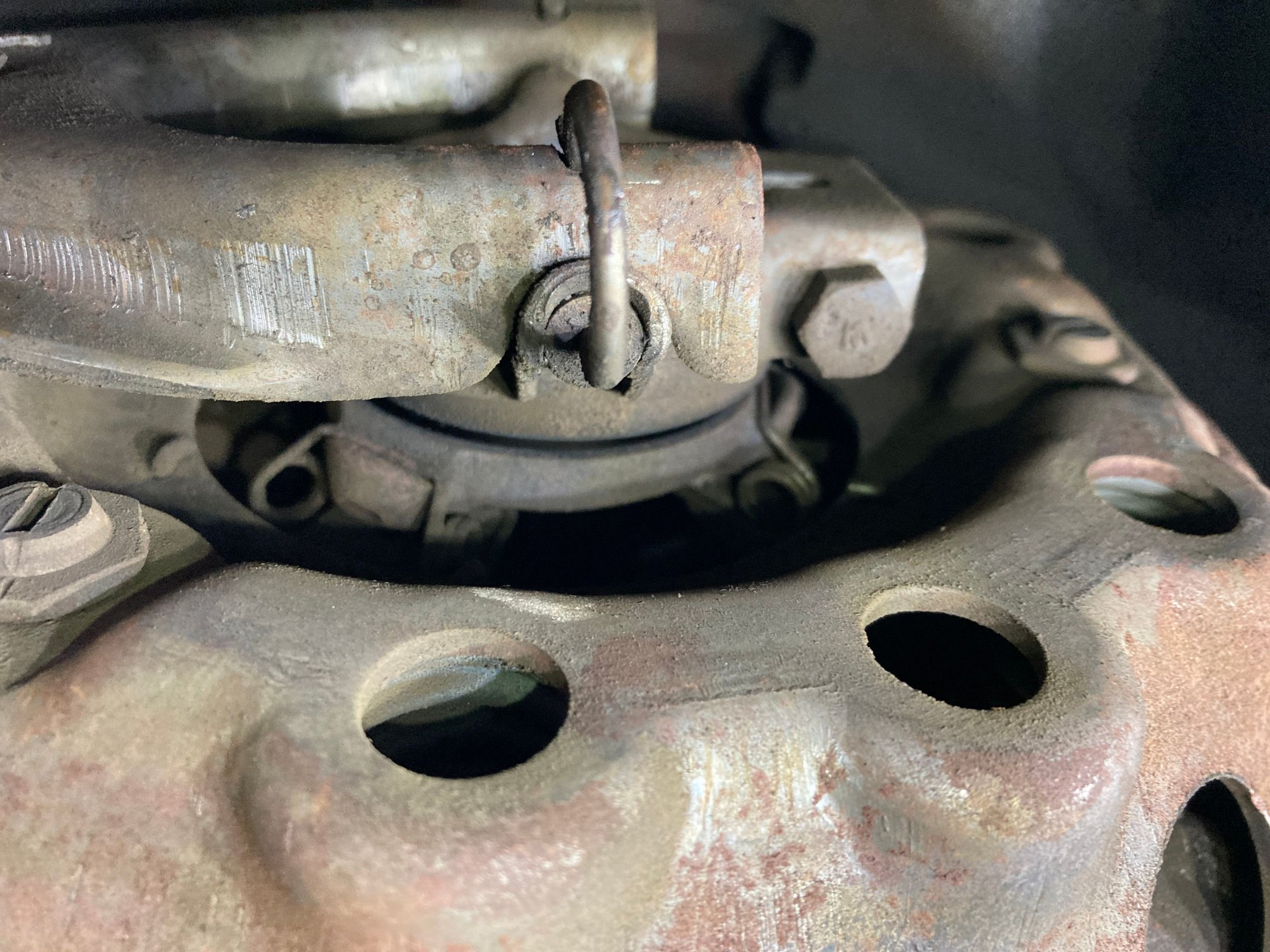

do I need to remove this bolt to remove the clutch fork? Then remove the pressure plate and clutch?

You should have enough end play in the clutch fork for the pressure plate to "fall out". The flywheel can then be removed.
In my instance, the motor was seized, so rotation of the crank to access these bolts was not an option....pistons out through the bottom when the time came I think???
I had enough play between the bellhousing and the block to be able to cut the dowels using a very thin angry grinder disc....allowing the bellhousing to be lifted upwards.
