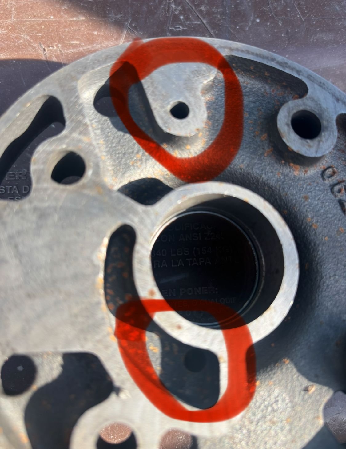

This is the govenor support. The circled holes are the supply and signal passages.
This is the support, with the gasket on it. No holes.

I had an unopened gasket kit from Hughes, the governor support does t have those holes either.
If the gasket company doesn’t want to include the holes, that’s fine, just say something. I’m guessing the vast majority of Powerglide gasket kits sold today are being used in race cars that don’t use governors. But it would t be a bad idea to include some literature explaining the holes need to be added for an automatic shift application.
