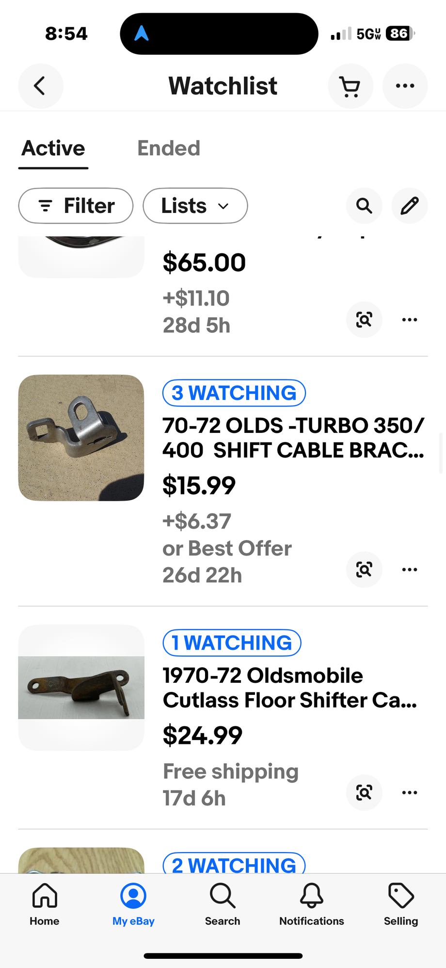

Hey All, when changing from a column shift to a floor shift obviously I need the shifter the console and the two brackets? Or just one bracket down by the Trans.
I don’t want to have the car pot lol so I’m trying to get all the parts first and then go with it.
I might’ve mentioned this before, but the hardest part for me is figuring out the neutral safety and reverse lights. I’m not quite sure about the 7172 column. Everybody says to go with that one because it’s on the Shifter or something like that I don’t know it’s all good. I can start it up and driving drive the car anyway if it’s down for a couple of days to order another part ha ha
Or is the one bracket that is there the same as the floor shift bracket and you just need the one that holds the cable?
