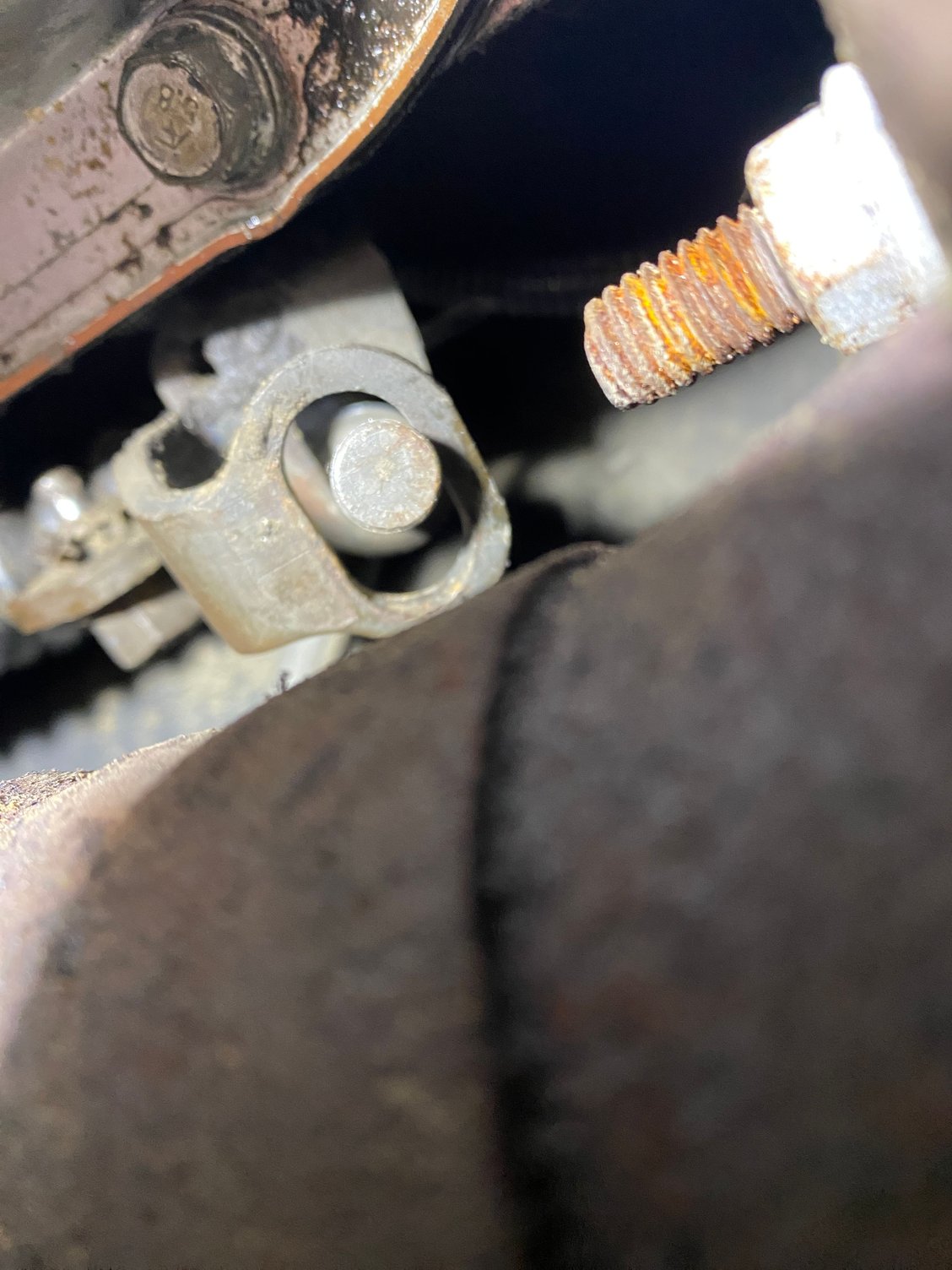

I have a 1984 Hurst Olds with a TH200-4R transmission, and was cleaning up around the shift linkage. I noticed one of the bushings was missing, and the other one was broken and fell out. Would anyone have an exploded view and or part numbers?

There are no bushings for that part. It's assembled correctly.

Interesting, I was sure something that looked like part of a bushing was in there, but then the entire area was caked in greasy mud and fine stone. Thanks

Some cars did use those bushings, I’m almost positive the G body cars did not.
Look at the linkage, the shift rod is already a tight fit in the transmission bracket. There appears to be no room for a bushing.

I noticed it was not the loosest fit, which suggests you may be correct that the bushings will not fit in. I will keep on looking and asking around. Thanks

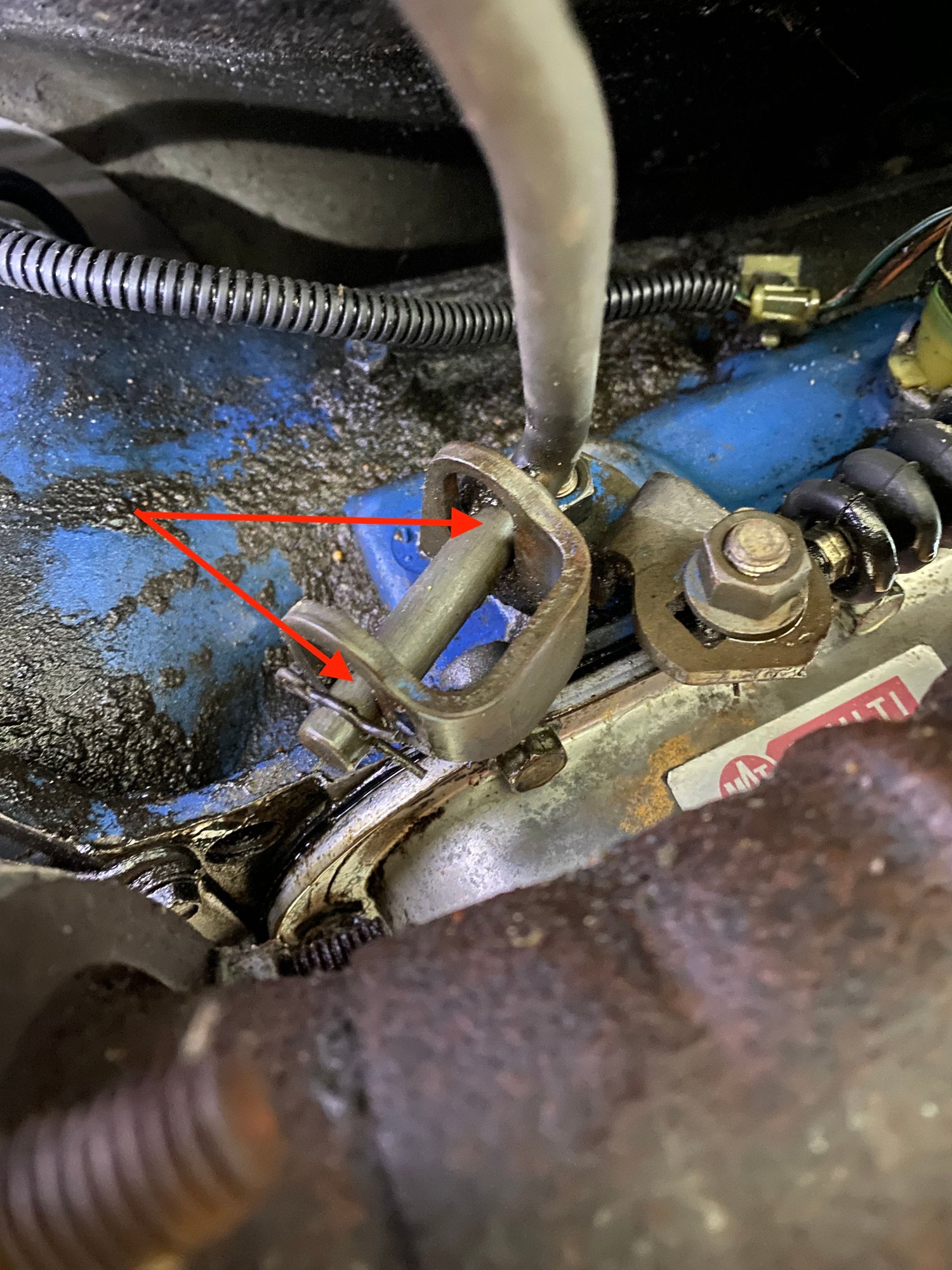

I've returned to the shift linkage issues I'm experiencing, and I can confirm that the slop in the linkage is significantly more than I initially realized, as shown in the picture.

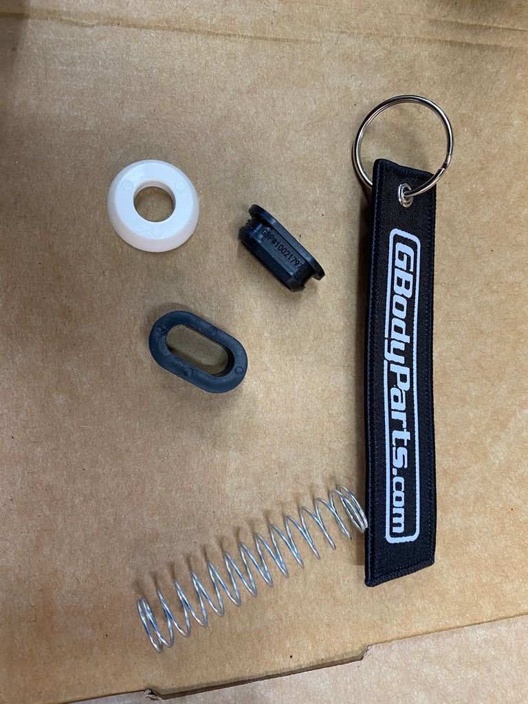

I went ahead a ordered a bushing/spring kit from GBody Parts, and the rod is a nice, snug fit in the slotted linkage. The round original bushing was also very worn and elongated, so the new white bushing will also help.
