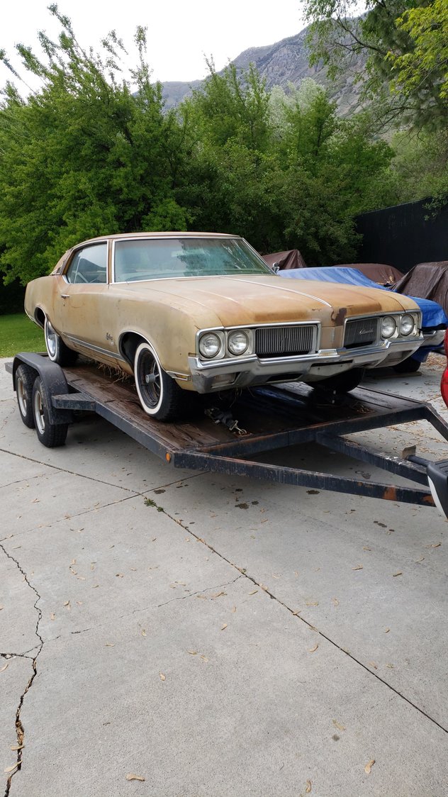

I have a 1970 cutlass supreme 455 SX that has been sitting for 10 years. When I bought it I was told it had trans problems.
Yesterday I got it running and the car would not move when in gear. I checked fluid and it was on the stick when not running but when I checked it running it wasn't on the stick. I ended up adding 5 quarts.
Once I did that, I started it again and the engine won't rev up when in park It is like I have it in gear and am trying to powerjack the car for a launch by holding down the brake and stepping on the gas.. The engine seems to be dragging down do to the trans. The car still won't move when I put it in gear.
Any Ideas? I am at a loss.
Thanks.
Tim

Don't know why it put the pictures on top?
