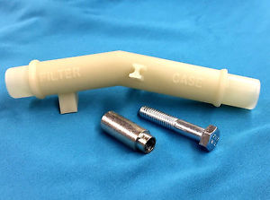

I’m replacing a chrome trans pan that will not seal with this deep aluminum one I picked up the only filter they had at the store was the power torque shown. I was told I should get a screen type filter and not paper the th 400 has a little stall and 3:90 gears .
That filter will be fine, but with the deep pan you should use a longer pickup tube. Otherwise, the extra fluid in the bottom of the pan is worthless because the filter can't reach it.
You can find the longer tube at most aftermarket sources. New ones also come with the necessary longer bolt and spacer for the filter.

Thanks joe it did co e with one and a longer mounting boss too
